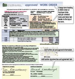

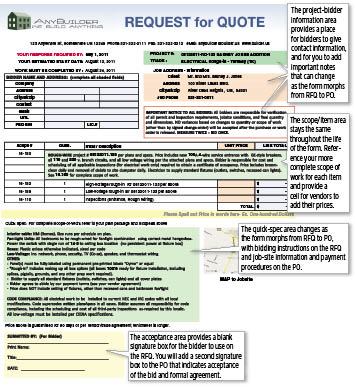

A purchase order or work order begins as a "request for quote" form. The RFQ shown here, for electrical work on an addition, is ready to fax or email to subcontractors for bid pricing.

Request for quote. The next three steps in the process all use the same basic form, which will save you considerable time and effort down the road. The simple form shown – the request for quote, or RFQ — morphs into a PO (or WO) with just a few simple changes and no redundant data entry
For each cost category you intend to sub out or purchase from a vendor, you’ll send out an RFQ that lists each of the items you want that particular vendor to price. This can be as simple as a lump sum – “Supply and install all rough and finished plumbing per the plans and scope of work” – or as detailed as a line-item bill-of-materials you provide to a lumberyard to price.
Signed vendor estimates. Subs and suppliers add their prices to the RFQ you’ve sent them, sign the bottom, and return it to you via fax or e-mail. If you’ve sent RFQs to multiple vendors, they’ll all be pricing exactly the same thing. If you’ve done your homework and provided an adequate scope of work, the bids will be apples to apples, and the price provided should get that phase of the project built with no surprises (variances).

Once you’ve reviewed the signed RFQs returned from your vendors and subcontractors, you’ll decide who you want to hire to do the work (or buy materials from). This is called “buy-out.” To buy out your job, you’ll convert the estimates on the RFQs received from each vendor into a PO (or WO) and send it back out to the winning vendor at the appropriate time, this time adding your signature and the job notes and other information we discussed in July’s column. Note that most of the PO form doesn’t change; you’re simply re-using the data entry from previous steps – the list of materials and labor you provided and the prices the subs and vendors returned to you.
