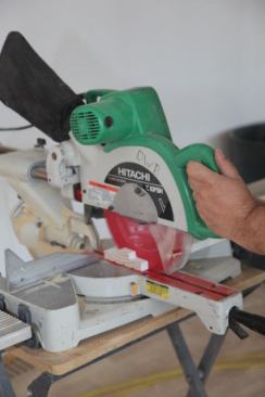

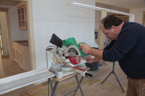

Most of JLC’s authors take their own photos. I’m hoping to share tips on how to make those photos more engaging and more informative. This week it’s a technique called zoom bracketing (see slideshow). “Bracketing “in photography is taking a series of the same picture, but changing some aspect of the photo such as exposure, or in this case, the zoom angle of the lens as you progress through the series. With zoom bracketing the first image is zoomed all the way back at a wide angle. The second image is zoomed in about half way for composition, and the third image is zoomed all the way in. In the first series, the wide angle shot shows the whole door jamb assembly, along with the saw and bench. The next shot is composed to show both the ends of jamb, but closer to the action of sawing. The third shot is zoomed in to really focus on the action of sawing. Each of these photos conveys slightly different information. If I want the photo to illustrate how the jamb is held on the bench, I choose #1, but if I want the photo to be more about slicing the leg of the jamb to length, I choose #2 or #3. Notice how the caption changes with each bracket.
