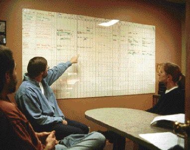

Once an individual job schedule is put together, we transfer it, in six-week increments, to the master job board in Kate’s office, which lists every job we’re on (see photo at beginning of article). The job board is simple: a gridded sheet of poster board, mounted to the wall under a clear, plexiglass panel that we can write on with dry-erase markers. Every two weeks, we change the dates and extend the schedule.
There are many useful aspects to the job board. First, because it’s mounted on the wall, anyone who wants to see what’s happening on any job, on any given day, can look at it and see how that job fits into the big picture. It also allows us to see any conflicts in our subcontractors’ schedules. We use a group of small contractors who have a limited capacity. With some of our larger subs, we request certain crews to work on our jobs, so it’s really important that we don’t overbook our subs. The schedule guards against this happening — we can quickly see if one of our drywall contractors is already booked for one project the same week we need them for another, or if the plumber is finishing a project the same day we need him to rough-in another one.
The board also helps us formulate new job schedules — we can see at a glance where we’re going to be during the next six weeks. We use a simple set of symbols on the board — subcontractors are written in colored ink, our staff is written in black. If a sub needs to be called, we place an open circle next to the name; when that person has been called and confirmed for that job and day, we put a checkmark in the circle. Anyone looking at the schedule on the board can glean a lot of information quickly. If anything changes, it’s as easy as wiping off the board and entering the new information.
