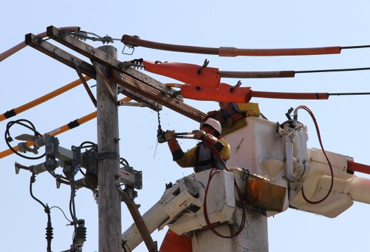

Utility workers maintain a power pole in Boston, Mass., in 2014. Power companies say homeowners with rooftop solar panels aren’t paying their full share of the operating cost of the power transmission grid, even though they often draw power from the system.

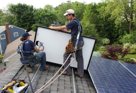

Technicians for Revision Energy install PV panels for a grid-tied system on a Portland, Maine, roof in 2014. A panel array this size might supply all the power a house needs on a net annual basis, but still requires a grid connection to balance surplus summer production against nighttime and winter power needs.
