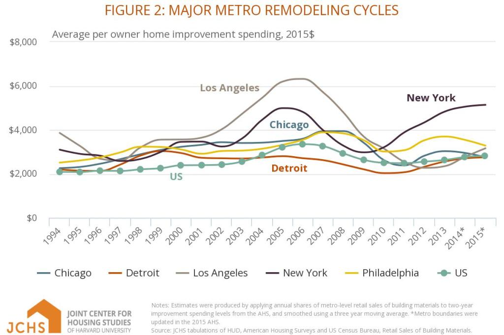

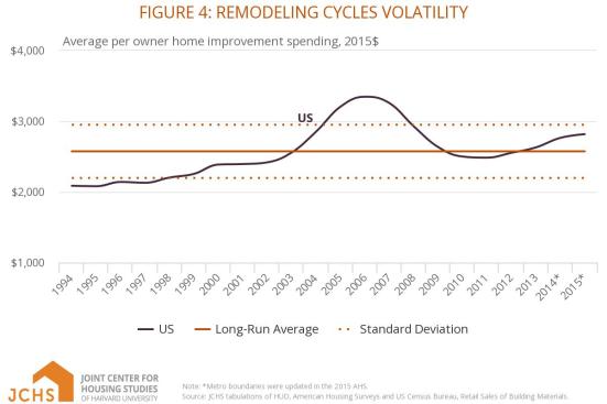

Harvard JCHS chart showing remodeling cycles volatility
JCHS chart
Nationally, on an inflation-adjusted basis using 2015 as the base, spending per owner on home improvement averaged about $2,600 each year between 1994 and 2015, JCHS said. Over those years, there was about a 26% percent swing from peak to trough. And while the five markets studied in detail also had their ups and downs, the force and timing of those cycles varied.
For instance, Los Angeles experienced a 64% peak-to-trough swing during that period, while Philadelphia far more stable with only a 23% change. The New York market has seen a 73% rise in remodeling spending from its low point, while in Chicago the change has been just 16%. And Detroit in 2015 was only 2% below its peak level while Los Angeles is 50% under its highwater mark.
In other words, JCHS concluded, Los Angeles and New York had relatively high volatility in remodeling spending, Chicago was moderate, and Detroit and Philadelphia experienced low volatility.
