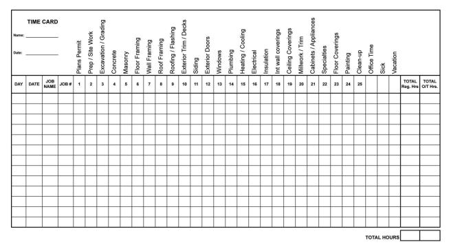

The second thing I learned as an estimator was that the existing estimating process had no link to our job histories; in fact, the job histories were prehistoric. This was a surprise to me because our system was loosely based on HomeTech’s Remodeling and Renovation Cost Estimator (the first estimating resource I ever saw that was tailored to small contractors), and one of the ideas we had embraced was its 25 phase categories or divisions. The management team had duly developed a timecard that listed all 25 divisions, plus a few more for office time, sick days, and vacation days.
When I was still in the field, I had religiously filled out my card each day, fully confident that this information was being used by someone in the office. So years later, when I started estimating, I assumed we had a vast treasure trove of data I could transfer into our new estimating process. To my dismay, this was not the case. I was told that very few carpenters filled out the form correctly, and even though some did, the data was too diluted to be useful.

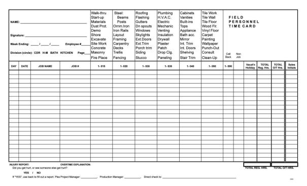

Undeterred, I moved forward, committed to the belief that labor was the most critical item in an estimate, because it was the hardest to forecast and had the biggest impact on the bottom line. I needed those labor histories, and I reasoned that the best way to get them was to redesign the timecard. It would have to be simple enough that carpenters would fill it out, but detailed enough to be useful to the estimator and the accountant.
The Silver Bullet
My solution, while unscientific, makes practical sense and has worked remarkably well for 20 years. I knew I had to reduce the work categories to the smallest possible number that would produce useful results. Inspiration came from an unusual source: my 1981 Honda hatchback (photo below). Because I couldn’t afford a nice big F-150, I had to work out of the car, which the older members of the crew mockingly dubbed the Silver Bullet. There was no way I could get every tool I owned into that hatchback, so I had to load it each day with the tools I would need for that day’s work. Certain tools would get me through project start-up, but when framing began, I needed a different blend of tools. The same was true for other phases — exterior finishes, trades (electric, hvac, plumbing, insulation, and drywall), finish carpentry, and finish surfaces and punch-out.
When I looked at the timecard problem this way — and thought through the different mind-sets that went along with each collection of tools — I realized I had found a way to reduce 25 work categories to just six that would fit almost any job. Even though I knew those six could have multiple subdivisions, experience told me that in small construction companies where the workers have to be generalists, there was nothing to be gained by making things more complicated.
That change was the first one I implemented when I took over the estimating system. It laid the foundation for the collection of accurate historical data that would feed a database that could consistently forecast the actual labor cost of any job. Workers in the field understood and could easily fill out the timecard; accounting could more easily and accurately input the reduced quantity of data into the accounting system; and project managers were even able to use reports to help improve productivity.
In order for job histories to be useful, they must be part of a process that is based on sound fundamentals, calculations, and data and is consistent from job to job and estimator to estimator. But having those histories is what makes the rest possible.
