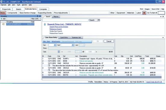

On a recent project, for example, we had to remove a portion of a 6-inch concrete slab that had been installed incorrectly by someone else. I called my concrete subcontractor and asked him to estimate the square-foot cost for labor and equipment to remove the slab and regrade the area to create positive drainage away from the house (we would provide the Dumpster). After his estimate came back at $3 per square foot, plus $250 for a Bobcat for the grading, I calculated his price for the job at $1,402 (384 square feet × $3 + $250). I then used XactRemodel to determine the value of the total scope of work to be performed.
According to XactRemodel, my cost to the customer for all the slab-related work (line items 2–6) would be $2,468.72. After the customer signed the contract, I called the subcontractor and told him we got the job. It was only then that he needed to visit the site and send me a quote. Though it came in slightly higher than his over-the-phone estimate, it was still within the price I had quoted to the customer.

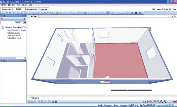

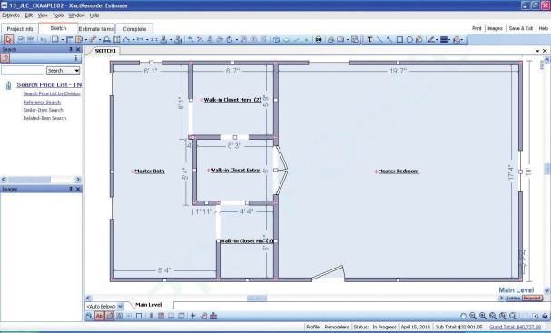

XactRemodel's features make it easy to produce and customize estimates for projects of any size and complexity. For example, the "Line Item Entry" tab enables the user to create a list of line items for the work that is to be performed, and to organize it either by phase or room by room. Quantities can be entered manually, or you can automate the process by using a set of drawing tools to create floor plans and elevations, even 3-D renderings. If you choose to start with a floor plan, XactRemodel will automatically calculate everything from the sketches, including perimeters, volumes, and floor, wall, and ceiling square footages.
I usually write a project's line-item scope of work in the order the tasks are to be performed. I imagine what needs to be done, from demolition through finish work, starting at the floor and working around the room and up to the ceiling. This gives me a systematic way to prepare a proposal. After I "build" each project in XactRemodel just as I would out in the field, the program provides me with a value for each and every aspect of that work.
Preparing an estimate this way does take some time, but it also allows me to think through every aspect of the project while I am putting together the proposal. In many cases, you can speed up the process by setting up a "macro," which is a kind of template for any scope of work you design. This means you can easily duplicate the scope of work from a previous project that is similar to the current one, and then add or delete line items as necessary.
