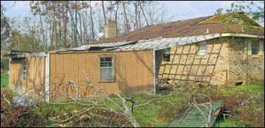

The weed-choked lawns, stagnant swimming pools, and vandals may not be the only problems with the rapidly rising number of foreclosed homes in Florida and other coastal states. Vacant homes are also likely to be more vulnerable during hurricanes and high-wind events, sustaining more damage and threatening neighboring homes with flying roof tiles, siding, or other debris.
So warns the Institute for Business and Home Safety, a Tampa-based advocacy group for disaster safety funded by the insurance industry. The group says the rising number of foreclosed homes in hurricane hot spots will lead to increased hurricane damage unless the homes are adequately prepared for storms.
“The issue is that people aren’t maintaining homes, and they are not thinking about protecting them,” says Tim Reinhold, vice president of engineering at IBHS. “If shutters don’t get put up and a storm is coming through, you have a greater potential for the house coming apart.”
About 1.1 million homes nationwide were in the process of foreclosure at the end of June, according to the Mortgage Bankers Association. Nearly half of those homes — just over 500,000 — were located in the coastal states extending from Texas to Maine, according to a May analysis for IBHS by RealtyTrac, an online marketplace that tracks foreclosures. With 189,623 foreclosures, Florida was the leader, followed by Texas (with 77,830) and Georgia (55,764).
Cities everywhere are already struggling with derelict properties, declining neighborhoods, and falling property values tied to foreclosures. But should a hurricane strike, these problems are likely to multiply, especially for cities with high numbers of foreclosures. At least some of these cities are in high-risk coastal areas: Florida’s Cape Coral-Fort Myers area, for example, had the nation’s second-highest foreclosure rate in May, with one in every 79 households in the foreclosure process, according to RealtyTrac.
