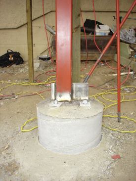

The steel cages for the concrete piers were fabricated on site using #5 rebar with #3 ties, according to the engineer’s specifications. During the pour, we embedded 1-inch-thick steel base plates—fabricated off site—in the concrete piers. Each base plate was fitted with four 24-inch-long by 1-inch-diameter J-bolts to anchor it to the pier. We used about 7 yards of concrete to complete the five piers.

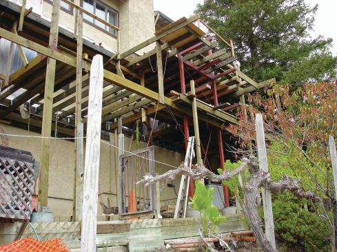

To resist seismic forces and control movement of the deck relative to the house, a three-story welded steel moment frame was required. The moment frame also serves as the main support system for the stair tower.
Steel moment frames consist of beams and columns joined by a combination of welding and bolting. Most modern high-rise buildings and many mid- and low-rise buildings rely on steel moment frames to resist lateral loads arising from winds and earthquakes, and they’re sometimes required for tall decks in my area. In an earthquake, lateral loads are the result of internal forces that develop as the ground—and therefore the building’s foundation—accelerates. The force, which is similar to what a passenger standing on a bus feels when it accelerates, is resisted by the bending rigidity and strength of the moment frame’s vertical and horizontal elements.

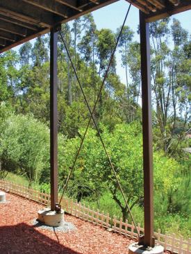

The moment frame on this project consisted of two 6-inch by 6-inch by 24-foot-tall steel columns welded to the base plates embedded in the piers. The steel columns were then connected to each other by 6-inch by 8-inch steel tubes (all 1/4-inch wall), welded into place. Two sets of 1-inch-diameter threaded-rod cross braces were added to further strengthen the frame.
I have very good steel fabricators and welders on my crew, but none are qualified to perform the AWS (American Welding Society)-certified welding required on an engineered structure like this. After we did the initial assembly of the moment frame and clamped and tack-welded the structure together, a local company that has certified welders completed the job. They worked under the supervision of special inspectors hired to oversee all the metal-working—especially the welding—on the project. Once the MIG-welding was finished, my crew cleaned and wire-brushed the welds with solvents, then brushed on a couple of coats of Rustoleum metal primer.

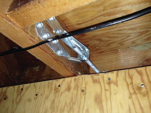

Horizontal hold-downs. Each ledger had to be connected to the house framing with Simpson Strong-Tie DTT2 tension tie hardware as well. These anchors could be attached only by removing the existing stucco—and in some cases, sheathing and interior finishes—in order to access the interior framing. Instead of specifying two tension ties per ledger (per the IRC), our engineer specified six or seven per level, in locations that corresponded to those of our vertical hold-downs.

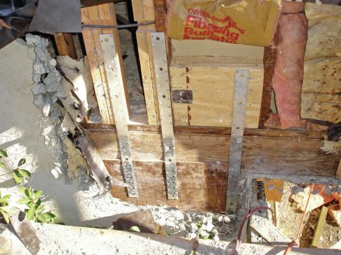

Vertical hold-downs. We strengthened the house itself against seismic forces by retrofitting vertical hold-downs that would connect the rear walls (on all three stories of the house) to the foundation in a much stronger manner. To do this, we drilled 16-inch-deep 5/8-inch-diameter holes through the mudsill and into the existing poured concrete foundation walls. After clearing out the holes with compressed air, we glued threaded rods into them with SST two-part epoxy. Altogether, seven 1/2-inch-diameter threaded rods run all the way up the walls to DTT2s at the top plate and connect the house levels together.
On the exterior, we installed vertical metal straps, per the engineer’s specifications, that connect the wall framing to the foundation. The straps are fastened to the foundation and nailed directly to the studs. In combination with the vertical hold-downs, the strapping helps create a continuous load path from the foundation up through the studs and all the way to the roof. For virtually all of the hold-down, strapping, and epoxy procedures, inspectors (from the county and from the engineer’s office) needed to view the completed work before the walls were closed up.

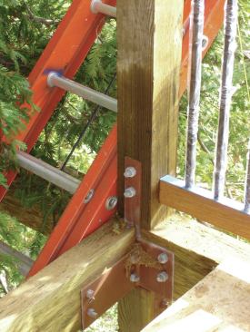

With the preliminary structural work out of the way, work could begin on the deck framing, starting with the first floor. For the most part, we framed with treated Douglas fir 6×6 posts and 4×8 girders, using standard HDG hardware whenever possible. But in addition to providing lateral strength, the steel moment frame supports much of the framing. So we also fabricated about 20 custom brackets on site from 1/4-inch and 3/16-inch steel plate and bar stock to connect the deck framing to the moment frame. These, too, had to be finish-welded by certified welders.

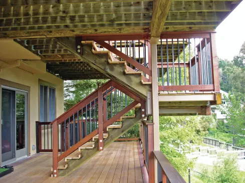

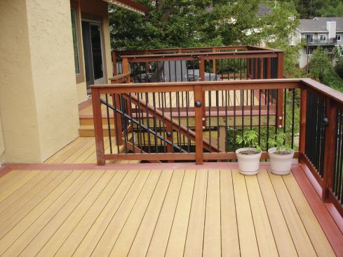

Finally, we installed the composite decking, using one color for the field and a different one for the borders to help define transitions between various areas and levels of the deck. We face-fastened the decking to the framing with GRK screws (grkfasteners.com), which have tapered heads that pull the decking down and virtually disappear, leaving a clean surface.

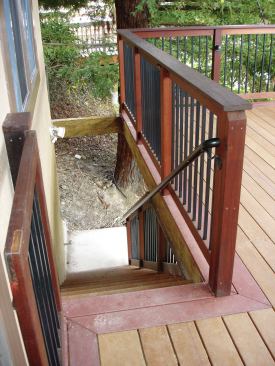

The ipe posts and rails provide not only a rich contrast to the decking but also an extremely strong railing system. We finished the guard rails with black powder-coated aluminum balusters. To meet code, the rail height had to be 42 inches, and inspectors paid particular attention to our post fastening details to make sure the rail would be strong enough. At the stairs, we also had to install graspable (between 1 1/4- and 2-inch-diameter) hand rails.
Lighting was another code consideration, since the deck would see considerable nighttime use. By code, the central tower of stairs had to be illuminated sufficiently to be used safely, so our clients worked with the architect to come up with a plan where the fixtures wouldn’t be too visible. Lighting was also required at each landing and at the entry into the house.
