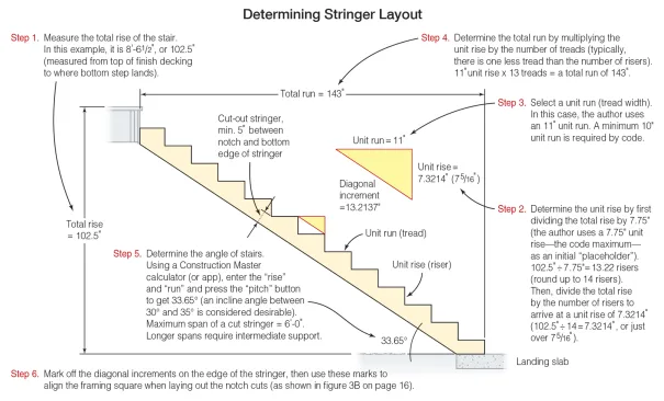

Total Rise
Start by determining the total rise, which is the vertical distance from a finished surface to a finished surface. For a deck, this would typically be the distance from the top of the decking down to a landing slab; note that it’s important to measure down to the elevation where the stairs will land, which is not necessarily straight down from the deck.
For example, the ground may be sloped away from the edge of the deck; 12 feet out, the ground may be several inches lower. That difference in elevation will affect the total rise of the stairs. It may be necessary to use a laser level or some other method to establish the height of the deck above the actual landing spot.
Unit rise. Code says the maximum allowable unit rise—the vertical distance from one step to the next—is 7.75 inches. Assume, for example, that the total rise is 8 feet 6 1/2 inches, or 102.5 inches. To determine the unit rise, first divide 102.5 by 7.75, which equals 13.22 units of rise. Since there can’t be a partial rise, I divide 102.5 by 14, yielding a unit rise of 7.3214 inches, or just over 7 5/16 inches. That’s less than the code maximum and acceptable. If I divide the total rise by 13, the unit rise would be 7.88 inches, or 7 7/8 inches, which exceeds the code maximum.
Depending upon how much horizontal room there is, a stair could have more than 14 risers. Going to 15 risers yields a comfortable unit rise of 6.8333 inches, or 6 13/16 inches (102.5 divided by 15 = 6.8333). Going to 16 risers yields a unit rise of 6.4062 inches, or 6 3/8 inches “strong”—a little shallow but still perfectly acceptable. Unless circumstances dictate otherwise, I try to avoid rises less than 6 inches because they make a stair feel choppy and so create a bit of a hazard.

The author determines the stair’s total and unit rise and run following the steps above, then calculates the diagonal increment using the Pythagorean theorem. In this example, the increment is 13.2137 inches. He makes a pencil mark every 13.2137 inches along the edge of the stringer stock to guide the placement of the notched cuts.

With a unit rise of 7.3214 inches and unit run of 11 inches, you can determine the angle of the stairs. Many carpenters—myself included—enter the rise and run into a Construction Master calculator (or app) and press the “pitch” button to get 33.65°. An angle between 30°and 35° is desirable, so we are right in that sweet spot. Another way to determine this angle is by using the inverse tangent function on a scientific calculator (I use a TI-30Xa): First, divide the rise (7.3214) by the run (11) to get 0.6655. On my calculator, I’d press the “2nd” button followed by the TAN key to get 33.64°.
Diagonal increment. Because of the Pythagorean theorem (a² + b² = c²), we know that the diagonal (hypotenuse) of a right triangle with a 7.3214-inch rise and 11-inch run is 13.2137 inches, or 13 1/4 inches light. This basic formula is the key to figuring rise and run angles for stairs, rafters, and whatever else you build that involves an angle other than 90°. And this diagonal increment is my key to accurate stair stringer layout.

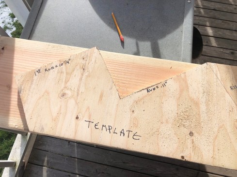

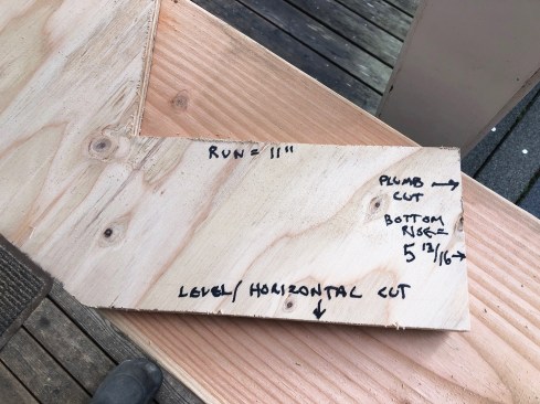

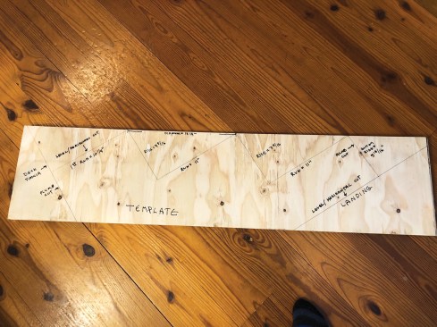

Template. Before I begin laying out and cutting stringers, I like to make a template so I can check the calculated plumb cut at the top and the level cut at the bottom. I rarely have a scrap piece of 2×12, so I make the template out of plywood ripped to the width of my stringers, typically 11 1/2 inches. I then make the top and bottom cuts as shown below to check that my math is correct.
After calculating the unit rise and run following the steps shown in the drawing above, the author lays out a few treads and risers on scrap plywood ripped to the width of the stringer stock.
Cutting out the sawtooth tread-and-riser pattern on the template allows him to use it to check the fit at the top of the stairs.
The template also makes it easier to confirm that the level cut at the bottom of the stairs accounts for the thickness of the tread.
The template allows you to check your math – and correct mistakes – prior to laying out and cutting expensive stringer stock.

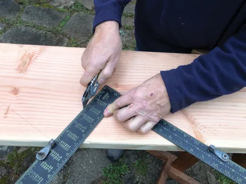

When I started as a carpenter, I was taught to set the stair gauges on a framing square to the rise and run—in this case, 7 5/16 inches and 11 inches—and mark the layout with a utility knife rather than a pencil as I slid the square down the board. This was because a pencil line was considered inaccurate and could cause an accumulation of errors. While a utility knife is better than a pencil, this method can still cause errors. By using a calculator and its plus/equals function, as described below, I eliminate any possibility of an accumulation of errors. In the “old days,” you would also use one stringer as a template for the other(s), which could also cause minor layout errors. But laying out the diagonal increments on each stringer with a calculator eliminates the possibility of an error creeping in to the transfer of the layout.

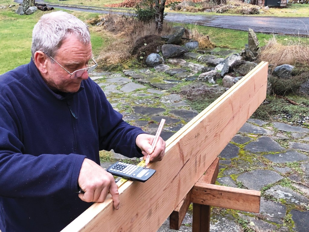

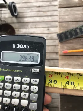

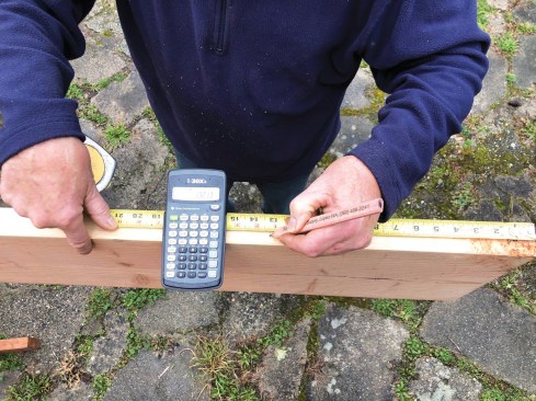

Start by making a mark on the edge of a 2×12 near one end, with the crown up. Pull a tape from that mark and make another mark 13.2137 inches—or 13 1/4 inches light—along the board. Using a calculator that does plus/equals, add 13.2137 and 13.2137 to get 26.4274 (or 26 7/16) inches, and make another mark there. Keep hitting equals and we get the following:
  • 39.6411 (39 5/8 inches strong)
  • 52.8548 (52 13/16 inches strong)
  • 66.0685 (66 1/16 inches)
  • 79.2822 (79 1/4 inches strong)
  • 92.4959 (92 1/2 inches)
  • 105.7096 (105 11/16 inches strong)
  • 118.9233 (118 15/16 inches)
  • 132.137 (132 1/8 inches)
  • 145.3507 (145 3/8 inches light)
  • 158.5644 (158 9/16 inches).

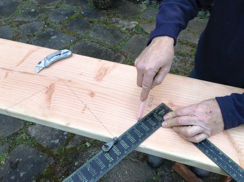

We now turn the board on its side, set the stair gauges (I prefer ones made by L.S. Starrett) on a framing square at 7 5/16 inches strong and 11 inches, and mark the notch cuts with a utility knife, using the pencil marks to guide the placement of the framing square. The stringer layout will be perfect, with no accumulation of errors.
The author places his stringer stock on edge with the crown up to mark the diagonal increments.
He uses the plus/equals function on his calculator to determine the exact distance of each diagonal increment from his starting point.
After marking off the increments, he uses them to guide the placement of the framing square as he marks the notches with a utility knife.
Then he highlights the layout lines with a pencil to make them easier to see when cutting the notches.

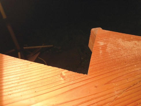

Cutting the Stringers

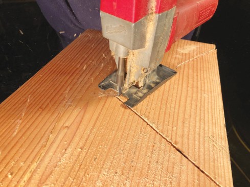

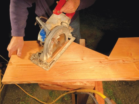

I cut the notches in stringers with a circular saw, stopping at the crotch of the cut and finishing with a jigsaw so as not to weaken the stringer by overcutting.
The stringer’s bottom cut is determined by the thickness of the tread material. If it’s 2-by stock, I cut 1 1/2 inches off the bottom of the stringer. In other words, measure the thickness of the tread material and cut off that amount from the stringer. If the bottom of the stringer were not cut, then once the treads were added, the top step would be too short—5 13/16 inches—and the bottom step would be too tall—8 13/16 inches.

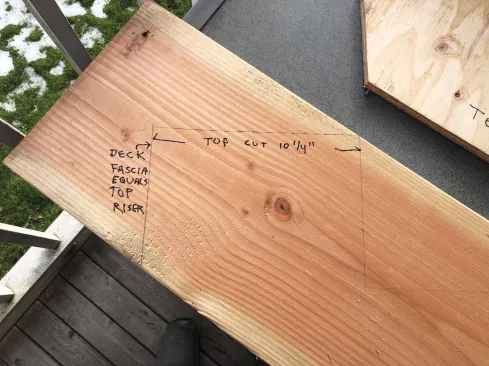

The connection detail at the top determines the top cut. If the stringer is attaching directly to a finished top riser, and the last deck board or boards project 1 inch over that riser, then we want the first tread nose to be 11 inches away, measured horizontally, from the nose of that deck board.
To avoid overcutting the notches, which would weaken the stringer, the author starts the cuts with a circular saw…
…but he doesn't finish them.
Instead, he finishes the cuts with either a handsaw or a jigsaw, which offer more precise control of the cut.

Making the vertical cut at the top of the stringer at 10 1/4 inches from the cut for the first riser allows for 3/4-inch-thick risers. Since code doesn’t allow any opening larger than 4 inches on the stairs at the treads, risers are required on cut-out stringers. I typically make these using 3/4-inch-thick stock. They need not be the full height of 7 5/16 inches, but they must not allow a sphere greater than 4 inches through the space under the tread.
