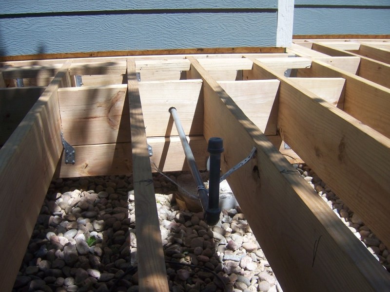

Building codes definitely apply when a gas distribution system from the home is extended to permanently serve the outdoor grill. Regardless of licensure requirements, which vary from state to state, only trained and professional plumbers or mechanical contractors should install gas lines; however, there are a few things you as the designer should understand and consider. First, make sure the construction schedule allows for painting the common black iron gas pipe for protection from corrosion.
The gas pipe stub needs to extend high enough above the finished decking so that a minimum of 2 inches of unthreaded pipe is exposed. On a low deck like this, it is a good idea to paint the pipe prior to decking installation.
Glenn Mathewson The gas pipe stub needs to extend high enough above the finished decking so that a minimum of 2 inches of unthreaded pipe is exposed. On a low deck like this, it is a good idea to paint the pipe prior to decking installation.
The plumber also needs to be guided on how far to stub the line up from beneath the deck, and that means knowing the thickness of the decking. In order to tighten the threaded fittings on gas pipe, a pipe wrench needs sufficient unthreaded pipe to clutch. The IRC requires that the gas pipe extend through the floor enough to expose a minimum of 2 inches of unthreaded pipe. Simple to do, but simple to overlook. Also, the pipe stub cannot be located behind a door, where it would be subject to physical damage should the door repetitively be opened into the pipe.
