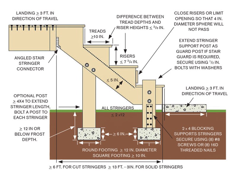

Before getting into deck stair defects, let’s look at how DCA 6 recommends that stairs should be built, starting with the stringers, risers, treads, landings, and the components that support them (Figure 1). When I’m evaluating a deck stair, this is where I start.
Stringers typically have two bearing points, with the plumb (vertical) cut bearing on a rim joist or on a beam, and the seat (horizontal) cut bearing on—at minimum—a solid landing. To help resist both vertical and lateral loads, stringers require proper support and attachment at these bearing points. Without proper support, vertical loads (gravity) can pull the stringers down from their bearing points, while lateral (horizontal) loads can pull the stringers away from their bearing points. Most builders worry more about vertical loads, but lateral loads are also a frequent cause of a deck stair failure: The fasteners withdraw from the bearing point, then gravity takes over.
Seat cut. DCA 6 recommends supporting the stringers using posts that bear on footings, but this is an installation detail that I can’t recall ever seeing. If there is good stringer bearing on a solid landing, and if the stringers are restrained against lateral movement, I usually declare victory and move on. But I live in a warm climate, where we don’t have to worry about frost heaves that could move the stringers and loosen the connection at the plumb cut. Those who build decks in cold climates should consider using the DCA 6 details.

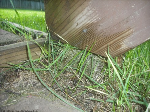

At least 1 1/2 inches of the heel of a stringer's seat cut  should bear on the landing. Allowing the toe of the seat cut to be the only part of the stringer that bears on the landing can cause the stringer to shear along the wood grain.
It’s best if the entire stringer seat cut bears on a solid landing, but at minimum, at least 11⁄2 inches of the seat-cut heel should bear on the landing. Allowing the toe of the seat cut to be the only part of the stringer that bears on the landing can cause the stringer to shear along the wood grain.

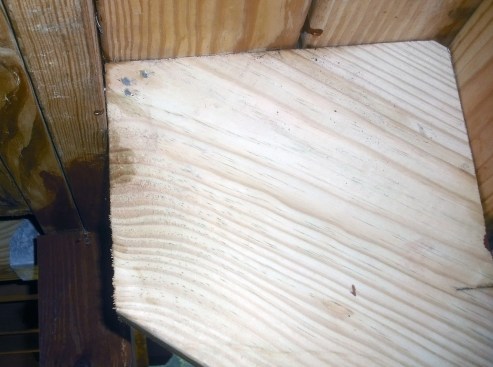

Plumb cut. For maximum plumb-cut bearing and fastening area, the ideal stringer position has the top tread even with the deck flooring, which allows the stringer plumb cut to fully bear on the rim joist or beam. This location makes installing the stair guards and handrails more difficult, however, so it’s more common to see the top tread dropped one riser below the deck flooring. Unfortunately, I’ve found that this often leads to unsafe attachment details with inadequate bearing that can allow the stringer to shear along the grain.

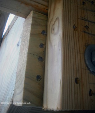

Dropping the stringers without also installing a dropped header can lead to a situation like this, where the stringers have inadequate bearing on the rim joist.

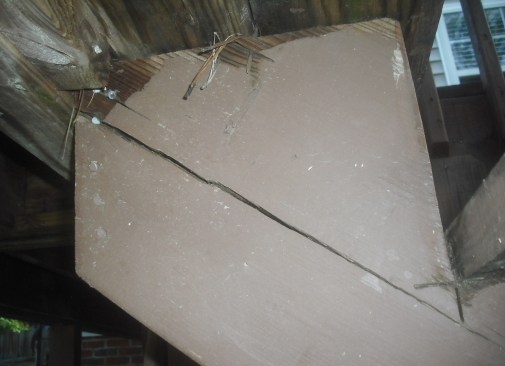

The risk is that the stringer will split along the grain.  This photo is new construction that was approved by the local building inspector.
Stringer attachment. One of the most serious deck stair defects is a poor connection between the stringers and the deck. Failure at this important connection is common, particularly when the stringers have been nailed to the framing, because nails are subject to withdrawal.

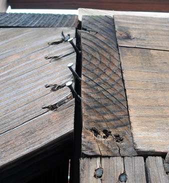

For example, I often see stringers fastened to a dropped header with nails driven into the stringers’ end grain. If the stringers are also bearing on—but not attached to—a landing and have no other attachment to resist lateral loads, the nails will do little to prevent the stringers from pulling away from the framing. If the stringers are bearing on the ground, the problem is even worse.
Toe-nailed stringers are less susceptible to withdrawal, but the connection can still fail as the framing ages and is structurally compromised.
Attaching stringers to a dropped header with nails as shown here is a risky fastening method because nails driven into lumber end grain have minimal resistance to withdrawal.

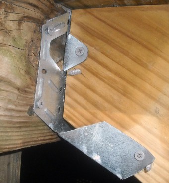

At a cost of a few dollars each for the connectors and recommended fasteners, the most cost effective way to hang a stringer is with metal hardware. But this one - a Simpson Strong-tie LSU26Z - has been installed incorrectly, since the stringer isn't fully bearing on the connector seat. Another red flag: drywall screws instead of approved connector fasteners have been used to fasten the connector to the framing.
At a cost of a few dollars each for the connectors and recommended fasteners, the most cost effective way to hang a stringer is with metal hardware. But this one – a Simpson Strong-tie LSU26Z – has been installed incorrectly, since the stringer isn't fully bearing on the connector seat. Another red flag: drywall screws instead of approved connector fasteners have been used to fasten the connector to the framing.
Sometimes the stringers are toenailed to the deck framing, an attachment method where the nails aren’t quite as subject to withdrawal. Sometimes this method works—if an adequate quantity of the correct nails is properly installed (there are rules about how to correctly install toenails), and if the wood and the nails maintain their integrity over the life of the deck. That is a lot of ifs.
To avoid extra work and eliminate drop headers, end-nailing, toenailing, and other questionable stringer connection methods, DCA 6 recommends the use of metal hardware specifically designed for stringers, such as Simpson Strong-Tie’s LSCZ or LSSU connectors. At a cost of a few dollars each for the connectors and recommended fasteners, this is the most cost-effective stringer connection method.
But in order to provide both the vertical and lateral support for the stringers, these connectors must be installed according to manufacturer’s instructions. For example, stringers should fully bear on the connector seats. Screws are not allowed—unless specifically allowed by manufacturer’s instructions, and then only manufacturer-supplied screws may be used. Deck screws and drywall screws are not allowed. Finally, the round and oblong holes are there for a reason: They are saying, “Put a fastener here.”
Stringer construction. Almost all stringers on deck stairs are cut stringers. The two most common cut-stringer defects that I see are overspanning and overcutting.
The minimum recommended size for a deck stair stringer is 2×12, which has a maximum recommended unsupported span of 6 feet. Often this maximum span is dangerously exceeded, resulting in overspanned stringers that will deflect and cause the connection at the deck to pull loose and fail. In some cases, overspanned stringers may shear along the wood grain.
The minimum recommended depth of the uncut portion of the stringer is 5 inches. The measurement is to the saw kerf, and it’s common to find stringers with dangerously overcut notches. Stringers that are overcut have the same potential failures as overspanned stringers. In both cases, they can be repaired by installing intermediate support posts.
Risers and Treads

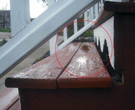

In both DCA 6 and the 2015 IRC, requirements for riser height and tread depth are 7 3⁄4 inches (max.) and 10 inches (min.) respectively, though local requirements vary. These measurements are taken at the leading edge of the treads.
To me, the more important safety issue is that the riser heights and tread depths be uniform. Risers or treads that vary more than 3⁄8 inch between any two risers or treads create a fall hazard, because people become accustomed to a certain feel when using stairs. A variance can cause someone to lose balance and fall. The most common location for a large variance between riser heights is at landings.

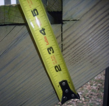

Overcut notches weaken a stringerand may cause it to fail. The minimum recommended depth of the uncut portion of the stringer is 5 inches, as measured to the closest saw kerf, and not the notch itself.

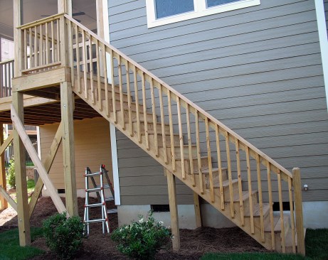

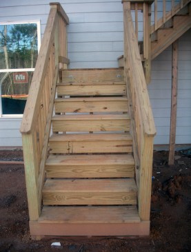

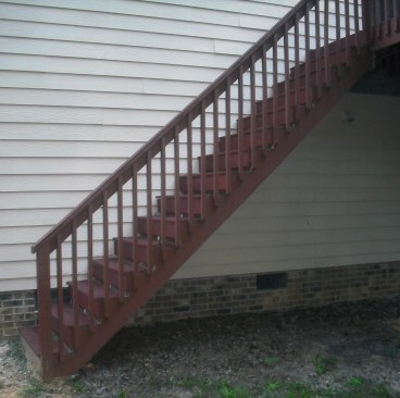

Stairs that are higher than 30-inches off the ground are subject to the same guidelines as railings, which means that open risers that permit a 4-inch dia. sphere to are greater than
Many deck builders seem to be unaware that open risers allowing a 4-inch-diameter sphere to pass through are not permitted on stairs that are more than 30 inches above grade (or the floor below). This is a common defect in older decks, but I often find it on newer decks too.

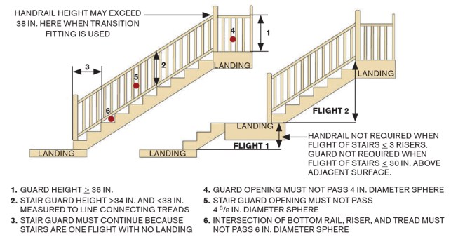

Here are the recommended standards for deck stair guards, which are subject to the same requirements as interior stairs.
Guards
Guards for deck stairs share the same requirements as guards for interior stairs. Two of the more common stair-guard defects I see include failing to install vertical infill components so that a 4 3⁄8-inch-diameter sphere will not pass through, and failing to install the guard bottom rail so that a 6-inch-diameter sphere will not pass through the triangle created by riser, tread, and guard bottom rail.
Bottom guard rails on stairs should be oriented close enough to the tread nosings so that a a 6-inch diameter sphere will not pass through the triangle created by the riser, tread, and rail.

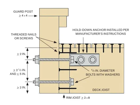

A strong connection between guard posts and deck framing is critical to deck safety. Shown here is an example of a connection made with a metal hold-down anchor.
Guard posts must be able to withstand a 200-lb. load in any direction. The easiest way to comply with this requirement is to install hold-down connectors, especially at the top of the stairs, following the manufacturer’s instructions.

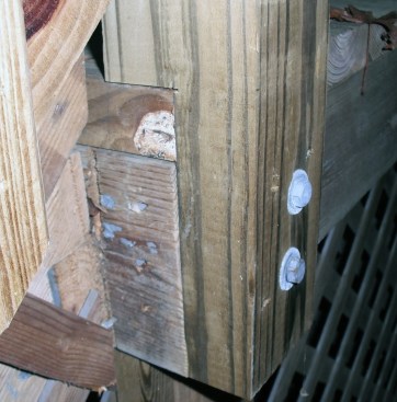

Guard posts that have been notched around the framing may develop cracks originating  in the corner of the notch and running parallel to the grain. Notching weakens a post, and should be avoided.
Posts should never be notched around the framing, because that practice increases the odds that the post will develop cracks that originate in the corner of the notch and run parallel to the grain, weakening the post.
