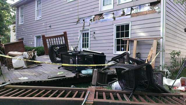

The beginning of summer brings outdoor parties, cookouts — and deck collapses. The past week’s news included a rash of deck failures around the nation as families and friends gathered for outdoor events.
Three people were hurt when a deck fell ten feet during a Memorial Day get-together at a house in Duluth, Georgia, reports local station WSBTV (“Deck collapses at Duluth home during Memorial Day cookout“). “All of a sudden I was like ‘What?’ And the furniture is sliding,” Clarissa Sewell told a reporter. “My brother in law got hit by the grill. It was wild.”
FOX 5 Atlanta also covered the Duluth failure (“3 injured in deck collapse at Duluth home,” by Denise Dillon). Alpharetta home inspector C. C. Motes, of Allview Home Inspections, pointed out that most deck failures occur because of weak connections to the house, observing: “If the rim joist is not attached to the house properly then the band board for the deck is not going to do any good.”
