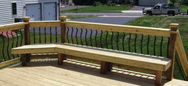

Many deck builders have told me that they rarely build wood rails anymore. Their customers are opting for low-maintenance finishes, and they’re installing manufactured rail kits and components made from vinyl or composites. As Matt Breyer of Breyer Construction and Landscape, in Reading, Pa., explains, “Of the 100+ decks we build each year, we might do five that have wood railings.” Breyer says that even when installing a standard PT deck with a wood railing, he prefers to use Deckorators metal balusters, simply for ease of maintenance.

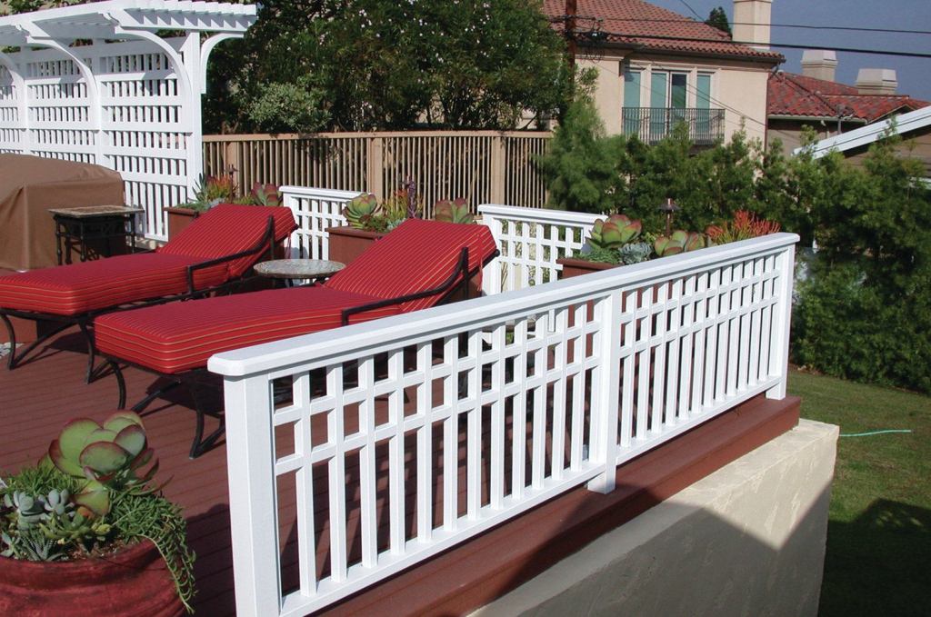

California Style
While I think it would be expensive to build and maintain and wouldn’t be a good choice in a freeze/thaw climate, like in New England or the Midwest, one of my favorite designs is this elegant painted rail by Gary Cherene of Redondo Beach, Calif. Cherene says he can assemble the balustrade using hollow Trex composite balusters reinforced with wood, though the one shown here was built with redwood. He cuts the vertical balusters and horizontal crosspieces from S4S 1 3/8-inch by 1 3/8-inch stock, and uses standard 2×4 and 2×6 stock for the rails. He profiles the edges of the 2×6 cap rail using either an ogee or a classical bit.
According to Cherene, the trickiest part is installing the crosspieces so that they’re perfectly aligned. He does this by first fastening the vertical balusters to the top and bottom 2×4 rails, then snapping a pair of chalklines to mark the locations for the crosspieces. As he fastens them along his marks to the balusters with 3-inch-long stainless steel toe screws, he continually checks their alignment by eye.
Cherene typically contracts with a professional painter to spray the completed rails in place with a primer coat and three finish coats of high-quality exterior latex paint.

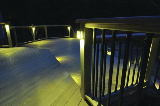

Built for Lighting

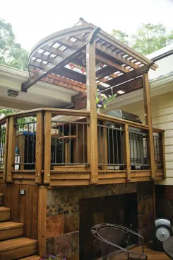

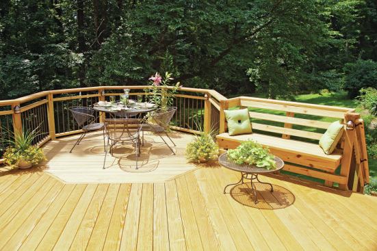

John Paulin’s railing system is designed to accommodate deck lighting and various types of balusters as well as cable infill. The key is his two-part upper rail assembly, which he has custom-fabricated from clear, vertical-grain pressure-treated southern yellow pine.
The lower, 2×4 subrail has a 1/2-inch-deep by 1-inch-wide wiring chase routed into its upper surface. A corresponding 1/4-inch-deep chase is routed into the underside of a 2×6 cap rail that fits on top of the subrail, allowing the wiring to run unseen over the rail posts. The underside of the cap rail also has a 1/8-inch-deep by 3 1/2-inch-wide channel that creates a keyway for the subrail. To accommodate wiring that leads below deck or to a post-mounted fixture, he rips his posts into two pieces and routs 1/4-inch-deep channels into the center of each cut edge.
Most of Paulin’s customers prefer his double top-rail design, in which a 4-inch gap separates the lower balustrade from the upper handrail. He typically builds the rail sections using standard 26-inch-high metal or wood balusters and 36 1/2-inch-high railing posts. Once the 2×6 cap rails are added to the assembly, the top of the railing is about 38 inches above the decking.
Post spacing is typically no more than 4 feet on-center, though Paulin says he’ll increase that to 4 feet 6 inches when using stronger, vertical-grain PT pine material. To prevent sagging, he supports the middle of the longer rail section with a block.

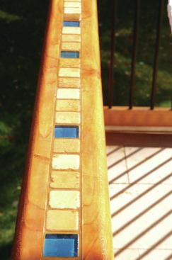

Tile Rail

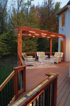

According to landscape designer Bruce Zaretsky, the tile inlay shown here was a spontaneous design by his crew, and a surprise for his client. Following the installation of a travertine inlay “carpet” in a deck project, his carpentry foreman had some leftover blue floor tile on hand, and his crew decided to combine it with leftover travertine offcuts to create the inlay in the deck’s 2×6 cedar cap rail.
Later, the client sealed the cedar and tile with a coat of polyurethane to keep it waterproof. This proved to be a mistake, as the sealer eventually yellowed and flaked off. Now, sealer is applied just to the wood and not to the tile, which has a silicone bead run over the grout lines to help keep water out.

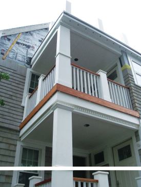

Classic Hybrid

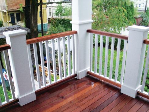

Emanuel Silva of Silva Lightning Builders in North Andover, Mass., has been tweaking his classic rail design for years to continually improve its ability to stand up to the Boston area’s harsh climate. It can be built with either wood or composite materials; in the version shown here, the upper and lower rails were made of 2×4 mahogany to match the decking, while the 1 3/8-inch by 1 3/8-inch balusters were painted fir. Silva cut the 1/2-inch by 1 1/2-inch subrails from PVC sheet goods, along with the column and post wraps and porch trim.
First to be installed were the upper and lower mahogany rails, which Silva had dressed up with a beaded profile and prefinished with a couple of coats of Penofin. He fastened the rails to the posts with pairs of 2 1/2-inch-long Kreg HD heavy-duty coated pocket screws, locating the holes so they would be hidden by the subrails once the railing inserts were installed. Silva notes that the screws must be long enough to penetrate both the PVC trim and the structural PT posts. He likes to wrap the posts with Grace Ice & Watershield SAF membrane, because it self-seals around the screws and helps keep moisture out of the posts.
Silva primed the balusters—including the ends—and cut the PVC subrails to length, then assembled the railing inserts on a flat work table. To speed assembly, he used a spacer block to position the balusters and pinned them to the subrails, using pairs of 16-gauge galvanized finish nails driven through the subrails and into the ends of each baluster. Then he drove coated 1 1/4-inch deck screws through the subrails and into the ends of the balusters.
When he installed the rail inserts, he fastened them to the top and bottom rails with stainless steel screws about 8 inches on-center. Silva says he occasionally predrills holes for the screws and plugs the holes, but usually he just overdrives the screws a little and uses filler to conceal the holes. One thing he doesn’t do is the finish painting; he subs that out.

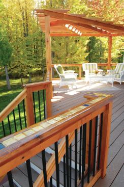

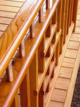

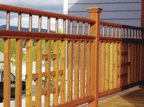

Copper Top
One way to dress up a standard PT rail system is to add copper. Oregon deck builder Mac MacDonald cut Type M 3/4-inch diameter copper tubing (typically used for domestic water systems and widely available at hardware and building supply stores) into 4 1/2-inch lengths and inserted them into holes bored into the upper surface of a 32-inch-high guardrail. He then installed the upper caprail, which has corresponding 1/4-inch-deep holes cut into its underside. Unlike the posts, subrails, and balusters, the lower, intermediate, and upper rails were made of red cedar, and were prefinished with an exterior polyurethane varnish. A horizontal blocking detail let into the balustrade adds an interesting visual element to the rail. Carefully cut lap joints were required to avoid weakening the balusters.
