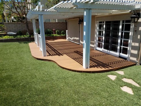

As an alternative, I offer what I refer to as “cut radius” decking. Using a few basic tools and carpentry techniques, it’s possible to cut extremely smooth curves. This in turn allows me to create rounded deck features without the steep price that comes with bending.

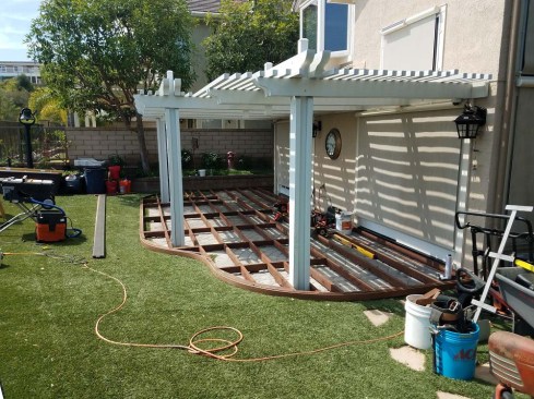

Most of the curved decks my company builds are close to grade and rarely require scaled drawings, especially when no permits are needed and a plan review isn’t necessary. Instead of working from a plan or using a string to pull an arc, I like to play around with different shapes and find the size and configuration of the curves right on the ground using flexible ½-inch-diameter PVC irrigation pipe and trial templates cut from ¼-inch-thick MDF.
An irregularly curved rim joist defines the perimeter of this grade-level deck. The author used flexible PVC pipe to lay out the curves.

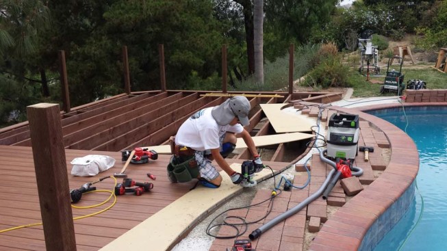

Prior to installing the decking, the author scribes the outline of the framing onto sheets of 1/4-in. MDF, and makes a template.

When framing, I typically support the joists with a drop beam and run the cantilevered joists long. Then, depending on the joist layout and particular framing details, I can go ahead and lay out the curves directly on top of the joists and cut them to their final lengths. Before cutting any joists, however, I make a final MDF template. MDF is an easy material to cut and shape to a desired layout, and it makes for a smooth ride for saws and pencils. This results in more accurate cuts, with the proper bevel angle to match the curve I’m trying to form.

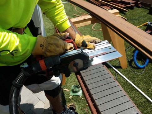

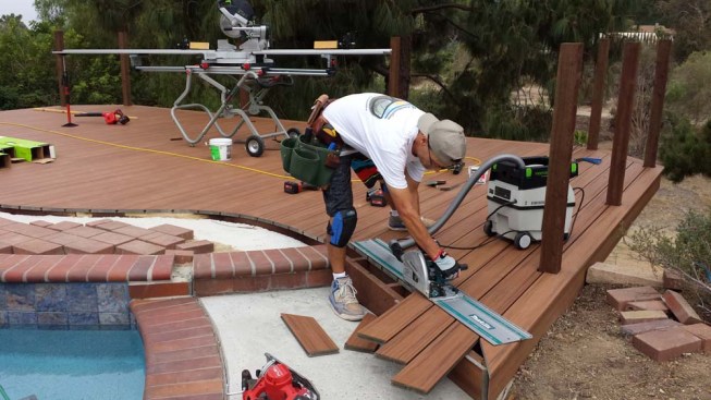

With the MDF template as a guide, the decking can be accurately trimmed with either a small circular saw or a router (for tighter curves) to follow the curved rim joist.

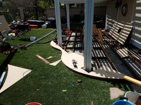

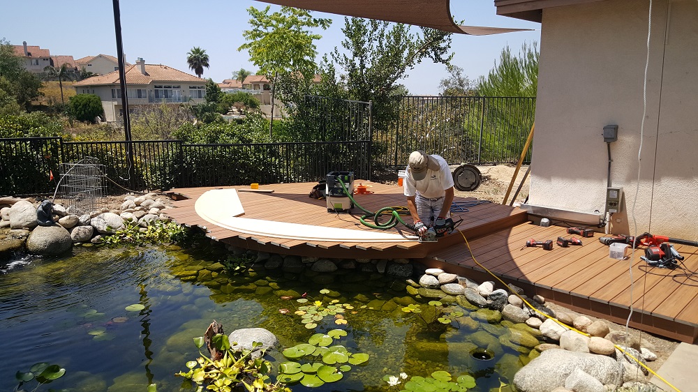

A pair of MDF templates are usually needed: The lower one defines the actual outside edge of the curved fascia, while the upper offset template is sized to guide the base of the saw as it cuts the decking.
The upper template guides the base of the saw as the author trims the decking to the curve.

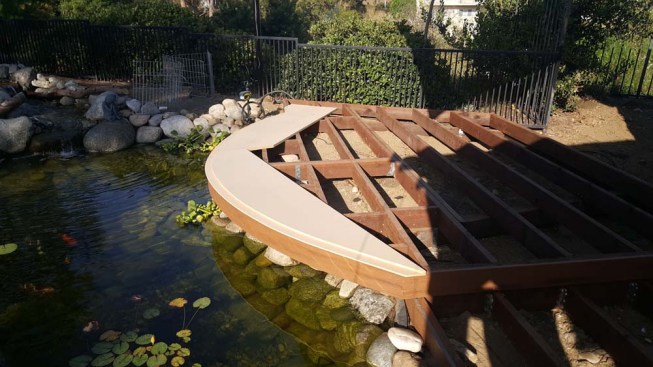

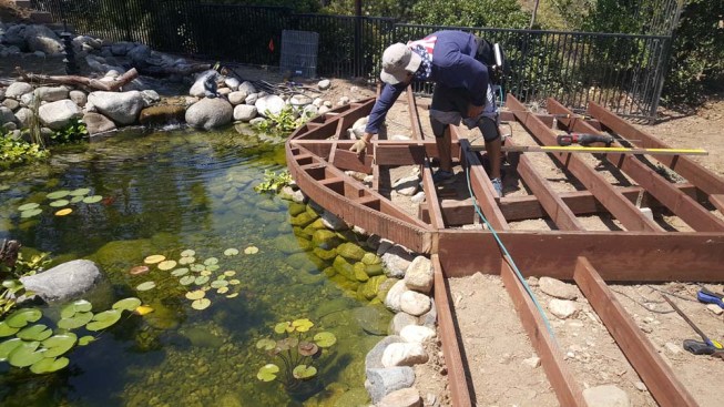

Sometimes, I have to be a little more creative with the framing. For example, on one project my clients wanted a grade-level deck that would cantilever out over a pond without any visible framing underneath. To frame it, I installed a cantilevered beam in the center of the proposed radius; that beam then supports a pair of straight “spring line” rim joists and the curved outer rim joist. To maintain the curve, I packed the gap between the spring-line rim joists and the outer curved rim with blocking.

After the framing is complete and I’ve installed the composite fascia, I spread out enough pieces of MDF to cover the entire curve. Then I use a small block that’s 5/8 inch larger than the fascia (the desired nosing on all of the decks that we build) or a SimpleScribe tool (handy for scribing various widths and reveals) to mark the outline of the curve onto the MDF. Before removing the marked MDF sheets from the framing, I make reference marks to make sure I’ll know exactly where everything goes when I place the template over the decking.

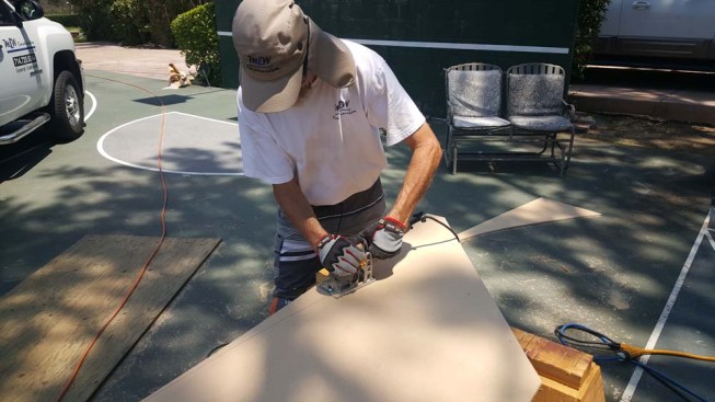

When making the template, I cut carefully and as close to the line as possible without going over it accidentally, typically doing most of the work with a Rockwell RK3440K VersaCut mini circular saw. For tighter curves, I use a jigsaw. Then I carefully clean up and smooth out the template edge with a belt sander.
Here, the author is using a small circular saw to trim an MDF template to the scribed line. He'll clean up and smooth out the cuts with a belt sander.

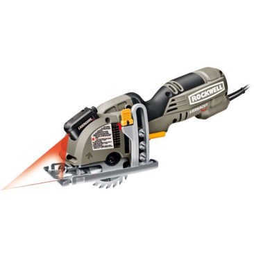

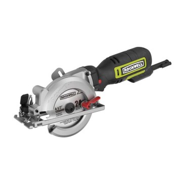

Rockwell's RK3440K VersaCut is one of a pair of mini circular saws that the author uses to cut curves in MDF and decking.
The other is Rockwell's RK3441K 4 ½-in. compact circular saw.
Next, I trace this template onto another piece (or pieces) of MDF, to preserve the pattern. Then, I scribe an offset line–using the distance from the blade to the outside edge of the shoe of the saw that I’ll use to cut the decking–and cut along it to create another template. When I cut the decking, I’ll lay this second template on top of the first to guide the base of the saw – typically a Rockwell RK3441K 4 ½-inch compact circular saw. Again, I’m careful to follow the cut line closely with my saw and smooth the edges afterward with a belt sander to get the curves as close as I can to perfect, making sure I don’t remove too much, to maintain consistency in the nosing.
Cutting the Decking

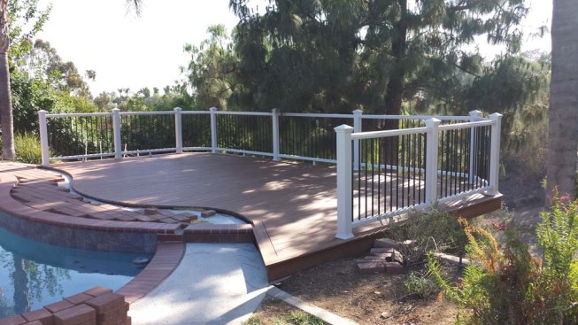

Most of the time, I cut the decking using a Rockwell 4 ½-inch circular saw guided by my template. But for tight curves, I use a router. First, I rough-cut the fat off with a jigsaw or even the circular saw, so that I’m not trying to bite off too much at one time with the router.

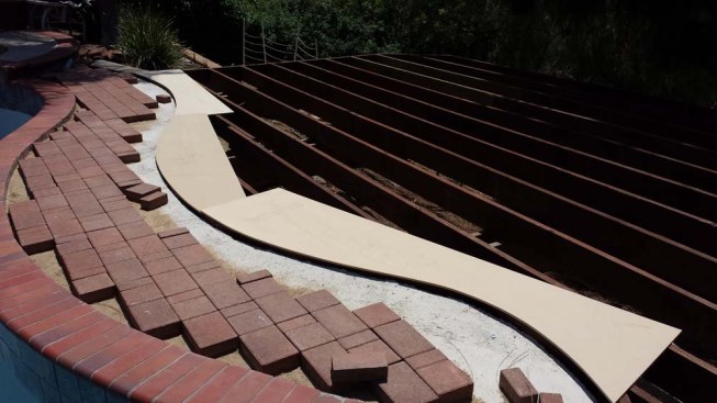

This deck was designed to follow the contours of the pool coping. After scribing and cutting it, the author makes reference marks on the template and the concrete so that it is accurately positioned when he trims the decking.
After installing the decking and cutting it to within 1/8-in. of the scribe line, the author uses a router with a top-mounted bearing riding against the template to trim the decking to the final shape.
Some guys are happy making multiple passes to trim a lot of material off the ends of the decking. In that case, an up-cut bit works fine; it will leave some frayed edges on the cap, but a few passes with a razor knife dragged across the edge of the decking tends to clean off the fuzz. I prefer to trim the decking in a single pass, though, so I carefully rough-cut the decking to within 1/8 inch of the cut line with my saw first. Then I can use a down-cut spiral bit, which evacuates the shavings better, and trim the decking with a glass-smooth finish in a single pass. I use a Whiteside solid carbide ½-inch-diameter downcut router bit with a guide bushing riding against the MDF template.
