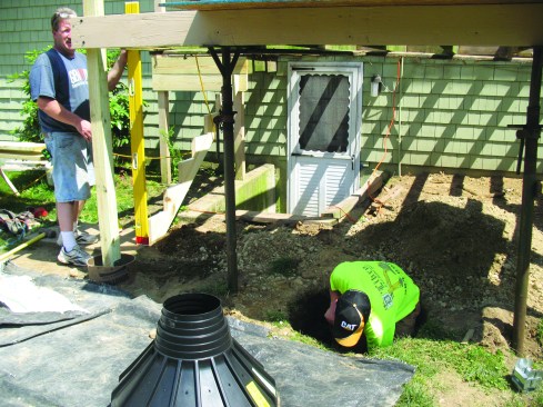

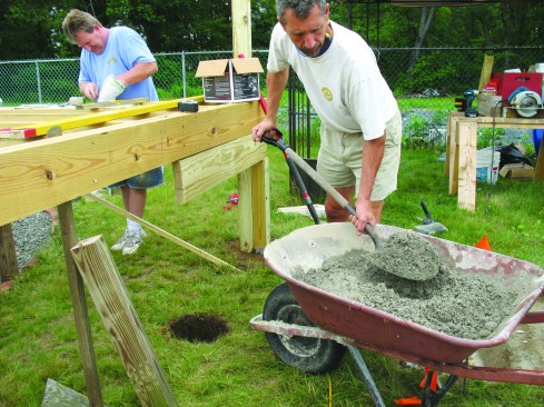

When a deck is above grade by more than a couple of feet, Guertin doesn’t pour the footings right away. First, he digs the holes and inserts the forms. Then he frames the deck, propping the beam up with temporary supports and suspending the finish support posts above the footing holes.
That approach allows Guertin to schedule the framing and footing inspections at the same time, instead of waiting a day or two for the inspector to come out and check the footing holes. When the inspection is complete, the concrete can be placed and the crew can go ahead and start the decking installation on top of the frame.
In a top-down framing approach, the deck is framed on temporary supports.
Mike Guertin
This allows for more accurate placement of the footings. In some jurisdictions, the approach allows for a single inspection visit for framing and footings.
Mike Guertin

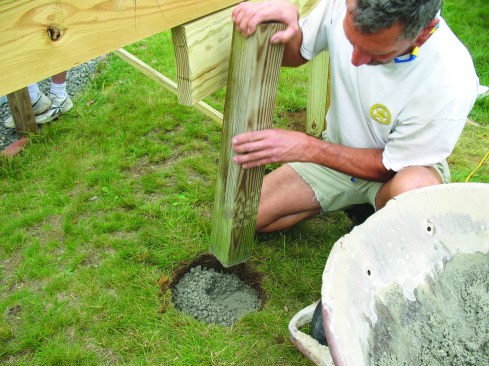

Greg DiBernardo, owner of Peachtree Decks & Porches, in Atlanta, is another deck builder who recommends framing from the top down. DiBernardo says it’s easier to accurately locate the footings, especially on irregular terrain, with the framing in place. It also allows his crew to dig the footings when the timing is most efficient for their schedule. For example, if two workers are laying decking, a third worker can start digging the holes.
Another advantage of top-down framing is that it allows a crew to work around the weather. And DiBernardo agrees with Guertin that it’s sometimes possible to get footing and framing inspections at the same time (which the inspectors like too, because it saves a trip for them). Occasionally, says DiBernardo, projects receive the final inspection along with the footing inspection if there is a good relationship with the inspector.

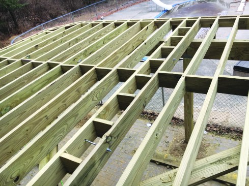

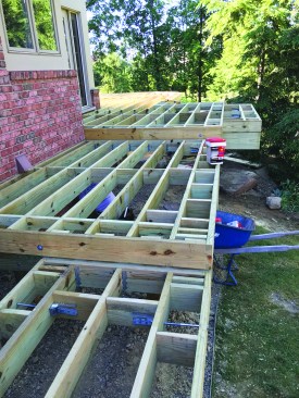

Seam boards—where a deck board (or boards) is installed that runs at a right angle to the main field decking, usually to avoid butt joints and to get the best usage of decking lengths—typically require additional blocking for support. Most deck builders simply nail (or screw) joist blocking between two main deck joists, with no other connection to hold the ladder-like assembly together. But Wood has found that as the decking expands and contracts over time, the blocking gets pulled away from the joists because of the weak connection into the blocking end grain. So Wood reinforces the blocking with DTT2Z brackets or 1/2-inch-diameter threaded rod (or both) installed every 6 feet to hold the assembly together.
Threaded rod should be used to reinforce the ladder-like blocking used to support seam boards.
Bayn Wood

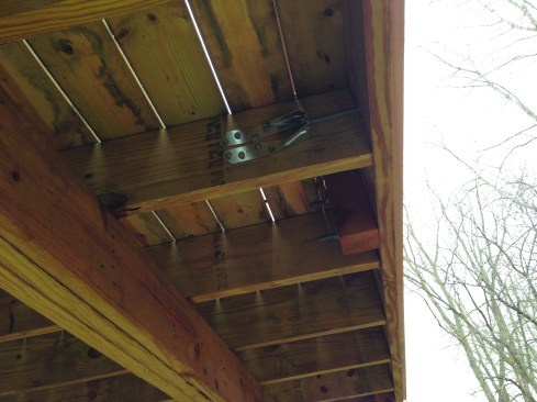

Lateral-load brackets are often required to reinforce the connection between cantilevered joists and the rim joist.
Bayn Wood

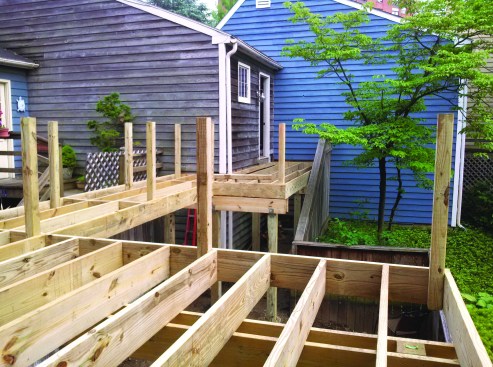

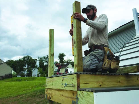

Tacking guard posts in place as the deck is framed ...
Tacking guard posts in place as the deck is framed …
... then going back later to install blocking and plumb the posts all at once can help speed installation.
… then going back later to install blocking and plumb the posts all at once can help speed installation.

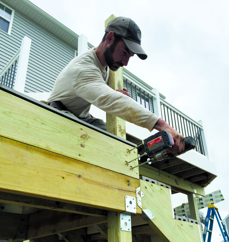

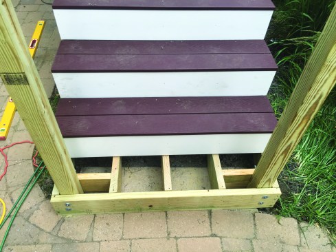

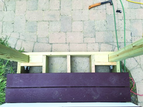

When you’re installing the stair stringers, Matt Breyer points out that it can be tough to keep the bottom of the framing from twisting with all the abuse the lower rail posts get. To help strengthen this assembly, Breyer installs both vertical and horizontal blocking, which not only locks the posts in place and ties the stringers together, but also provides solid support for the decking.
Both vertical and horizontal blocking can be used to reinforce the connection between stair guard posts and the stair stringers.
Matthew Breyer
Remember that blocking installed on the flat should be protected from water intrusion with a peel-and-stick flashing membrane.
Matthew Breyer
