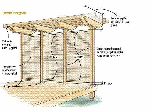

I believe in the KISS (keep it simple, stupid) principle when it comes to designing pergolas and arbors; most of mine spring from one simple design (Figure 1). My basic pergola usually runs along one side of a deck, appears T-shaped when viewed from the end, and is filled in with vertical lattice panels, which create a privacy screen. This last feature in particular is an easy sell, as it goes a long way toward distinguishing a deck while offering shade and privacy.
Figure 1. The author uses the golden section, a classic ratio of 1.618 to 1, to calculate the dimensions of the privacy screens. He custom builds the trellis from materials that match the decking.
Adding a second basic pergola and bridging between the two with longer rafters creates a more elaborate structure. This approach works well with modular pricing, too. I already know what one basic pergola costs (broken into 4-foot-long modules), so it’s simple enough to double that and add in the cost of rafters, which I also know from past experience.
My standard pergola is built from cedar, with four 4×4 posts four feet on center. When designing a pergola or privacy screen, care must be taken to provide a good foundation and lateral load support.
A privacy screen will have to resist about 10 pounds per square foot of lateral load in an 85-mile-an-hour wind, which is a typical design requirement in my area. A 12-foot-long privacy screen that’s 61/2 feet high, for instance, would generate 780 lb. of lateral load in those conditions.

I make the capitals for the posts from two 2x6s, each about 42 inches long. I usually cut the bottom corners off the ends at a 45-degree angle (Figure 3).
Figure 3. The bottom corners of 42-inch-long 2x6s are cut off at a 45-degree angle to make the capitals.
To determine where to cut, I apply the golden section, a ratio of 1.618 to 1 that’s been used for centuries to create rectangles with pleasing proportions. Dividing 5 1/2 inches (the length of the end of the 2×6) by 1.618, I get 3 3/8 inches. I start the 45-degree cut this distance from the bottom corner, and remove a right triangle with equal sides of 3 3/8 inches.
Occasionally, I make decorative scroll cuts instead of 45-degree cuts on the ends of the capitals. Sixteen-penny stainless steel nails or 3 1/2 inch stainless screws secure the capitals to the top of each post.
Five 2×4 purlins run the length of the pergola and overhang 1 foot on each end. One purlin is centered over the posts, and the outer purlins align with the 45-degree cuts at each end of the capital blocks. The remaining two purlins are evenly spaced between these three. All are secured with stainless screws that are toed into the capitals.
I install the privacy screen between the posts, starting with a 2×4 installed 4 inches above the decking. The space allows clients to easily clean their deck off with a blower, hose, or broom.
The height of the top 2×4 is determined by applying the golden section: Multiplying the 4-foot width by 1.618 equals about 6 feet 51 1/16 inches, which rounds up to 6 feet 6 inches. So, I make the 4-foot-wide panels in the privacy screens 6 1/2 feet high.
