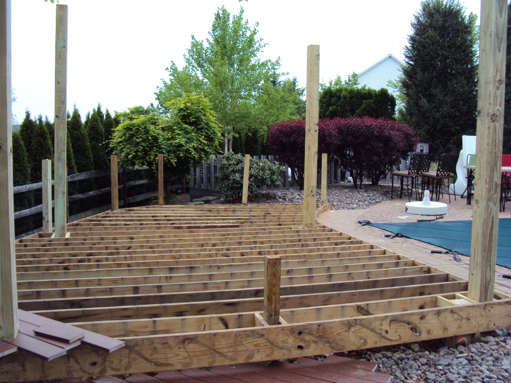

A low deck can be a cost-effective alternative to hardscaping, especially when the framing for a shade structure can be factored into the design.

I love building grade-level decks. They are faster to frame than elevated decks and usually don’t require guardrails. And when they’re freestanding, there are no ledger or lateral-load connections to deal with and no requirements for frost-depth footings. As a result, a grade-level deck is generally more cost-effective than hardscaping, at least in my northern climate. Even in areas where this isn’t the case, grade-level decks may be worth a slight premium, since they can be used to add visual interest and differentiate outdoor living spaces in ways that hardscaped surfaces can’t.
There is no standard height for a “grade-level” deck—the maximum measurement from grade to the deck surface could be 6 inches, 12 inches, 24 inches, or more. But generally speaking, I apply the term to decks that are up to 30 inches above grade, since guardrails are required for any decks that are higher than that. And while generally built like an elevated deck, a grade-level deck has some differences and specific issues that should be addressed when you’re designing and installing it, to avoid problems and make the most of its advantages. Of course, one downside to building a grade-level deck is that I’m bent over all day.

Ground-hugging decks—those less than a foot off the ground—probably aren’t going to use cantilever beams to support the joists; rim beams and in-floor beams make more sense. If you aren’t mounting a deck ledger, then you can orient the beams either parallel or perpendicular to the house. I tend to orient the beams perpendicular to the house so the joists run parallel. The decking can then run perpendicular to the house, where the dimension is usually less than a full deck plank length, eliminating butt joints.

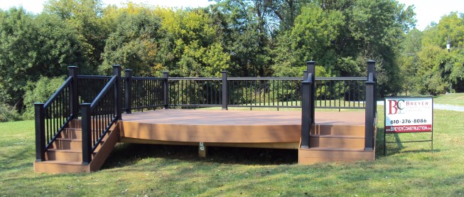

Guardrails aren’t required but may be a good idea on decks less than 30 inches above the ground. Stairs with four or more risers require at least one handrail.

Guardrails are not required on decks when the grade is 30 inches or less below the deck surface. Handrails, however, may be required alongside a stair. The IRC doesn’t mention a specific height above which handrails are required, but it does call for handrails on one side of stairways with four or more risers (2015 IRC, R311.7.8). That means that on a deck that’s 23 inches above grade, a stair with four 5-3/4-inch risers requires a handrail. Reconfiguring the stair with three 7- 11/16-inch risers eliminates the handrail requirement.
What if you frame a grade-hugging deck out of 2x6s and the client wants railing around the perimeter as a design element? Even when not required by code, a railing may have to comply with the guard sections of the building code if you install one anyway. My reading of 2015 IRC Section R312 is that a railing on a grade-level deck does not have to comply with the height or infill requirements of guards, and since the railing is not a guard, it probably doesn’t have to comply with the Minimum Uniformly Distributed Live Load Table R301.05.
If the grade slopes under the footprint of the deck, however, resulting in one edge that is greater than 30 inches above grade, then that edge of the deck would require a code-compliant guard. Most of the guard-post attachment methods (using metal connectors, or blocking and structural screws) that meet structural muster are designed with a minimum joist size of 2×8. Consequently, if you are framing the grade-level deck out of 2x6s to hug the ground at one end, you may have to change the joist size to 2x8s or larger as the grade permits in order to mount structural guardrail posts.
