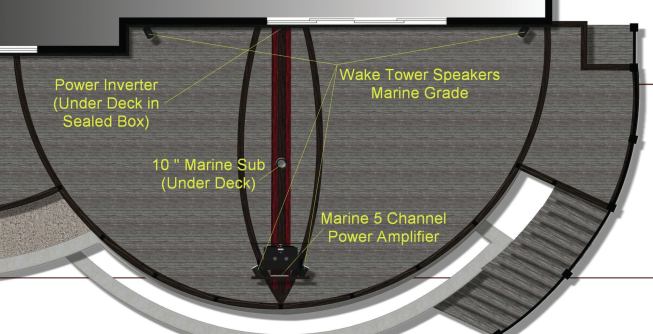

I like to start with a sketch of the layout that includes details about what the components and speakers will be, and where they’ll be located. When designing a system, my main goal is for the listener to be able hear the words or feel the mid-range, highs, and lows as the musician originally intended. If the sound quality is bad, music becomes fatiguing background noise.
Music also can be irritating to neighbors, especially if the sound isn’t evenly distributed to every corner of the deck. In this case, the tendency is to turn the volume up to have the sound to travel to those far-off corners. This leaves guests who are closest to the speakers unable to communicate with the people nearest them without raising their voices, which creates more noise. So the volume is turned up again, making matters even worse.
My approach is to distribute clear, high-quality sound evenly throughout the entire space. That way, everyone can hear the music while the overall volume stays at a reasonable level. To do this, I incorporate spaces within the deck design to locate components, speakers, and subwoofer enclosures.

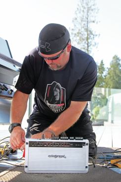

There are a number of quality marine audio components and speakers to choose from, but I now exclusively use Rockford Fosgate equipment for all of my outdoor installations. Not only is it well-built to strict tolerances, but it also looks great. On a recent project, I installed Rockford Fosgate’s RFBTRCA Bluetooth receiver connected directly to a Rockford Fosgate Prime M600-5 5-channel amplifier, both of which have coated circuit boards to prevent corrosion. A smartphone or other wireless device can be used as a music source for the system, because the receiver has a Bluetooth adapter. A device can also be connected to the receiver using a standard 1/8-inch audio cable.
A 110-volt-AC-to-12-volt-DC power converter is needed to power the system. To match the DC power supply to the components being used, I find the maximum current amperage draw needed by the amplifier (typically specified in the manufacturer’s printed or online documentation), and use that to size the converter. For example, this amplifier was rated at 70 amp max at 13.8V, and 35-amp average, so I chose a Progressive Dynamics PD9270 70-amp converter/charger to power the system. You can contact the amplifier manufacturer if you are not sure of how to determine the power requirements.

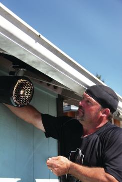

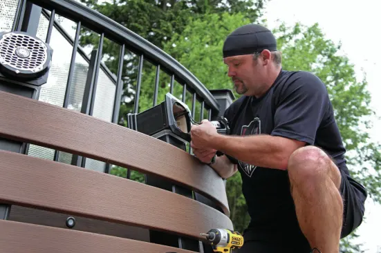

I also installed four 6-inch two-way Rockford Fosgate M262B-Wake M2 wakeboard-tower marine speakers. I like to be creative when installing speakers. I mounted these in the eaves, but sometimes I’ll mount them in a hollow post and drill hole patterns that allow the sound to escape. Because the grilles of these speakers look so good, I often leave them exposed.

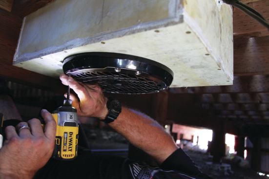

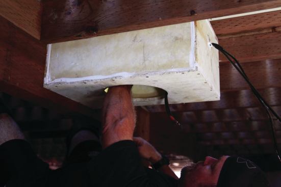

I concealed the Rockford Fosgate PM210S4B 10-inch marine subwoofer in its own waterproof enclosure, centrally located under a bench. To help calculate the proper amount of air space required in the enclosure for optimum performance, I used the manufacturer’s sizing app, called Woofer BoxWizard, which I downloaded to my smartphone.

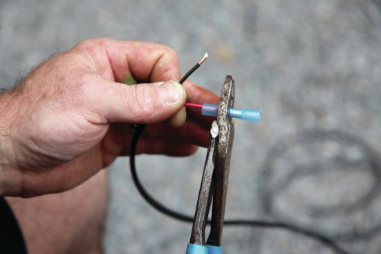

For best sound quality and reliable performance, I use quality 12- to 16-gauge direct-burial low-voltage wire or marine-speaker wire. Sizing information can be found on the Rockford Fosgate website.

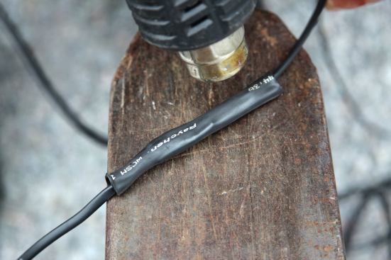

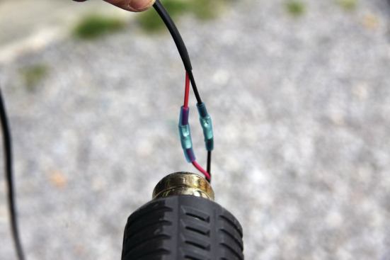

I make connections using heat-shrink butt connectors. For a bulletproof connection, I then apply more heat-shrink over the joint. All you’ll need to add to your tool kit are a good set of wire strippers and crimpers, and a heat gun to shrink down the connections and tubing.
