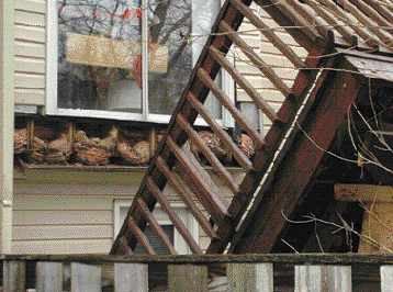

Readers of this magazine likely know how to safely secure a deck ledger to most houses. But what about the oddball situations? Can you attach a ledger to a concrete wall? What about to masonry veneer, stucco, EIFS, logs, SIPs, I-joists, or cantilevered floor framing? The answer is often nuanced, but sometimes it’s a flat-out “No.”
And it’s not just the mechanical attachment that makes for a safe, durable deck. “Flashing is as critical as the original design,” notes Frank Woeste, P.E., Ph.D., professor emeritus at Virginia Tech. Poorly detailed flashing or flashing (such as aluminum) that corrodes in short order when in contact with ACQ preservatives lets in water that rots the house framing. It doesn’t matter how many bolts you use to attach the ledger if the house framing it’s attached to rots away.
The advent of engineered floor systems also brought about some unanticipated (by carpenters, anyway) structural issues. As reported in the July/August 2007 issue of Professional Deck Builder (Decking News, “Siding Hides Warning Signs of Deck Collapse”), some early engineered floors used only 3/4-inch OSB as a rim board. Compound that with poor flashing, and you’ve got a recipe for collapse.

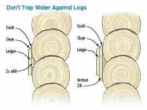

If you’ve ever worked on a log home, you know that it brings some interesting challenges to the table. The walls aren’t flat, for one, and to really grab your attention, you can count on them shrinking in height by as much as a foot, if green logs were used. Even so, veteran contributor Kim Katwijk, a deck builder in Olympia, Wash., says, “Logs are pretty easy.”
Katwijk explains that how you attach a ledger depends on the size and design of the logs: “West Coast logs tend to be big, say 18 inches in diameter, and there’s a large trough between them.” When the ledger needs to go in this space, Katwijk bridges the gap to create a reasonably flat surface with a horizontal 2×6 (Figure 5) or by custom-tapering a 4×6 for very long logs, which can vary in width. The ledger is then attached to the face of this horizontal shim.
Figure 5. Logs aren't flat and can't be effectively flashed. Bridging the space between the logs with either a horizontal 2-by member or vertical 2x6 standoffs makes a flat surface. Engineering might be required, as these attachments aren't described in the code.
Figure 5. Logs aren't flat and can't be effectively flashed. Bridging the space between the logs with either a horizontal 2-by member or vertical 2×6 standoffs makes a flat surface. Engineering might be required, as these attachments aren't described in the code.
It’s pretty much impossible to flash a ledger to a log home. You could cut a reglet (a slot meant to receive flashing) into the log above the ledger, but Katwijk believes capillary action is as likely to draw water in as the flashing is to keep it out. Instead, he tapers the top of the ledger, so water will drain away from the logs, and carefully installs the ledger so that no debris- and water-trapping pockets are created. He caulks the top of the ledger to the logs using a tripolymer caulk, inserting backer rod where needed.

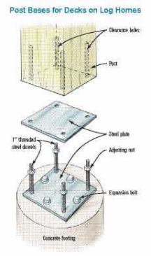

Another challenge is that logs settle as they shrink. New homes built from standing dead timber shrink the least, according to Katwijk, but they can still shrink several inches. The worst situation is a second-floor deck on a new home made from green logs. You can expect the supporting wall to shrink as much as a foot. In both these cases, the posts holding up the outside of a deck attached to a log home have to be made adjustable. Special hardware (Figure 6) takes care of such shrinkage, and you’ll need to have it engineered. The log home supplier should be able to provide an estimate of the amount of shrinkage to allow for.
Figure 6. Logs shrink; vertical posts don't. Decks attached to new log homes have to accommodate the expected shrinkage in the logs. Fabricated engineered post bases that allow adjustment as the logs settle solve the problem.

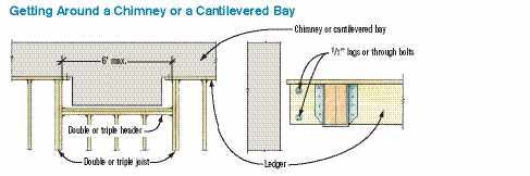

Attaching a ledger to cantilevered floor framing is generally forbidden by code — for good reason. Often, a cantilevered floor is pushed to its maximum load-bearing capacity just by supporting the existing loads. You can’t know this without an engineer’s evaluation. And even if the joists have some unused bearing capacity, it’s likely that the band joist on the cantilever, to which the deck ledger would be attached, is just nailed into the end grain of the joists. That connection isn’t adequate to support a deck (see photo, top of article). The band joist to which you typically attach a deck is supported directly by the house foundation.
It’s possible, but a lot of work, to pull the band joist off the cantilever, and slide the deck joists under the cantilevered floor to where they can bear on the house’s top wall plate or mudsill. The span design of these joists must take into account not only the typical loads from the deck, but also the load now imposed by the house floor, wall, and roof. And it’s practically impossible to prevent water from following the deck joists into the house and rotting it out.
In fact, the first deck job I ever did was replacing such a deck, as well as a good portion of the house’s walls and interior flooring. There were literally bushels of carpenter ants at work on that house because of the moisture damage caused by the deck. I’d avoid this approach like the plague.
If it’s just a small cantilevered bay, then framing around it isn’t very hard. Doubled or tripled joists on either side of the bay can carry a header, which in turn carries the framing beyond the cantilever (Figure 8).
Figure 8. It's a code violation to attach a ledger to either a chimney or a cantilever. Box framing around it is the solution, up to about 6 feet. A larger box-out may be permissible with engineering.

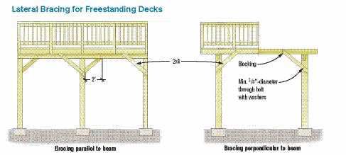

When properly constructed and attached, however, a ledger does help with lateral stability in addition to carrying part of the deck’s load. When building a freestanding deck, that lack of stability must be taken into account. Katwijk will often tie a freestanding deck to the house for this purpose, but Woeste cautions against doing so in the case of masonry veneer, explaining, “Using masonry veneer to resist any load is a building code violation.”
Figure 10. Freestanding decks require lateral bracing. Decks attached to the house with a ledger gain much of their lateral stability from that attachment. Diagonal bracing must make up for that lack on a freestanding deck.
A less controversial option is to diagonally brace the support posts (Figure 10). Most deck builders brace the outer beam on taller decks anyway, so the method is familiar. The main differences are that you’ve got two beams to brace on a freestanding deck, and that bracing must be run both parallel and perpendicular to the beams. On a deck that attaches to the house with a ledger, the ledger provides the lateral stability perpendicular to the beam.
