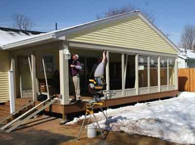

Installing the panels proceeds as shown in the photos. Note that there are typically two panels between each pair of support posts.
Paul Mantoni owns Exteriors Plus in Terryville, Conn.
1. The F-channels, upper and lower tracks, and H-channels — used to join aluminum storm-door panels together and to framing — are supplied long. Cut them to length using a chop saw; a standard trim blade works well.
2. Bed the base track in caulk and screw it to the decking. Attach the top track, which is deeper than the bottom one, the same way. Drill weep holes in the base track 3 inches from the ends and 16 inches on-center.
3. Measure each side F-channel separately to fit plumb between the top and base tracks. Screw the channel to the posts between the tracks.

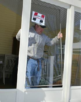

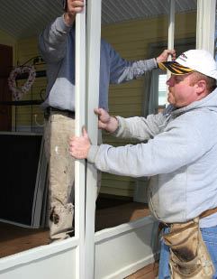

4. With the glass or screens removed to lighten the panels and reduce the risk of damage, join two panels with an H-channel that’s cut to fit between the top and bottom tracks.
5. Slide the pair of wall panels up into the deeper top track until they clear the bottom of the opening, then drop the panels into the base track.
6. Adjust both panels to fit evenly and securely in the H-channel and the F-channels.
7. Using the supplied screws, fasten the panels to the F-channels and the H-channel.
8. For the final step, install the glass or screens in the panels.
