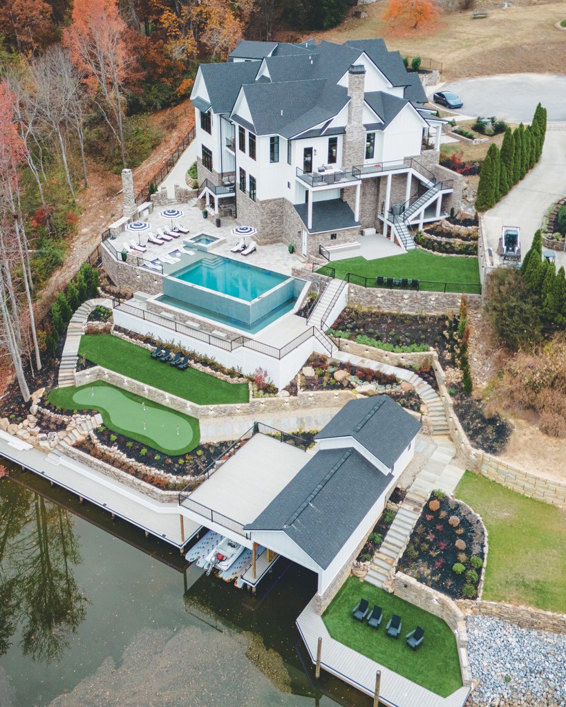

This lakeside building site drops 100 feet from the road to the waterfront. To optimize the lot, the author created three level tiers with a series of retaining walls and connected the tiers to each other with stone steps and pathways.

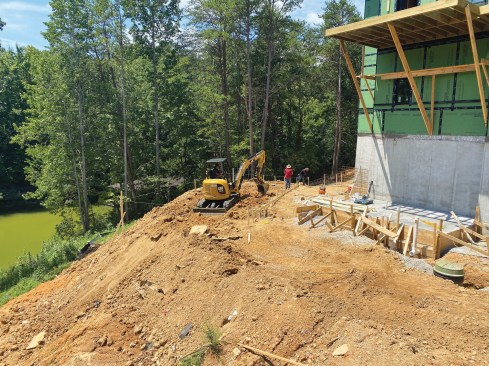

The project started when I broke ground on my family’s current home in Knoxville, Tenn., a few summers ago. The house itself came together beautifully—however, our local terrain is full of hills, and this property was no exception. We were faced with a steep hillside, with an elevation change of about 100 feet between the driveway of the house and the waterfront level in the backyard. This presented a significant logistical problem since there were homes on either side of ours, and we would need to transport all of our materials and building equipment in and out by barge.

Site work began while the house was still under construction.

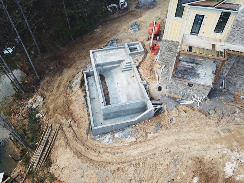

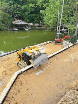

Early in the project, workers formed and poured the infinity edge pool.

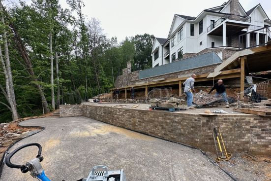

After the pool was in place, workers began the process of building the retaining walls and backfilling them with gravel and soil to create the two lower terraced levels.

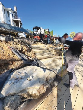

Here, the crew is installing the stone steps that connect the lowest tier to the dock system.

To break up the steep elevation and introduce the incline more gradually, my solution was to section the backyard into three tiers by using a lot of retaining walls and different levels. I designed each tier to include multiple entertainment zones that would serve a variety of functions and connected the tiers to each other with a few sets of stairs and some stone-paver pathways to help guide the flow of foot traffic.

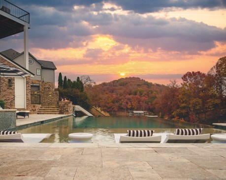

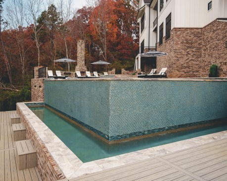

The highest tier of the backyard features the infinity edge pool, with a hot tub and spillover waterfall. We went with a travertine hardscape and incorporated Baja shelving and lots of LED lighting into the pool to make it swimmable at night. Past the hot tub, we installed a grilling area for cooking and barbecues. There’s a big fire feature on the corner of the pool—when it comes to pool design, I really think that fire and water go hand in hand.
The project required extensive hardscaping, along with typical wood-framed deck construction.
We created a lounging area on the second tier, with plenty of seating options thanks to built-in benches that were crafted using Deckorators Voyage decking, the same material that we used for the rest of the deck space. Matching furniture material with the deck material like this helps tie a design together and make everything feel cohesive.
Closer to the water are a miniature golfing area and a section of turf with some Adirondack chairs, followed by a boardwalk that leads to a covered dock. The dock itself is a full boathouse that can fit two jet skis, a small watercraft boat, and a large, 30-foot boat slip. On the rooftop of the dock, we added a 20-by-32-foot deck, again finishing it with Voyage decking. It’s a great place to hang out and take in the view.

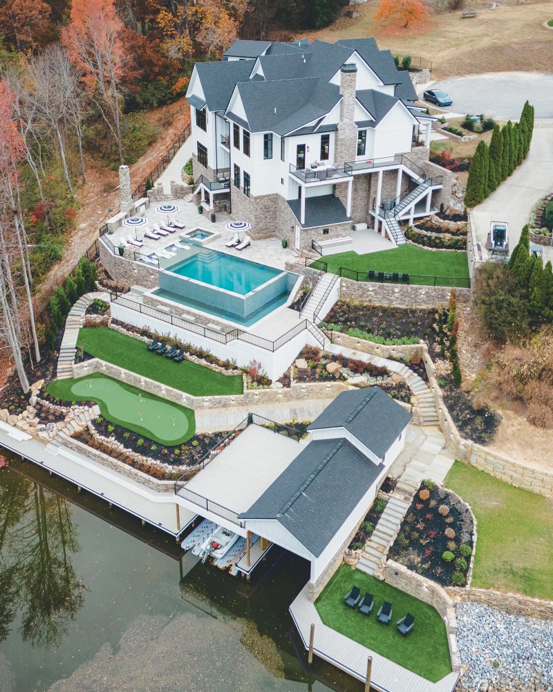

The infinity edge pool was designed to capture the feel of a seaside resort.
Ryan Hull/courtesy Deckorators

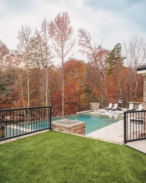

Though nestled into a hillside above a Tennessee lake (left), the infinity edge pool was designed to capture the feel of a seaside resort (above). For reduced maintenance, the landscape features artificial turf instead of natural grass, the extensive use of natural stone pavers, and—where appropriate, such as on the dock system—composite decking.

The only way to deal with such a dramatic drop in grade at such a short distance is to terrace everything. To maximize usable space, we built retaining walls at each level and then built the ground up to get the levels flat.
Stabilization is crucial on hillsides like this, and settlement issues can be completely devastating. To keep everything in place and make sure the house wouldn’t slide right down the hill, we installed helical piers throughout the backyard to reinforce the system of retaining walls.
With the lot being so steep, we had to make some adjustments to the construction process. For example, we pumped—rather than poured—the concrete all the way from the street level—11 times. We had to look into alternative methods to transport gravel down the hill and ended up using a gravel slinger. I’d never been around one before. It’s essentially a massive conveyor belt that loads the gravel up at the top of the hill and throws it down to the next level. In total, we used 330 yards of concrete and 3,600,000 pounds of gravel on this project.
