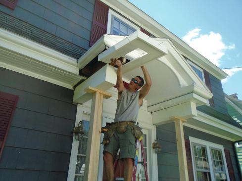

To fix the problem, I first removed the old beams—which had been framed like short knee walls and clad with board sheathing. I used PT lumber to frame new “knee wall” beams and clad them with PVC trim. Next, I assembled U-shaped PVC soffit-fascia assemblies and slipped them into place.

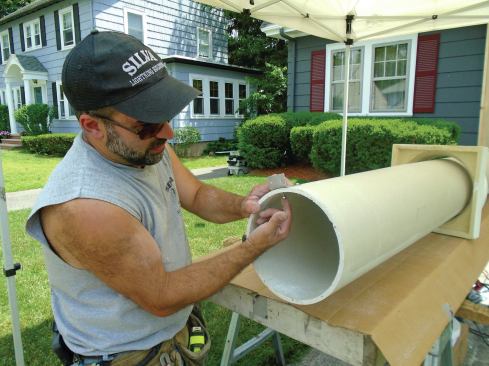

While the new columns are well-made and closely match the existing ones, they have one small flaw: an ornamental ring that I think is a couple of inches too close to the top of the column. My solution is to lower the position of the ring by adding a couple of inches to the top of the column with a PVC extension. This patch becomes invisible once it’s covered by the capital.

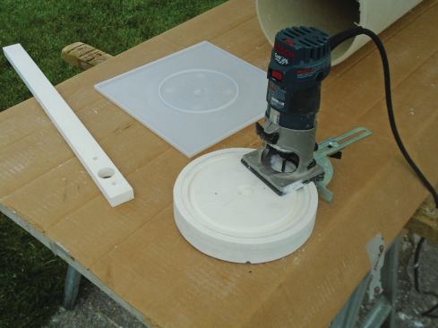

I started by gluing together 1-foot-square sections of 3/4-inch-thick PVC trim to make 1 1/2-inch-thick stock. Then I used a jigsaw to cut out a pair of round plugs that matched the inside diameter of the top of the columns. I fastened the plugs to the columns with screws.
Next, I cut a pair of slightly larger plugs to match the outside diameter of the columns and act as column extensions. Because these extensions needed to fit into the flashing cap (which prevents water and debris from getting into the column), I routed out a channel and center hole to match the flashing cap profile. Then I screwed the extensions to the plugs with stainless steel screws.

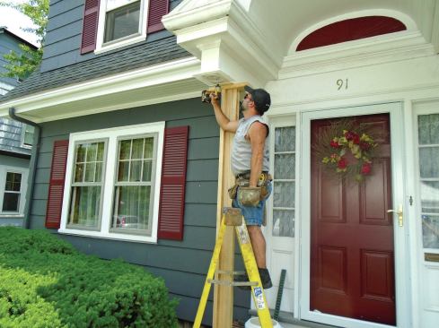

After shimming the porch roof assembly so that it was level, I located the column centers and used a retractable Tajima plumb bob to transfer the centers down to the brick porch. Since the floor was fairly level, I measured the distances between the porch and the eaves at each column location and marked the lengths on the columns.

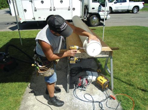

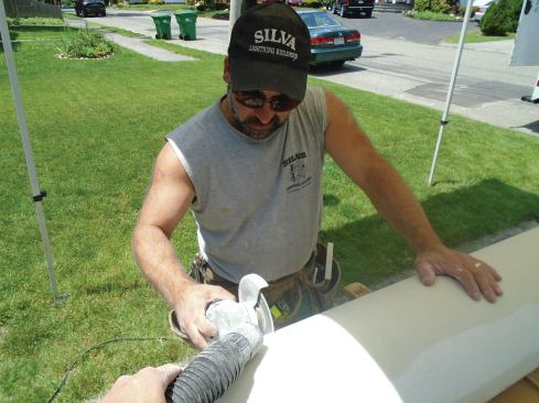

To mark cut lines that were square to the base of the columns, I rolled up a length of 4-inch-wide aluminum coil stock and wrapped it around the column to use as a straightedge. The manufacturer says that PermaCast columns can be cut with a carbide blade in a circular saw, but I find that the resulting edge is pretty rough. Instead, I make these cuts using a 4 1/2-inch angle grinder equipped with a diamond masonry blade, which results in a smoother and more controllable cut.

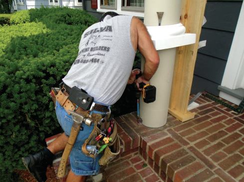

The installation kits that came with the columns included a pair of galvanized metal installation clips, along with screws to connect the clips to the columns. Because I was concerned about the screws eventually corroding or working loose, I substituted stainless steel bolts and nuts. That allowed me to bolt rather than screw the clips to the bases of the columns.

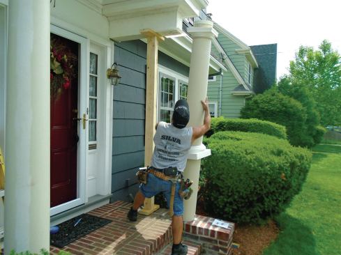

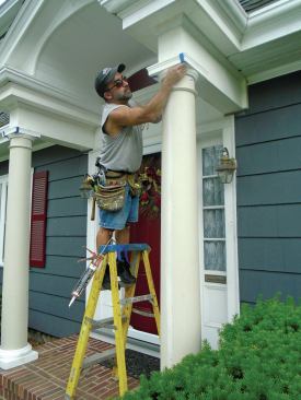

Before I fit the columns in place, I jacked up the porch roof assembly slightly so that they would slide easily into position. After screwing the flashing caps to the underside of the beams, I inserted the columns, then removed the shims and temporary supports so that the roof assembly was fully supported by the columns. In this installation, I wasn’t too worried about wind uplift, so I didn’t reinforce the connection to the roof framing with additional clips or long structural screws.
When I was satisfied that the columns were plumb, I drilled pilot holes into the brickwork, then fastened the brackets to the porch with 5/16-inch-diameter by 2 3/8-inch-long Tapcon masonry screws.
Finishing Up
To block moisture and insects, I filled the gaps between the column bases and the uneven masonry with a generous bead of OSI Quad Max, an extremely flexible window and door sealant. Then I applied a glop of sealant at each corner and set the column bases in place, tweaking the bases slightly until they looked square and level. I also glued the capitals to the flashing caps with the same sealant, using masking tape to hold the capitals in place until the sealant cured.
