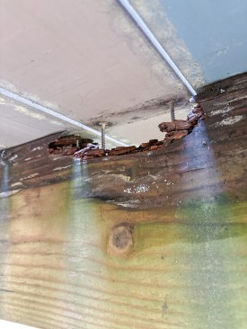

Advanced decay of joists and beam treated to “Above Ground” based on an available treatment tag. The tag did not indicate an AWPA Use Category System.

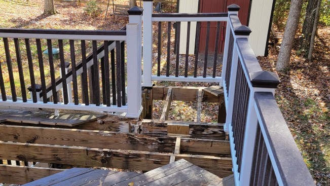

Collapsing decks—sometimes involving serious and even fatal injuries—continue to grab the headlines. NADRA (the North American Deck and Railing Association; nadra.org) estimates that nearly half of the more than 60 million residential and commercial decks in the U.S. are past their useful life.
Sometimes, the structural connections—think bolts, lag screws, engineered structural screws, ordinary decking screws, concrete anchors, joist hangers, and other structural connector hardware—are deficient due to a design defect or corrosion (rust), which alone can cause a deck element to fail without warning. But decayed framing system components, such as joists, beams, posts, footings, stairways, guard systems and handrails, decking, and treads, can alone cause or contribute to a collapse event. Of course, decayed wood coupled with a deficient connection can jointly cause a collapse event.
I believe that contractors can do more to extend the life of the framing on a new deck, avoiding costly repairs or deck replacement costs and—more importantly—preventing an unexpected early framing decay collapse event. My recommendation is to flash the tops of all joists, beams, and stair stringers to provide preservative-treated wood additional protection, and make sure that the framing can dry out.

Deck above shown after 10 years in service. The bulk of decay damage is where the top edges of joists are in contact with the decking. Such water-trapping joints accumulate water by gravity and capillary action and are slow to dry after a rainstorm since the top edge of the joist is not exposed to natural ventilation. At right is a different deck. Joists in-service also about 10 years were preservative treated to the “Above Ground” AWPA U1 Use Category.
Frank Woeste

According to Jim Mailey, a former training specialist (now retired) with Simpson Strong-Tie and author of NADRA’s “Decks Done Right” education programs, “There are numerous stories from deck builders that the framing is lasting 7 to 10 years before significant decay has shown up that can be seen without doing the pick test (which can detect early decay before it becomes visually evident).” Based on a concern for occupant safety as well as deck replacement costs, I believe that measures to enhance the protection of framing lumber without increasing the potential for fastener and connector corrosion caused by higher preservative retention levels are warranted.

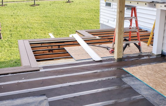

The PWT preservative-treated LVL framing has been flashed for additional protection.
courtesy Breyer Construction
Extending the Deck Service-Life
Flashing all joists, built-up beams, and stair stringers while providing free or unobstructed ventilation below is a simple way to address this uncertainty and extend the service-life of deck framing to as much as 25 years. A self-adhering, self-sealing flashing (not all peel-and-stick membranes are self-sealing) or a self-sealing coating that has been tested to meet the standards of AAMA 711 should be used over the tops of joists to prevent the entry of water around the decking screws or other fasteners used to install the decking. The expected service-life of the flashing is also important as the tops of all joists between deck boards will have some UV exposure, and the outside top edge of band joists and beams may have maximum UV exposure most of the day.

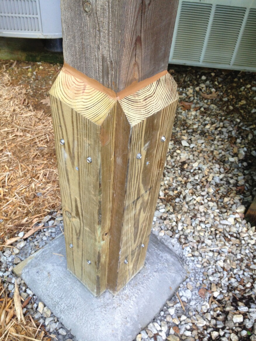

This UC4A-treated 6x6 southern pine post has been repaired using UC4B-treated 2x6 cleats and ¼-inch-by-3-inch structural fasteners. Note that the cleats as well as the concrete have been sloped to shed water.
Frank Woeste
This UC4A-treated 6×6 southern pine post has been repaired using UC4B-treated 2×6 cleats and ¼-inch-by-3-inch structural fasteners. Note that the cleats as well as the concrete have been sloped to shed water.
Built-up beams are especially vulnerable to water collecting in the gaps between members, which can be avoided by flashing the top of the beams. At least one manufacturer, PWT, which offers a preservative-treated LVL, has a requirement to flash all framing. Flashing for 2-by joists should be a minimum of 2 1/2 inches wide to ensure good coverage. Built-up nail-laminated beams (two, three, and four plies) should be flashed with a single width that is adequately sized to cover the entire assembly.

Posts. When deck structural support posts are embedded in the ground, AWPA recommends UC4B material, commonly known as “Ground Contact Heavy Duty.” About four decades ago, leading post-frame building companies switched to UC4B after experiencing early decay failures.
For UC4A or UC4B structural deck posts attached to a concrete slab or pier, a post-base connector that separates the post end-grain at least one inch from the concrete or standing water should be used. UC4B may not be available in retail outlets and require a special order. Note that with UC4B lumber, stainless steel hardware is recommended to avoid premature corrosion.

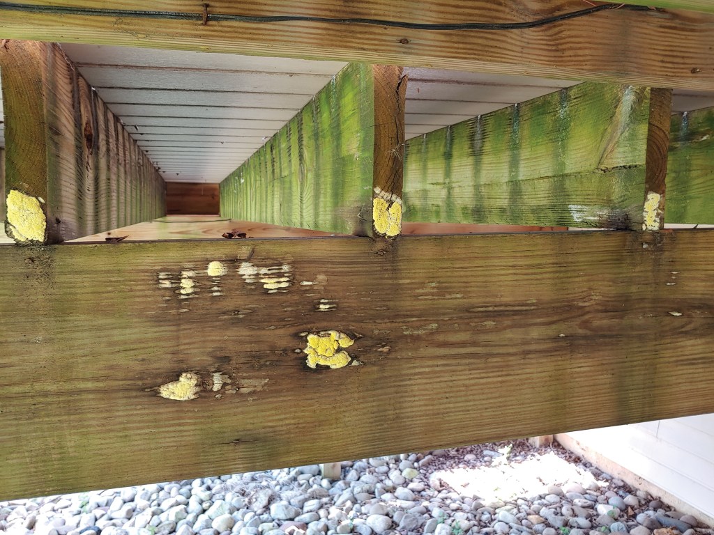

Flash and ventilate. Even when the tops of all joists and beam framing lumber are flashed, the installation of an under-decking water-management system that prevents the open, “natural ventilation” of the framing up to the flashed top edges will likely be counter-productive to preventing the decay potential of the framing lumber. For homeowners who seek a protected space under a deck, “above the joist systems” are available that prevent the framing system from being exposed to rain and snow water while not obstructing the natural ventilation of the joist framing below flashing. Wood structures that are protected by cover from the weather and well-ventilated are known to maintain a moisture content (MC) well below what’s required for fungal decay.
