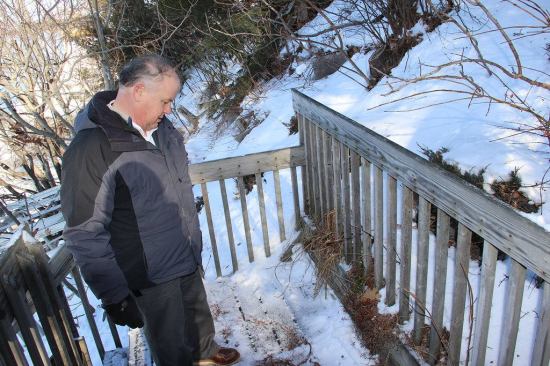

But Harold Bumby, the founder and owner of Maine Wood Treaters in Mechanic Falls, Maine, has a different point of view (see slideshow above). Bumby agrees that the old CCA got a bad rap, and he agrees that it worked beautifully in its day. But realistically, he says, CCA is gone and it’s not coming back. After all, while there is little if any solid evidence that CCA-treated lumber used in home construction is dangerous to homeowners or carpenters, the concentrated arsenic and chromium formula used to treat the wood could be extremely dangerous to workers at the treating plants — and spills at the facilities have been known to cause serious environmental cleanup problems. There are almost 60 wood-treating plants on the EPA’s list of Superfund sites. The government is not going to back off.

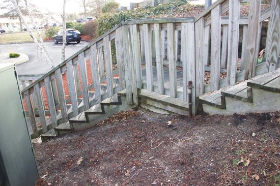

Jim Finlay has seen it. In one case, he says, he was under contract to replace just the decking on a deck built with the newer treated wood. When he looked at the stairs up to the deck, however, he found that the 2×10 stair stringers were rotten where they contacted the ground. “I told the owner we had to replace the stair framing, not just the treads,” he says.

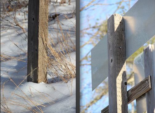

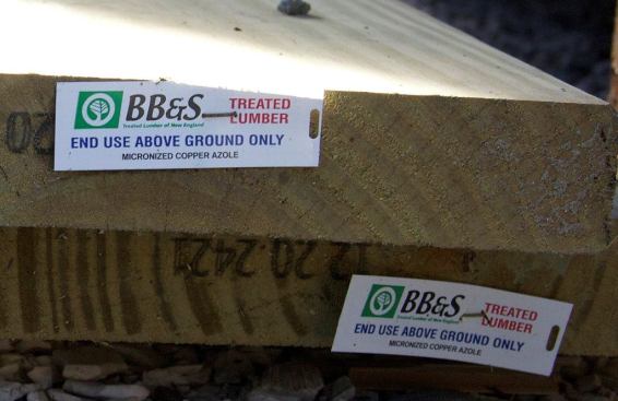

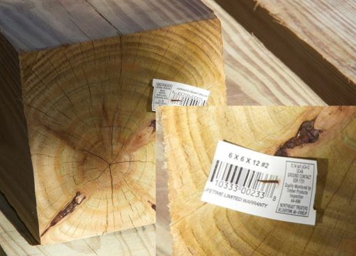

That problem is familiar to Bumby, and to managers who have to handle complaints and warranty claims at the companies marketing the major brands of treated wood. The problem, says Bumby, is that these days, treated 2x framing lumber isn’t made for ground contact. Bigger members, like 4×4 and 6×6 posts, get a higher dose of chemical (called “retention”) at the treating plant, and they can handle being buried (although installers should treat cut ends in the field with copper naphthenate). But 2x4s, 2x6s, 2x8s, 2x10s, and 2x12s are treated, rated, labeled, and guaranteed only for “above ground” exposures. You can leave them out in the rain. But you can’t lay them in the dirt.
Deck builder Finlay occasionally needs to build a three-banger 2×10 girder and set it into the ground for a wood deck built at grade. “But I can’t get a 2×10 or 2×12 rated for ground contact,” he says. “Nobody stocks it.” Executives at the major chemical companies agree — if you want a 2×10 stick treated for ground contact, it’s a special order, and you’ll have to wait a few weeks and pay a premium. “That’s just not practical for builders,” says one exec.

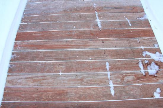

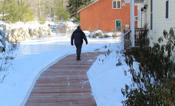

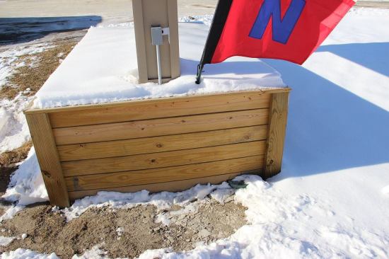

On a drive around his neighborhood in Maine, Bumby showed me a walkway built with 5/4 material treated at his own plant, installed at a house he used to own. The boards, laid directly on the ground, weren’t warrantied for that use. They still look good after five or six years, and Bumby is crossing his fingers. But Bumby says, “Look, I’m a wood treater myself. If it’s too complicated for me to get this wood in ground contact retentions, how can we expect contractors to do it?” One industry executive says, “Some of the people in the industry are saying, ‘we need to educate the end users.’ But I don’t think we can educate our way out of this.”
