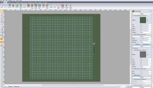

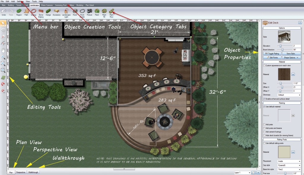

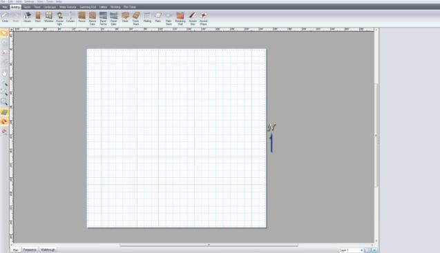

Plan view mode in Realtime Landscaping Architect (indicated in the bottom left corner of the screen) includes all the information shown in the screen shot above, such as the menu bar, object category tabs, and object creation tools. On the left side of the screen are icons for editing tools, view tools, and grid/snap on and off. On the right-hand side of the screen, all the information about a highlighted object is shown.

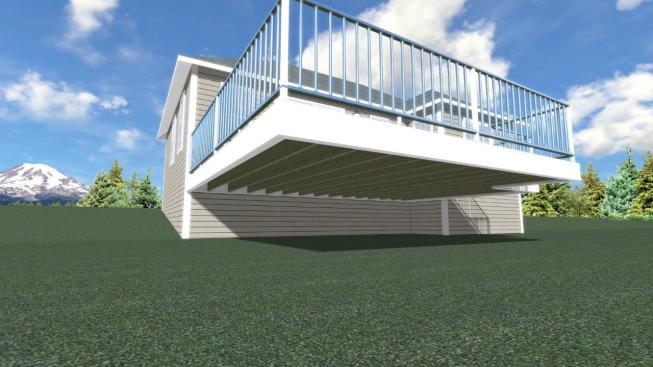

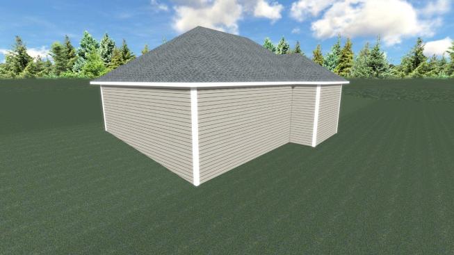

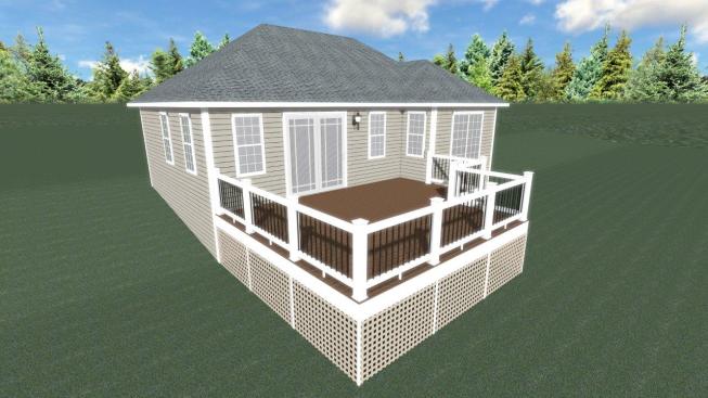

In the 3D rendering of the project (shown here is the Perspective view), shadows and other realistic environmental details are added. Some of the information contained on the Plan view screen (see image at the beginning of this story) does not show up on the 3D renderings in either Perspective or Walkthrough views.

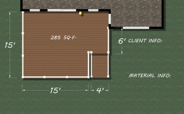

Then, when I’ve completed my design in Plan view, I have several options. If I want to send my client a Top view plan showing square footage, field measurements, material info, and other details, I capture what is displayed on the screen by clicking on the “Export Viewport to File” option in the File menu. Here, the quality of the image can be adjusted by choosing a higher or lower resolution.
You can create designs in either Plan view or Perspective view and easily toggle between the two modes—by selecting the desired tab at the bottom left of the screen—to add details and see how they affect the overall look of the design.

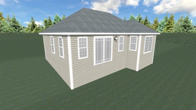

Renderings in 3D can be created in either Perspective view or Walkthrough view. In Perspective view (as in Plan view), you can capture an image by going to the File menu and clicking on “Export Viewport to File.”

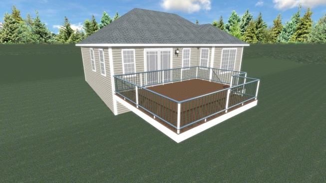

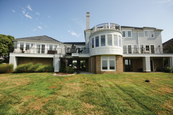

RTLA allows the user to import actual photos of the house, which the author can use to develop a design and prepare different proposals for his clients.

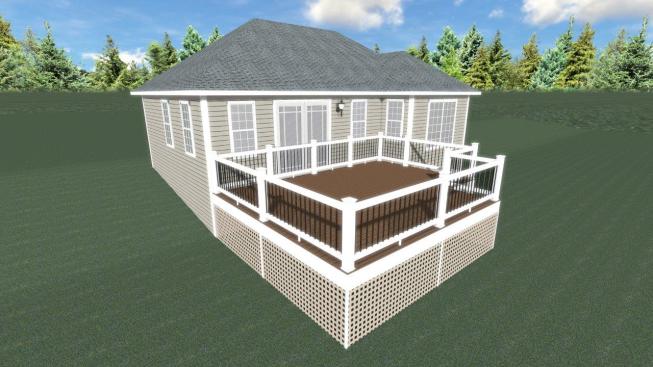

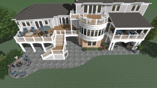

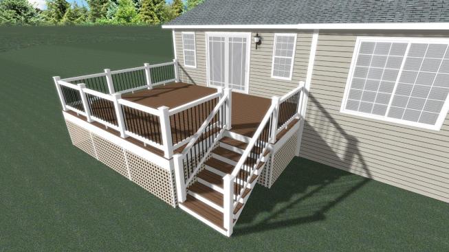

Realistic 3D renderings can be made in either Perspective or Walkthrough views (shown above is a proposed design for the house shown in the photo at left), allowing clients to visualize multiple design possibilities and finish options.

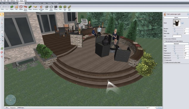

In Walkthrough view, you can the activate environment by choosing the time of day and adding a skyline and other features. In this dynamic view, you will see trees and shrubs blowing in the wind, light fixtures that are turned on or off, and even a flickering fire pit. ❖
