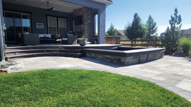

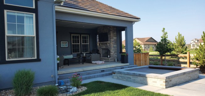

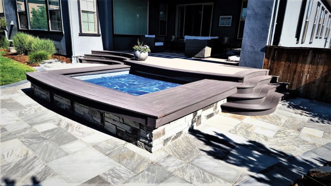

To me, however, the most alarming problem was the compromised transition from the back porch to the concrete walkway leading to the pool deck. Here, an in-ground hot tub was located, and while it was convenient to the house, the spa interrupted drainage, causing a puddle of water to form over a large area. Even worse, in colder months, any standing water would freeze into ice, creating a safety risk for our retired client.
BEFORE: The existing spa interrupted travel between the house and the pool, and water tended to pool around its base, freezing in winter and creating a safety issue.
AFTER: To provide better access and solve drainage problems around the spa, the author expanded the patio and porch deck and corrected the pitch when installing the stone overlay.

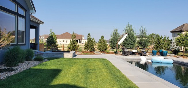

To correct the drainage issues, we did some grading work in the yard. We also installed additional drainage lines, using water catch basins and underground corrugated piping.
To divert water away from the pool, we added a stone overlay with the proper pitch to the pool deck. By locating thicker stones in the lower areas and thinner stones in the higher areas of the original flat work, we were able to resolve the patio grade without having to rely on an extra-thick mortar bed under the stones.

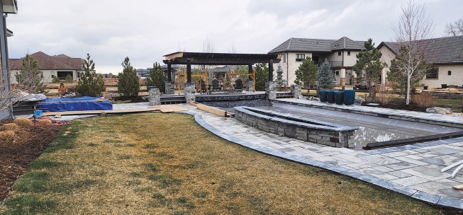

We also expanded the existing footprint of the pool deck by adding flat work to accommodate curved lines and seamless transitions across the project. This required excavating all the top soil to an 8-inch subgrade, adding 4 inches of compacted 3/4-inch road base, and pouring new, 4-inch-thick slabs doweled into the existing patio.
The stone overlay expands on the existing concrete and bridges these additions, hiding them from view with the pattern of the random ashlar layout of the stone.
BEFORE: Though it was recently built, the pool was plagued with drainage problems, including storm run-off during heavy rain events.
AFTER: The author addressed the drainage problems with new drain lines and re-grading, and with a new stone overlay pitched away from the pool.

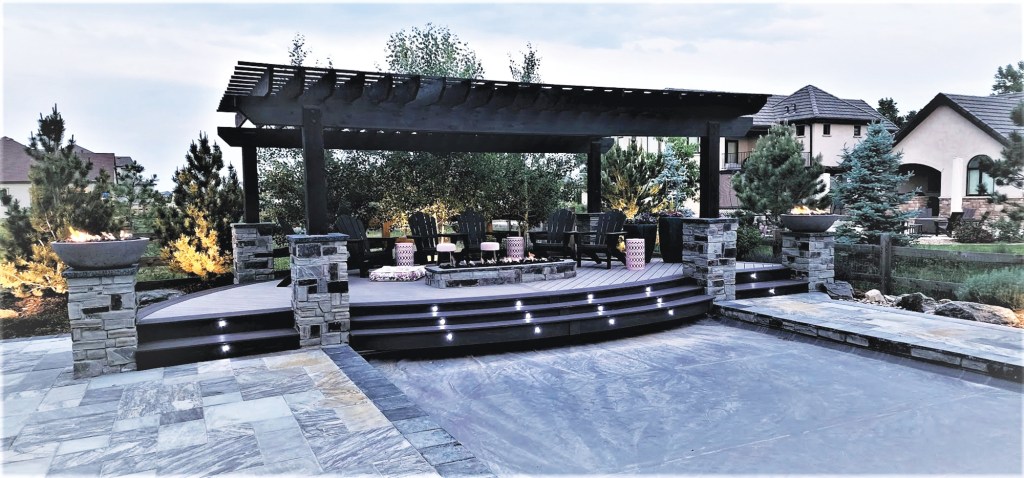

Curved Pool Deck
The new curved pool deck is the central element in our redesign. Supported by strategically located deck piers, the curved deck features a cantilevered step transition down into the pool and required an engineered design.
To execute the plan, we needed to core-drill through the existing concrete patio and carefully excavate to avoid damaging the buried pool utility lines when we were installing new piers. In a couple of cases, we had to adjust the pier locations to avoid those utilities, and we ended up adding a pier to the original plans.
Framing. We used Pacific Wood­tech (pwtewp.com) treated LVL engineered lumber to frame the flowing curves of the deck itself, but providing a 30-inch cantilever over the pool edge required the use of steel. Here, we used Trex Elevations steel joists, which were the right dimension to provide the 2-inch drop down below the pool’s coping edge (just above the elevation of the automatic pool cover) to provide a proper step down into the pool. Although Elevations has been discontinued by Trex, we were able to source the material through our supplier’s discontinued material pile.
A new curved deck that steps down to water level is the centerpiece of this pool rehabilitation project, located in Longmont, Colo. The deck is framed with 1 1/2-inch-by-5 1/2-inch pressure-treated Pacific Woodtech LVL joists 12 inches on-center, while the bottom step that cantilevers out over the pool is framed with Trex Elevations steel joists.
To provide solid support for the deck’s cantilever, we bolted a 2-by pressure-treated resting plate to the pool apron using 1/2-by-7-inch wedge anchors. The distance of the cantilever support required us to bolt to the existing concrete patio surround. The step depth needed to be 5 feet overall to have a 20-inch cantilever, per engineering. Cutting, welding, and shaping the hard material allowed us to make sure the pool’s auto cover would still be able to operate under the stair edge.
The pool deck’s design focal point is a symmetrical arrangement of fire features. The linear fire pit, centrally positioned, serves as an inviting gathering spot. A pair of flickering stone fire bowls flank either side of the deck on top of raised stone columns and contrast with the lush backdrop to create a visually striking yet harmonious structure. Together, the fire features extend the space’s usability into the cooler evening hours.
Similar stone columns and carefully selected black-stained 8×8 western red cedar posts support the 20-foot-dead-span pergola. We used 5 1/8-by-16-inch Alaskan yellow cedar for the beams and red cedar for the rafters.
Material selections. We used Timber­Tech decking in the company’s coastline hue, harmonizing its warm undertones with the TimberTech dark-hickory accents to create a cohesive transition between the deck and adjacent pool area.

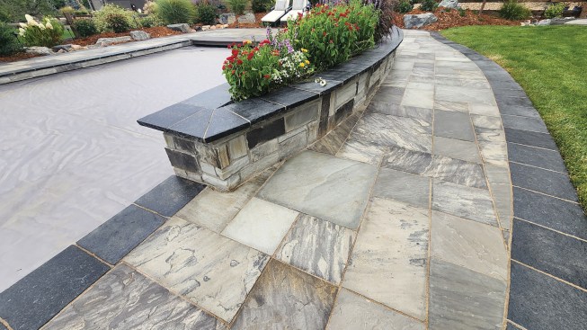

The author widened the existing concrete patio around the pool to make room for this curved planter, then installed a natural stone overlay in a random ashlar pattern, using a combination of different thicknesses of stone set in a mortar bed to correct the pitch so that water now drains away from the pool instead of into it.
For the pool deck’s stone overlay, we used three colors of a natural stone imported from India and supplied by Stone Universe (suistone.com). The main colors are ebony (the swirled-color stone) and grey mist (the light gray stone), while the dark gray border stone is called dark slate (see photo, above). To correct the pitch in the existing pool deck (as described earlier), the stone ranged from 1 inch to 2 inches in thickness. In addition to correcting the pitch as we installed the stone, we tried to blend appealing tones in a random pattern encompassed by a solid-color border to mimic the appearance showcased in the deck.

Porch and Spa
At the house, we bridged the existing raised concrete patio to the spa with the same TimberTech decking used on the pool deck. We fastened the decking to Deckorators sleepers screwed to the concrete with 1/4-by-4-inch Tapcons. We also built an elegant curved staircase using heat-bent deck boards. This improved accessibility to the built-in spa and echoes the flowing curves of the pool deck.
Access to the spa was improved by extending the porch with new TimberTech decking installed over sleepers fastened to the concrete and adding wider curved steps on either side of the spa.
