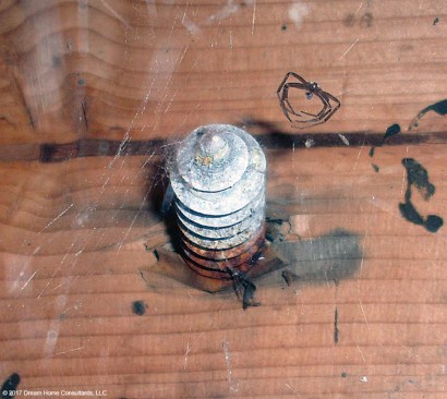

Q. While working on a kitchen renovation project for a client, I was asked to take a look at his deck. He had noticed that a few of the galvanized lag screws used to fasten the ledger to the house had developed some rust and wanted me to replace the rusty screws. Is it OK to put the replacement screws in the same holes, or will the potential pre-existing rust and corrosion in the hole promote early rust on the new ones?
A. Bruce Barker, a licensed contractor and certified ICC inspector who owns Dream Home Consultants, in Fernandina Beach, Fla., responds: First, determine if it is necessary to replace the screws. If the surface rust can be easily removed and if the deck ledger and the band board/rim joist inside the structure appear to be in good condition, then it is usually acceptable to leave the lag screws in place. You should advise your client to monitor the screws and the wood for deterioration and to replace them if the deterioration becomes significant.
If the rust is deeper than the surface or if the deck ledger or the band board/rim joist is deteriorated, then replacement is recommended. Installing new fasteners—whether screws or bolts—in existing holes is not recommended, however, especially when screws are involved. If the fastener is rusted where you can see it, the wood around the fastener may be deteriorated where you can’t see it. It doesn’t take much wood deterioration to decrease the load-bearing capacity of the wood and to decrease the withdrawal resistance of the fastener.

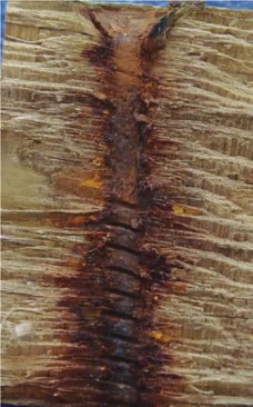

Bruce Barker/Dream Home Consultants Iron and hydroxyl ions released from corrosion (above) chemically attack the cellulose components in wood and cause loss of strength and structural integrity of the joint. Shown in the photo at right is ACQ lumber embedded with a zinc-coated screw and exposed at a site in New Zealand for three years.
Mark Jones/BRANZ

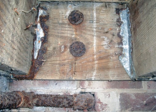

Assuming that the wood in both the ledger and the house framing that it is fastened to appears to otherwise be in good condition, the recommended procedure is to fill the existing holes in the ledger so that they are watertight, then install new fasteners in new holes.
If you install new fasteners, be sure to leave enough distance between the old holes and the new ones. Good practice is to locate fasteners at least seven fastener-diameters from other fasteners (3 1/2 inches for a 1/2-inch fastener). You also need to maintain at least 2 inches of clearance between fasteners and the top and sides of the ledger, and a minimum of 1/2 inch between a fastener and the bottom of the ledger.
Fastener holes can be a water infiltration point. Check the ledger flashing to be sure it is properly installed.

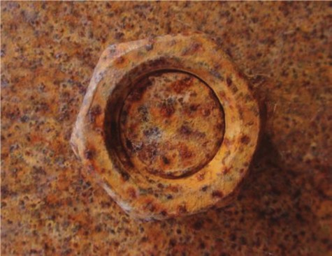

While this mild steel nut exhibits considerable surface corrosion, it is still structurally functional.
Mark Jones/BRANZ While this mild steel nut exhibits considerable surface corrosion, it is still structurally functional.
Bruce Barker/Dream Home Consultants When corrosion is extensive, new lag screws or bolts should be installed in new holes in the ledger, and the old holes filled to prevent water intrusion.
