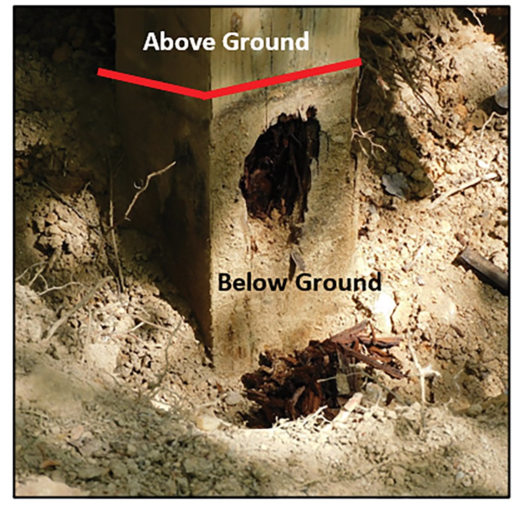

A 10-year-old embedded post treated to the level of UC4A has prematurely decayed where the wood is below ground.

This last category is of particular note, as IBC Section 1807.3 states: Embedded (sawn timber and round timber) posts & poles shall be treated in accordance with AWPA UC4B. While this is commercial code, it helps guide what is best practice for embedded wood.

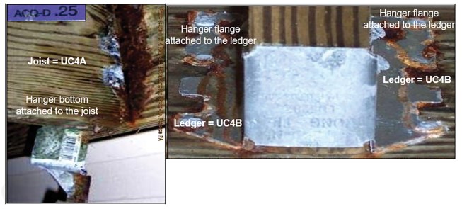

On a deck built after CCA was discontinued for residential use, a joist treated to the level of UC4A did not corrode the joist hanger; however, the ledger, treated to UC4B, caused significant corrosion in less than six months.
The deck pictured above was one of those decks that had corrosion problems. Though the wood for the ledger and the joist came from the same batch of lumber from the same lumberyard at the same time, the part of the hanger flange attached to the ledger was corroding after six months, whereas the hanger bottom in contact with the joist wasn’t. A chemical analysis of the wood by Simpson Strong-Tie showed that the copper oxide content for the ledger was 0.579 pcf, or UC4B, and the copper oxide content for the joist was 0.335 pcf, or UC4A. Researchers found higher levels of copper oxide in the wood than what was listed on the tag, which stated 0.25 pcf, or UC4A, for this ACQ-D-0.25 treatment. Inconsistent levels of the chemical treatment during the transition year resulted in premature hardware corrosion only where the retention levels were greater than UC4A.
Stainless steel is recommended when the chemical retention level is greater than 0.40 pcf for ACQ-Type D or the treated wood is rated at greater than or equal to UC4B. Therefore, if you would like to embed a post in soil, the wood should be treated to UC4B and the hardware used should be stainless steel.

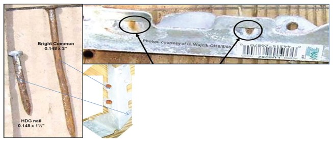

Zinc from the hanger was sacrificed to protect the uncoated, bright common nail on a one-year-old deck. Where a hot-dip galvanized (HDG) nail was used, there was no transfer of zinc between the nail and the hanger.

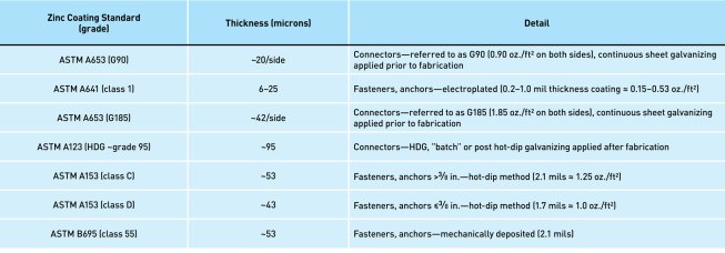

Generally, the more zinc, the better resistance the material has to corrosion. Fasteners should have the same level of zinc or an equivalent corrosion resistance as the connector they’re in contact with. As you can see from the table above, when you use a connector galvanized to the level of ASTM A653 (G185, which denotes a coating thickness of 42 microns) you should use a fastener or anchor galvanized to the level of ASTM A153 (class C or D) or ASTM B695 (class 55) as a minimum because these fasteners will have the same or thicker coating level.
The table above shows levels of zinc coating needed to resist corrosion on fasteners and hardware used with PPT wood.

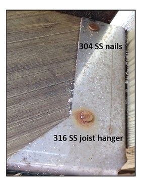

The 304 stainless steel nails are corroding after one year of being near the coast and exposed to chlorides. The 316 stainless steel joist hanger shows no signs of corrosion.
The code states “stainless steel” but does not recommend a type of stainless steel in the section referenced above. To choose the correct type of stainless steel for a specific application, we need to look at the types available and their performance levels. The most common used in construction are Type 304 (typically nails, some connectors and anchors), Type 305 (typically screws), and Type 316 (fasteners, connectors, and anchors). Types 304 and 305 stainless steel are less resistant to applications that involve chloride-type corrosion. The addition of molybdenum to Type 316 gives it superior performance in environments containing chlorides (salts), and this type of stainless steel is considered to be adequate for hardware near the ocean or in applications that are exposed to chloride-type corrosion (see photo, above). The Cedar Bureau recommends 316 stainless steel within 15 miles of salt water.
Type 410 stainless steel (used for some screws and concrete screw anchors) is optimized for hardness. It comes in two grades—one has a coating without a barrier that is recommended only for interior, noncorrosive applications, and the other has an additional coating or barrier that offers a moderate level of corrosion resistance.

The table on the previous page shows that ASTM A653 (G185) (typical trade names include Zmax for Simpson Strong-Tie and Triple-Zinc for Mitek) designates hot-dip galvanization under a continuous galvanizing process but prior to fabrication. Based on ASCE 24, connectors would have to be “batch” or post hot-dip galvanized to ASTM A123, for which designation the zinc is applied after fabrication. The one word “after” in the standard changes the requirement from ASTM A653 (G185) to ASTM A123. Or you can use stainless steel. In some cases, 316 stainless steel may be a less expensive option than using post hot-dip galvanized connectors.
