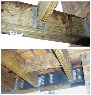

The span called for a three-ply beam, but the carpenter installed only one continuous ply (top). The engineered solution was to add a 1/4-inch flitch plate with twelve 1/2-inch through-bolts (bottom).
QUESTION & ANSWER
I’ve been asked to repair a built-up beam where a splice is not over a bearing point. How can I do this?
Glenn Mathewson, a certified Master Code Professional, Combination Inspector, and former deck builder, responds: It sounds like you understand that all beam splices must be over bearing points. Section R502.6 of the 2006 International Residential Code (IRC) specifies “the ends of each joist, beam or girder shall have not less than 1.5 inches of bearing on wood or metal …” Fortunately, this does not mean you have to get out the chainsaw and tear the job down.
The first consideration is whether the beam can make the span with only the remaining plies. Section 502.10, “Framing of openings,” allows a single header to carry other joists when the span is 4 feet or less and the header is the same dimension as the joists it carries. While this section applies to header beams at floor openings, the concept is the same: a spanning member carrying other members. If you’re lucky – that is, the problem beam is 4 feet or less in length and one ply is fully supported on both ends – you can simply write off the spliced ply.
Another option would be to install an additional ply to the side of the beam that’s fully spanning; you may need to increase the post size so the new ply will have full bearing at the ends. If you have to install the new ply on the side with the bad splice, the fasteners must extend through the spliced ply and into the full-length ply. A 16D nail wouldn’t be long enough to make this shear connection, but through-bolts or lag-bolts would be both long and stout enough. As always, you should check with your local inspector before doing the work.
If the above ideas aren’t feasible, you need to consult a licensed design professional – an engineer or, in some states, an architect. An engineered repair could be as simple as a report stating “no repair required.” It may also be as easy as installing a strap across the splice and near the bottom edge of the ply, carrying the tension the bottom of the beam is under. Larger mistakes, however – like the beam shown in the top photo – may require a more involved repair. In this case, as can be seen in the bottom photo, a 1/4-inch steel flitch plate was required to be installed on one side, with a dozen 1/2-inch through-bolts – not fun or pretty!
