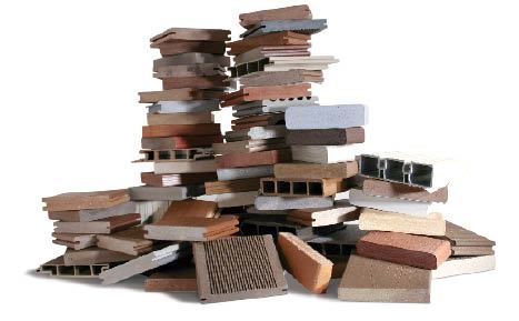

Recently, one of my deck clients showed me some samples from a local decking supplier. There were a couple of composites, a new-generation capped composite, and some ipe and tigerwood. When I asked which she thought were the prettiest, she quickly pointed to the wood samples. When I asked her opinion of the capped composite, she said, “It looks like it’s got shiny paint on it.” Citing the benefits of the capping had little effect on her, so it seems that the quest for the perfect substitute for wood continues.
Manufacturers have made great efforts to earn top scores in looks while producing durable planks that will last decades with few signs of age. Early synthetics fell short of these goals. Some bore little resemblance to real wood; some faded and stained; some fell apart. While today’s synthetics are vastly superior to their predecessors, comparing synthetic decking products can make your head swim. It would be convenient if all synthetic decking products were created equal and the only variable was looks. Then making a recommendation would be a cinch: Just hold a beauty contest and install the winner. But synthetics are like restaurants: Each has its own guarded recipes and a unique decor.
