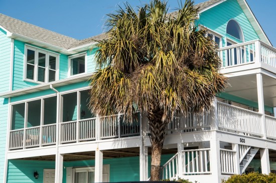

Traditional painted wood railings are still popular in coastal North Carolina communities, but they require regular maintenance.
Craig Scott Childs

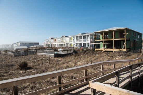

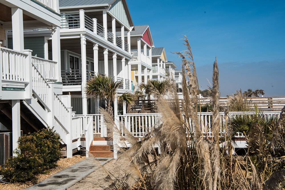

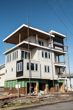

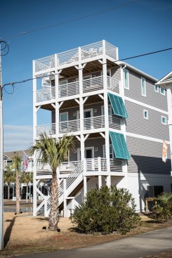

Oceanfront homes on the island are typically built with the decks facing the ocean to maximize views of the water. These decks are usually large and encompass the entire width of the home. Often, each level of a home is equipped with a deck, which unfortunately often results in a massive stack of decks.
To maximize outdoor living space, coastal homes on small lots often have multiple decks, resulting in a "stacked deck" effect.
Craig Scott Childs
A way to provide good outdoor space while avoiding the “stacked” effect is to incorporate decks into the floor plan of the home. Keith Bloemendaal, owner of Dutch Built Homes in Carolina Beach, says, “With lot sizes relatively small here, design is critical when trying to maximize outdoor living space. Everyone wants outdoor space. Good design is key to ensuring that space works with the home and not against it.”

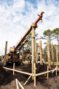

Along the oceanfront – or first row – the pilings are typically driven 16 feet into the ground, while the pilings for second- and back-row structures are driven a minimum of 8 feet. A machine-mounted auger is used to start the hole, and then the posts are driven into the sand with a drop hammer to the proper depth. A high-pressure mixture of water and sand is then used to compact the soil around the post.

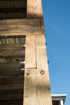

Cross-bracing with 2x12s bolted to the posts is required for pilings that support the main structure of a house and may also be required when the deck structure is integrated into the floor plan. If necessary, posts can be lap-jointed and through-bolted to accommodate multilevel decks. All of these critical connections are spelled out in prescriptive details that are widely followed by local contractors and enforced by local building inspectors.

Pilings can be extended with through-bolted lap joints, a common detail on elevated multi-story decks.

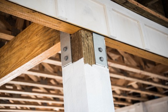

Uplift connectors that tie vertical and horizontal framing members together to resist high winds are required on coastal decks.
Pleasure Island is in a 140-mph wind zone. So while decks are built using details that most builders are familiar with, local code also requires the use of a lot of hurricane clips to prevent uplift. For example, trusses or joists in a 90-mph zone would need only one clip on each side of the framing member; here, you must either use clips on both sides of both ends of the joist or truss, or use a wrapping-style clip that catches both sides at each end.
I don’t think that code requires a specific type of clip, as long as it meets the approval of the local inspector. I have seen both heavy plate straps with through-bolts, as well as longer, lighter-gauge straps that can be bent around the framing and fastened with nails. Typically, straps are used to secure the subfloor to the pilings, while plates are used to fasten girders to pilings.
Careful attention to flashing details and weatherproofing are required when decks and balconies are built over living space. But this approach results in outdoor living spaces that are well-integrated into the home's floorplan.
Craig Scott Childs

You see more variety when it comes to railings. Most decks have low-maintenance composite, PVC, or metal railings, often with stainless steel cable or glass panels to maximize the views. Surprisingly, painted wood railings are also popular, keeping the painters on the island in business all year round.
