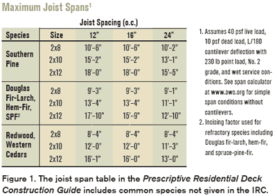

The IRC contains span tables that are often used for sizing deck joists, but these tables include only a few wood species, and they don’t account for wet-service conditions or incised materials, both of which may slightly reduce the materials’ structural capacity.
The Deck Construction Guide provides a simple joist span table that accounts for all these reduction factors and includes values for redwood and western cedars — species absent from the IRC’s span tables (Figure 1).

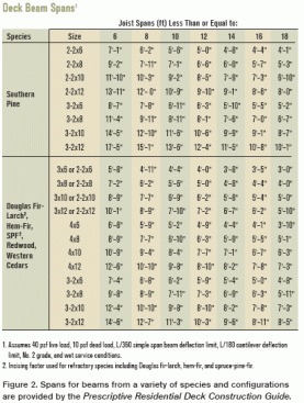

Span tables are also provided for multi-ply beams, from doubled 2x6s to tripled 2x12s (Figure 2). These tables are incredibly useful, and I imagine most jurisdictions would approve the spans with little question.
