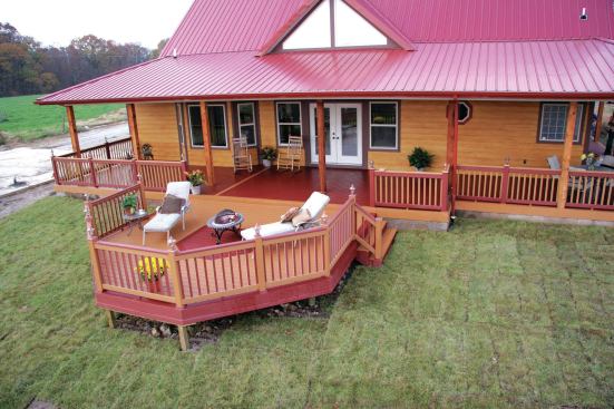

When your clients' friends and neighbors first see a deck you've just built, they probably don't exclaim, "We love what your contractor did with the footings and ledger! Can you give us his phone number?" But they will take note of an attractive, well-built railing, and that can drive sales your way.
You can spend hours sketching out custom railing designs—or you can save time by choosing a manufactured railing. Showing a building inspector a third-party evaluation report verifying that a manufactured railing is in compliance with the building code may also be a lot cheaper and easier than hiring an engineer to stamp your custom design.

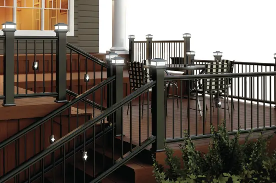

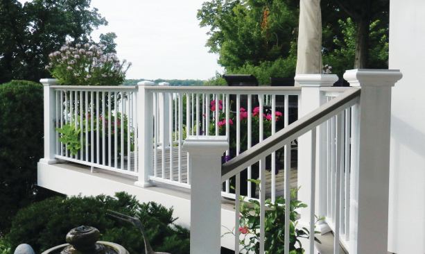

With manufactured railings, you can offer your customers a wide range of styles, from traditional to contemporary, without sacrificing ease of assembly. You'll find railing posts and decorative post caps in a variety of materials and colors, some with integral low-voltage lighting. If you still want to install 4x4 posts, you can buy finished post sleeves to slip over them. To reduce on-site work, many manufacturers offer pre-cut balusters and preassembled rail sections.
The kits are goof-proof (many are geared toward homeowners), with printed and online instructions and video tutorials to get you started, plus toll-free numbers for design assistance before you order—and for help later, when the process veers off-course. Each railing system has an assembly and installation learning curve, but once you get past it you should be able to complete a 6-foot section of railing, balusters, and rail cap in about 30 minutes, with no further sanding, sealing, or painting required.
To seal the deal with your clients, you can tell them that cleaning and maintenance requirements are minimal, especially compared with the regular scraping, sanding, and refinishing required with stained or painted wood railings. Vinyl or composite railings and powder-coated steel and aluminum balusters need only an occasional wipe down, if that. Tempered-glass panels might require some periodic cleaning with soap, water, and a squeegee, while stainless-steel cable railings have a marine pedigree and are virtually maintenance-free.

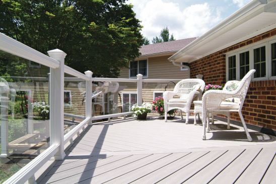

Some companies, such as Rail Simple (railsimple.com), Deckorators (deckorators.com), and Fortress (fortressrailing.com), make only railings. Most of the major decking brands, such as Trex (trex.com) and Latitudes (latitudesdeck.com), now offer railing systems that match or complement their deck boards. So if your clients have chosen a particular brand of decking, a good place to begin when discussing railing options is with offerings from the same manufacturer.

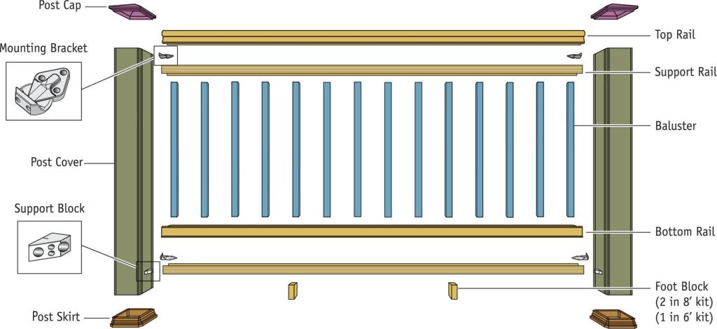

Manufacturers of railing kits often package and sell different components in separate boxes: top and bottom rails in one box, balusters in another, and top-rail caps in yet another. The reason—it's not to drive deck builders crazy—is to allow customers to choose different colors for rails and balusters.

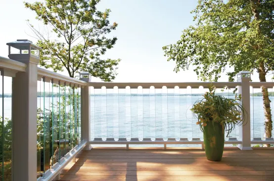

Some builders install rails from one company and balusters from another, or prefabricated rail sections or balusters with a custom-built wood rail. Mixing and matching rails and balusters lets you design a unique off-the-shelf railing. You can purchase top and bottom rails, and for infill, use horizontal cable, solid glass panels, or balusters in a variety of materials—man-made-composite, steel, aluminum, or even wood to match a wood rail cap.

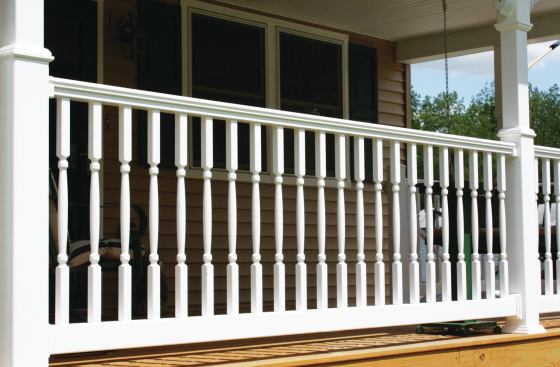

Compatibility. If you are playing matchmaker, check that the balusters and rails you choose actually fit together properly. Trex rails, for instance, capture balusters in pre-cut square or round holes, depending on a baluster's cross-section. The balusters for Azek's Reserve Rail System (azek.com) are fastened to the top and bottom rails with through-screws that grip a chase at the end of each baluster.
"Make sure to get exact dimensions, especially if you're getting balusters from one company and rails from another," says Paul Boehlke, general manager of online retailer DeckBuilderOutlet.com. "For example, the round balusters from Rail Simple are usually 1/16 inch smaller than the standard 3/4-inch diameter."
David Elenbaum, owner of both the Deck Store of South Carolina and DeckMasters, an installation company based in Greenville, agrees. "Companies talk about interchangeability, but one's balusters might be 26 inches long and another's are 29 inches." Making on-site modifications to prefab components that you thought would simply snap together will quickly eat into profits.

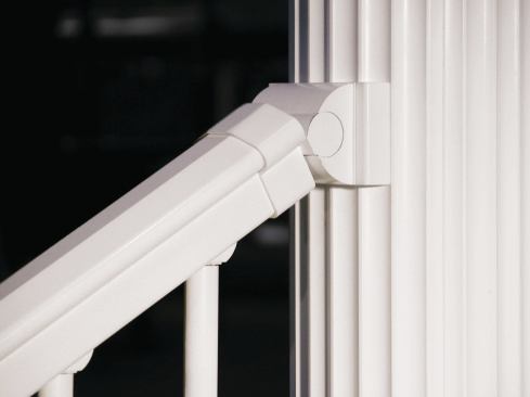

Unfortunately, there are no standardized attachment systems; each company's baluster-to-rail and rail-to-post attachments are a little different. Some are unobtrusive or hidden, while others are bulky and highly visible, especially some of the adjustable-angle brackets used on stair railings.
Posts. Manufacturers offer framing-mounted and surface-mounted posts, as well as post sleeves that fit over 4x4 posts you've installed. Before setting any posts, check the deflection-code specs on the lengths of manufactured rails you intend to use.
Rails. Some materials—especially composites—can meet deflection codes only if they are shorter than 8 feet. To allow rails to span greater distances, some manufacturers reinforce them with steel or aluminum channels.

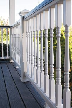

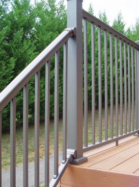

Balusters. To simplify maintenance, many builders incorporate low-maintenance round or square-channel powder-coated aluminum or steel balusters into their site-built rails. Round balusters can always be insert-mounted, but many manufacturers also offer connector inserts to allow surface mounting. Square balusters are often predrilled so they can be face-mounted. Bowed, ogee-curved, or filigreed metal balusters are also usually face-mounted and offer a different look, while tempered-glass balusters or panels can be fit into channels in the top and bottom rails or into special brackets.
Gwatney and Elenbaum agree that black and similar darker colors are the most popular baluster colors, especially for decks with a commanding view. Gwatney says, "We sell a ton of black balusters with light colored rails."
Stair railings. Running a railing system along a stair requires special mounting brackets, some of which can be adjusted for the stair's run. If the balusters are captured in a rail, you'll need to cut them to the stair angle. Balusters that are installed on the face of a rail are usually cut square on the ends. How a railing system will accommodate a stair run varies by manufacturer.

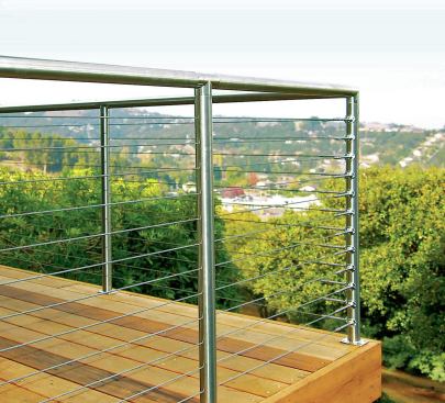

Cable Rail Systems

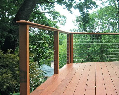

For years, cable-rail detractors claimed that horizontal balusters made it too easy for kids to climb up and over a railing, and building codes used to prohibit them in certain applications. However, in 2008, after much testing, the so-called ladder-effect prohibition was eliminated, allowing cable rails in most jurisdictions. Of course, allowable construction details are at the discretion of your local inspector, so it's worth a call to find out what gets a green light, as opposed to a red ball, in your town.
Several companies sell complete pre-designed systems that include fascia- or surface-mounted posts, top and bottom rails, lengths of cable, and the necessary hardware. Such manufacturers offer in-house design and planning assistance that's only a phone call or mouse-click away. More commonly, contractors install wood posts and complementary top and bottom rails, then string cables through the posts (see "Installing Cable Railings," November 2011).
Most cables are made of stainless steel, though some companies offer aluminum ones. Cables are held captive at one end post, run through (or surface-mounted on) support posts on approximately 3-inch centers, and tightened at the other end post with a threaded tensioner. Cylindrical metal sleeves tapped into each wood post's cable hole prevent chafing. While some companies have corner hardware, allowing cables to take a turn, others require a new cable run and two end posts in the corner for each direction change.
The cost of material and hardware depends on the number of end posts as well as the length of the railing. The end-post hardware costs about $25 for a pair, depending on the brand and retail outlet. Bulk 5/32-inch stainless steel cable costs about $.75 per foot and a 36-inch-high railing requires seven to nine cable runs. Therefore, a straight 50-foot-long, eight-cable run of railing with two end posts would require eight pairs of end-post hardware ($200) and 400 feet of cable ($300) for a total cost of about $500. A similar length of railing but with one right-angle corner (and thus four end posts) would require 16 pairs of connectors and cost about $700.
