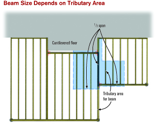

Figure 1. Calculating the tributary area for a point on the deck is not difficult. On your structural layout, draw dashed lines that halve the joist and beam spans. Follow the supporting path for each area back to the component in question and multiply by the pounds per square foot designed for — usually 50 pounds per square foot of live and dead load. In this example, notice the area of deck supported by the middle span of one beam. Depending on the size of the tributary area, this beam may need extra consideration.

All the forces applied to a structure ultimately end at the earth, and a load path is how they get there. You stand on the decking, it’s supported by the joists, by the beam, by the posts, by the footings — this is a load path, and it’s different for each and every point on the deck.

Decks that aren’t simple rectangles often have concentrated loads within the framing system. A ground-level deck can be supported by a bunch of posts on each end, making the framing simple. With upper-level decks however, a forest of posts may not be acceptable, which leads to complex framing where beams support other beams. Many decks like this are built without any real consideration of the load path through those beams, other than just doubling every member that carries another. But to ensure the structure is safe, the load path should be examined and the tributary load for each beam end and post should be determined (Figure 1, page 26). This is important for sizing not only members, but hangers and foundations as well.

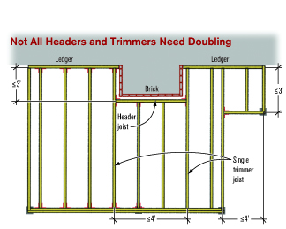

Section R502.10 of the 2009 IRC provides some guidance and limitations in regard to beams supporting beams. Provided the spans for the selected joist size are within the limitations of the span tables in the IRC, a single member can act as a beam (header joist) up to a maximum 4-foot span. This can work well for a small stair landing or framing around a narrow brick chimney. You also must consider at what place in the span the first beam (header) connects to the second beam (trimmer). If a 4-foot or shorter header is connected within 3 feet of the trimmer’s bearing location, the trimmer can also be a single member (Figure 2).
Figure 2. For framing around chimneys or floor cantilevers and for framing a stair landing, the IRC has some clear allowances. When using single trimmers, the maximum span between them is 4 feet, and the header must be within 3 feet of the trimmers’ bearing points. Doubling the header or trimmer members can get you greater spans.

Beyond those limits, the IRC requires both beams — header and trimmer — to be doubled and “of sufficient cross section to support the floor joists framing into the header.” Without an analysis of the loading, you can’t know what size beam is necessary to support the floor joists. The more complicated the deck, the more complex the load path, and the more crucial it becomes that a calculative analysis be performed.
