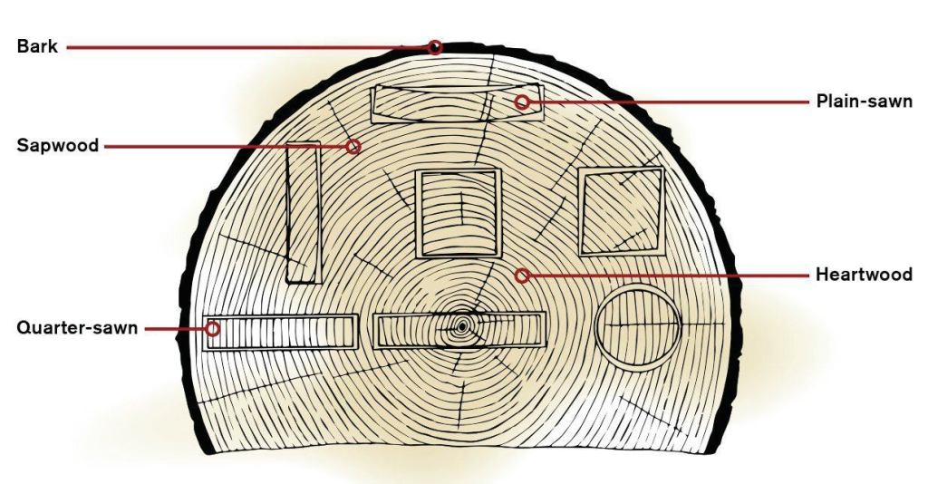

Heartwood is at the center of a log’s cross-section and is usually darker in color than the surrounding sapwood. Heartwood is not “living” wood; its job is to support the tree. As a tree gets older and larger, storage cells in its center die. Various natural chemicals collect there, providing decay resistance—the degree of which depends on the tree’s species, growth site, size, and age.
Sapwood is the part of the tree between the heartwood and the bark. Its main purpose is to transport water and nutrients through its cells from the roots to the leaves. Each year a new layer of wood, continuous from roots to crown, grows around the existing wood (and creates a new tree ring). Sapwood in lumber is susceptible to decay and needs treatment to endure in outdoor service.

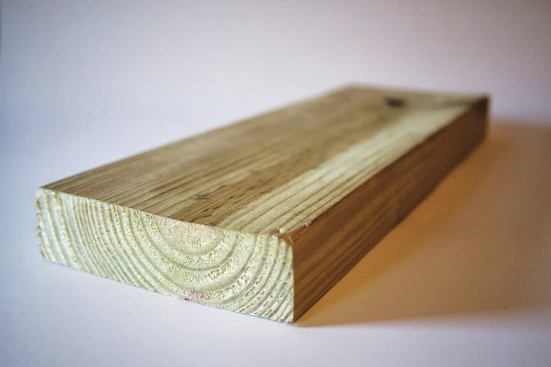

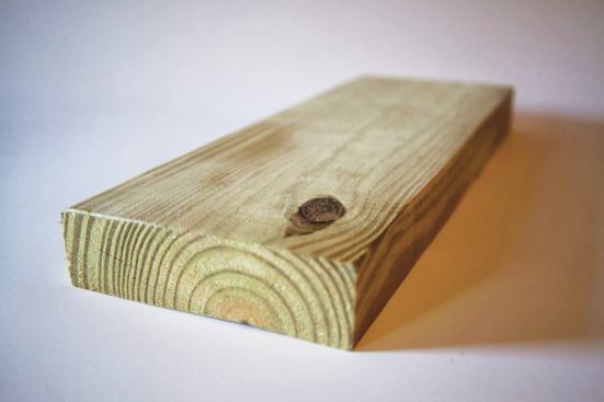

Plain-sawn lumber (also called flat-sawn) comes from the most common method of sawing logs, which produces the widest boards with the least amount of waste. Plain-sawn boards have a cathedral-grain effect on their faces and a fairly flat arched pattern on the ends. The annual rings range in orientation from being almost parallel with the face of the board to being at an angle of 70 degrees.
Quarter-sawn lumber has a nice straight grain, or vertical grain, on the face. The grain pattern on the ends will range from running perpendicular to the face of the board to running at about 60 degrees from it. Quarter-sawing produces more waste than plain sawing, resulting in higher costs, but quarter-sawn lumber is more resistant to warping with changes in moisture content, and much more stable. In addition, it accepts stains better and more uniformly than plain-sawn lumber and is less prone to checking. If it were always available and in the homeowner’s budget, all my decks would be built with quarter-sawn lumber.

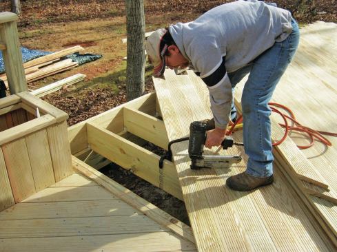

I fasten down all decking, regardless of moisture content, that I’ve installed over the course of the day. Otherwise, it may swell or shrink slightly overnight, changing the size of the gap.

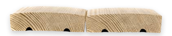

Cupping. Decking cups when the moisture content on the top surface is different than it is on the bottom. This is especially a problem for decks built in full sun (because the sun dries out the top surface) or low to the ground (where the bottom absorbs moisture from the ground). One way to minimize this problem is to mill flat-sawn or plain-sawn 5 1/2-inch-wide boards with a 1/8-inch crown. With vertical-grain decking, I recommend a 1/16-inch crown.
Peeling. While deck boards can cup no matter which way you install them, peeling often results when the decking is installed bark side down. This is because the pith side on the bottom surface is prone to shelling, especially in trees like southern pine that have dense latewood growth rings. Also, on the bark side of the board there is more sapwood—which accepts preservatives and stains more easily than heartwood. For these reasons, lumber should always be installed bark side (outer tree rings) out, or up, even though that face may not be the better-looking one. As an old carpenter once told me, “The outside of the tree should face the weather.”

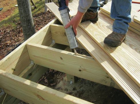

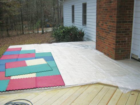

There are a couple of extra steps I take for porch flooring that I usually do not take for deck floors. When installing tongue-and-groove or shiplap porch flooring, for example, I apply an exterior wood adhesive to the floor joists before fastening the boards, to help keep the flooring secured to the joist. I glue down only one board at a time, which allows me to use my board bender in case a board needs to be pulled tightly.
Once the porch flooring is installed, I cover it with plastic and rubber mats. The plastic keeps water off in the event of rain, to help prevent swelling, while the mats protect against the dents or scratches that could result from something being dropped on the flooring while the porch roof is being installed. The mats also shade the flooring from the sun—which could otherwise prematurely dry out the flooring and cause shrinkage and cupping, especially in the dead heat of summer—and they make for a nice cushion while we’re working on the ceiling and roof.

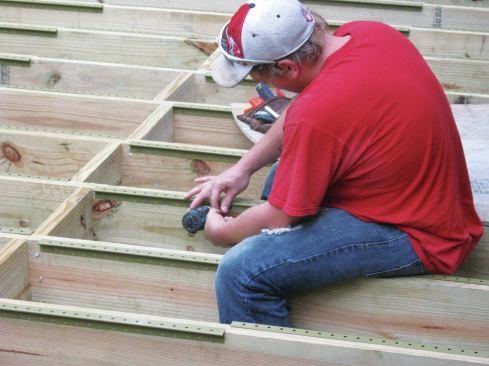

Your choice of fastener is as important as—if not more important than—your decking selection. I never use small trim-head screws with wood decking that will be exposed to full sun, especially when installing ipe or any decking that hasn’t been milled with a crown. Instead, I fasten the decking down with #10-diameter screws with larger heads, which helps prevent the decking from cupping. PAM (pamfast.com) and Muro (muro.com) make collated stainless steel screws for their fastening guns that require no pre-drilling even in dense exotic hardwoods like ipe.
We don’t often use nails anymore, but when we do, we have had fairly good success with hot-dipped galvanized ring-shank nails or Duo-Fast’s (duo-fastconstruction.com) 3 1/4-inch screw-shank nails. Screw-shank nails from other manufacturers don’t seem to hold as well.
When installing our custom-milled shiplap porch flooring, we use 7/16-inch crown stainless steel staples. We shoot the 2 1/2-inch-long staples into the grooves that are milled into the decking, so they’re virtually invisible.
The only hidden fastener product that seems to work well with wood decking is Grabber’s Deckmaster system (grabberman.com). It’s not the quickest one to install, but it has performed well on the several decks I’ve used it on. I do not use hidden biscuit systems with wood decking; I have seen too many failures, including on decks built with exotic hardwoods.

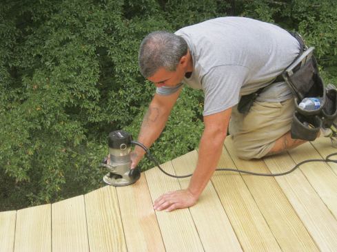

I usually cut decking so that it extends 1 1/2 inches past the outer band, then rout the decking with a 1/2-inch-diameter round-over bit. Besides softening the edges and giving the deck a stylish look, routing the edges and ends of boards can prevent splintering as well. I also rout the edges and ends of my rail cap, splices in decking, bench seating, arbor support posts, and any other item that may come in contact with hands or feet.
Sanding often gets overlooked by deck builders, but it’s very important. I keep an orbital sander and belt sander readily available by my saw horses to smooth out areas where it looks like a splinter is getting started or where the grain has raised, or to eliminate an ink mark or other imperfection. And if the decking or flooring cups a little at the end of the project, I sand the floor down before staining it.
