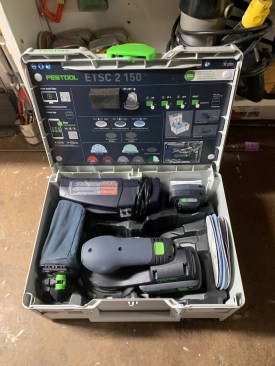

In addition to the sander, the kit included a TCL 6 charger, two 18-volt, 4.0-amp/hr, Bluetooth-enabled batteries, dust bag, plastic pad protector, 5mm Allen wrench, and a bit of sandpaper (see photo, below). For testing purposes, Festool sent along its Granat D150 starter set of six 10-packs of grit sizes ranging from P60 to P320.
Tom O'Brien
The ETSC 2 150 cordless sander kit comes in Festool’s Systainer SYS3 M box.

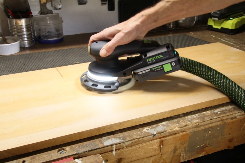

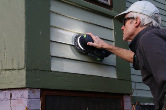

If one feature stood out—truly deserving the cliched title “Game-Changer”—it would be the LED ring light (see photo below). Unlike the tiny spots that most cordless tools feature nowadays, this one is a flood. I fell in love with it while I was scrambling to finish an exterior paint prep job before nightfall, only to discover with the push of a button that nothing could stop me now. That wasn’t even the best part; when I turned the sander loose on shop work, the shallow angle of light served to highlight the slightest swirl mark or imperfection. No longer would I have to reach for a flashlight to make sure I didn’t miss anything.
At full power, this light was blindingly bright. By pushing the on/off switch twice, I was able to cut the intensity in half. Once I became familiar with Festool’s smartphone app, I discovered that I could control a large number of options—including the length of time the light remains on after the tool shuts off—using the touchscreen.

The author found the built-in light a stand-out feature. Note the removable edge guard.
