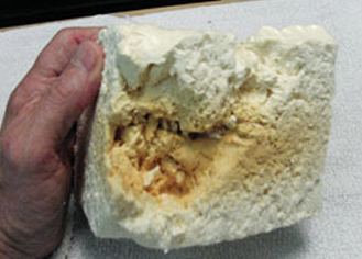

Good foam requires the correct combination of heat, pressure, and spray-gun configuration. Getting just one of these factors wrong can result in poor cell structure and dimensional instability, leading to such problems as shrinking and cracking, voids and fissures, and poor adhesion.
In addition, the liquid “A” and “B” components in SPF systems are designed to be mixed in a 1:1 ratio by volume (within 2 percent). Off-ratio “A”-rich foams tend to be hard, friable, and brittle, while “B”-rich foams tend to be soft and gummy and are more likely to have a high odor. Off-ratio foams can occur when the liquid components haven’t been properly stored within the temperature range specified by their manufacturer — typically between 60°F and 80°F in a dry environment — or when the components are contaminated or out-of-date.
Faulty spray equipment can also lead to off-ratio foam. Sometimes, one of the two transfer pumps that send the “A” and “B” components to the proportioning pump fails, causing a crossover that can fill the spray gun and sometimes the whip hose with off-ratio or even reacted foam. If the proportioning pump fails to properly heat and pressurize the components to acceptable levels before pumping them in separate hoses to the spray gun, the foam may not get hot enough to react properly. And if the spray gun is dirty or the nozzle too large, the components won’t mix well in the gun’s mixing chamber when the installer pulls the trigger.

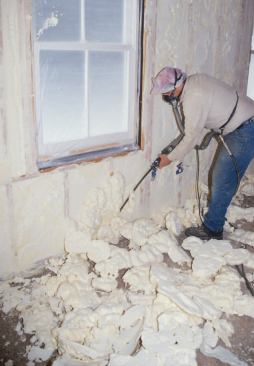

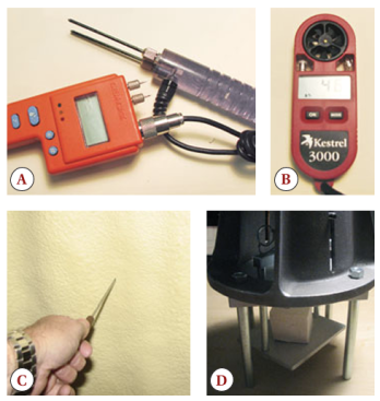

SPF can be sprayed on wood, concrete, metal, asphalt, foam sheathing, and other substrates. But the substrate needs to be clean and dry — “paintable” is a reasonable benchmark — for the foam to adhere well. SPF shouldn’t be installed when temperature and humidity levels fall outside the range recommended by the SPF manufacturer.
Moisture. When a surface is wet or damp, the moisture acts as a blowing agent that reacts with the “A” side of the SPF system, resulting in off-ratio foam with poor physical properties and poor adhesion. When foam is sprayed on wet framing or sheathing with greater than 19 percent moisture content, for example, there’s a risk that the foam will have poor cell structure and won’t bond well when the framing dries, leading to cracks between the foam and framing. For this reason, the spray-foam industry recommends that installers measure substrate moisture content with a moisture probe before applying foam — but many of them don’t.
Safe moisture content is relatively easy to determine in wood, but trickier to do in masonry. Concrete may appear to be dry yet still hold quite a bit of moisture that will be brought to the surface during foam’s exothermic reaction.
Currently, the SPF industry doesn’t have any specific moisture-content recommendations for concrete, beyond allowing for a 28-day curing time if it’s green. Some coating manufacturers consider MCs as high as 85 percent acceptable for paint, but I think this number is too high for foam. To be safe, tape an 18-inch by 18-inch sheet of clear plastic to the concrete, making sure it’s sealed on all four sides. If condensation appears on the plastic or if the surface of the concrete darkens after 16 hours, the concrete is too wet for foam.
An experienced installer will often just spray a small section of concrete to see if the surface becomes damp and reacts with the rising foam. If it does, he’ll wait until the concrete dries out before continuing to spray.
Temperature. While there is some variation among manufacturers, most SPF systems are designed to be installed when substrate temperatures are higher than 55°F. A few low-temperature foams can be used in colder conditions, but they’re the exception. With most foams, spraying when temperatures dip below 55°F (or below the manufacturer’s recommendation) can lead to the formation of a high-density shellac-like coating on the surface of the substrate that reduces the adhesive quality of the foam. In some cases, the foam can actually separate from the substrate, because of the difference in temperature between the two materials.
Humidity. When relative humidity levels are high, moisture can combine with the liquid components of rising foam and affect the foam’s cell structure. To avoid problems like low density, low compressive strength, and too many open cells, foam shouldn’t be sprayed when the ambient temperature is within 5°F of dewpoint. Since dewpoint is based on relative humidity and air temperature and can vary widely over the course of a day, these conditions should be measured and recorded a few times daily with a humidity and temperature gauge, such as a Kestrel 3000 (800/891-8493, kestrelmeters.com).

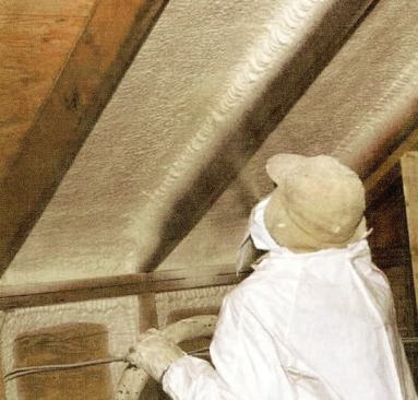

Once spraying begins, it’s a good idea to check foam regularly for quality, thickness, and yield, particularly when temperatures are cool or the humidity high. Quality-control samples — taken periodically during the job by either the installer or the GC — can indicate problems with foam thickness, adhesion, and cell structure, and can help document that a foam installation meets specifications.

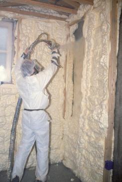

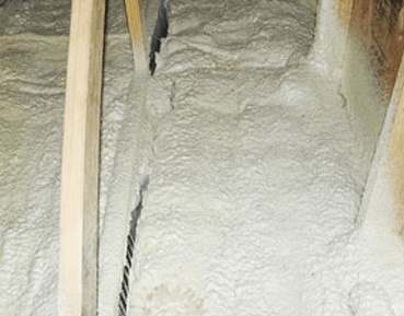

Lifts for closed-cell. To avoid problems, closed-cell foam should be installed in lifts less than 1 1„2 inches thick, with breaks of about 10 to 15 minutes between lifts to allow exothermic heat to dissipate. A certain amount of exothermic heat is needed to properly cure SPF foam, but excessive heat can result in cracks and shrinkage. Unusually strong odors after foam application can be an indication of this problem.
A good rule of thumb is to size the spray gun’s mixing chamber and nozzle so that passes overlap by more than 60 percent. This will allow the foam to grow at a uniform rate from one side to the other during a lift. When spraying studwall and ceiling cavities, for example, the installer should picture-frame the cavity, allow the foam to set a few minutes, and then fill in the middle, spraying parallel to the direction of the studs.
On a masonry wall, an experienced installer should be able to spray 2 or 3 inches of closed-cell foam in two or three lifts within a 1/4-inch tolerance. In framing cavities, the variation is typically greater due to the thicker application against rafters or studs.
One shot for open-cell. Half-pound SPF is typically installed in a single lift, starting at the bottom of a studwall or ceiling cavity and working up. To prevent gaps and voids, hard-to-reach areas or spaces behind the studs are usually picture-framed first.
You can expect considerably more thickness variation with open-cell foam due to its greater expansion rate. A 1/2-inch tolerance when spraying 3.5 to 5.5 inches of foam would be considered exceptional, while a more typical 1/2-pound foam installation would have a 3„4-inch to 1-inch tolerance between studwall cavities. As a result, trimming is usually necessary after the foam has been sprayed.

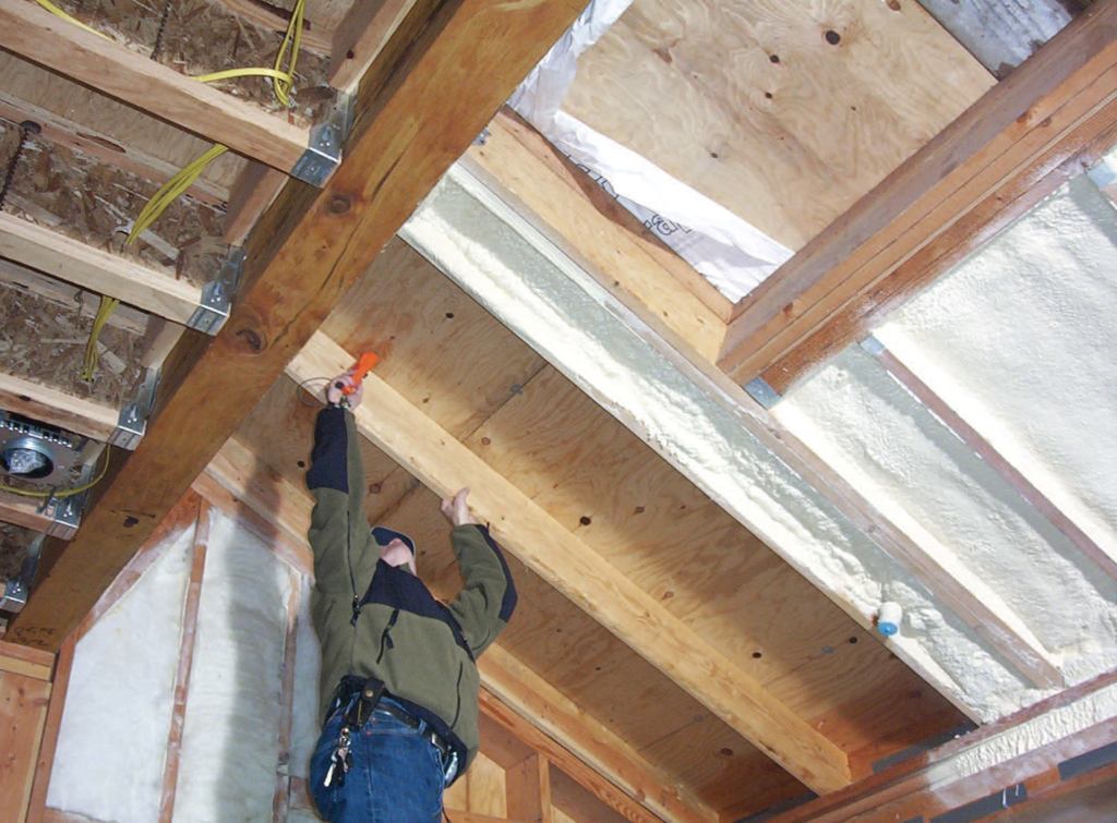

Ideally, every completed SPF installation should be inspected, by a manufacturer’s representative, an owner’s representative, or a third-party inspection company. (For a list of inspectors accredited by the Spray Polyurethane Foam Alliance, call 800/523-6154 or go to sprayfoam.org.) With the cost of a third-party inspection on most residential projects ranging from $1,000 to $2,500, the most realistic option for a GC with an already-stretched insulation budget is to request an inspection by the SPF manufacturer’s or supplier’s rep — especially if there are any concerns about the quality of the insulation sub’s work.
When I inspect an SPF installation, my inspection report includes the name of the material supplier, the type and product number of the foam, the lot number, the specified thickness, photos, and a sketch of the sprayed areas. I measure and record foam depths at a minimum of 15 locations to verify that the contractor met thickness requirements and to evaluate his ability to uniformly install the foam. I also examine the foam quality and look for problems like poor adhesion, density irregularities, and voids, cracks, or gaps in the foam. Cell structure and quality. Foam should have a consistent cell structure without significant color changes, cell deformation, or other anomalies. Dark or scorched areas in the middle of the foam indicate high exothermic heat, which can result in cracks and shrinkage.

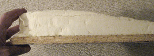

Density. I’ve inspected enough foam to be able to tell whether it’s approximately the right density simply by pressing it with my thumb. But when I’m in doubt, I take a sample and test it. For 2-pound foam, the density should be between 15 and 25 psi; for 1/2-pound foam it should be between 2 and 5 psi. Anything softer or harder is an indication of an off-ratio or poor mix.

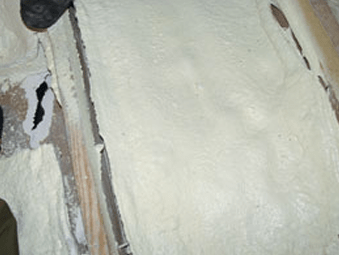

Adhesion. Adhesion problems on closed-cell foam can usually be found by randomly pounding the foam. Delaminated foam will have a hollow sound and compress slightly.
When I find a suspicious area, I use a coring tool, a saw, or a knife to take a sample. If the sample is hard to remove and leaves little bits of foam on the substrate (the industry term is “cohesive foam failure”) there is no adhesion problem. Another acceptable result is when the sample comes away from the substrate with some force but is clean; this is called a mechanical bond. But if the sample is easily removed from the substrate, I know that the adhesion is poor and the affected area must be removed, since poorly adhered foam can lead to blisters, delamination, and shrinkage of the foam — all of which will affect the foam’s insulating, air-sealing, and condensation-control qualities.

Usually, cracking and other problems in a foam installation affect only small areas, and repairs can be made without a total tearout of the existing insulation. Unless the whole application is off-ratio, most repairs require the removal of 5 percent to 15 percent of the existing foam.
After the off-spec foam has been identified, it should be cut back at a 45-degree angle to where it exhibits good adhesion and good physical properties. After the substrate has been cleaned and — if necessary — reprimed, the area can be resprayed.
