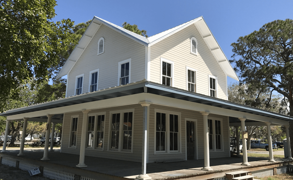

19th century house in Sarasota County, Fla., with generous overhangs.
Frank Woeste
Decay, or wood rot, requires three conditions to be present: liquid water, oxygen, and a favorable temperature (generally between 35 and 100 degrees F). Of the three, the only factor that can be managed by building design is liquid water. Hence, overhangs of sufficient width are critical to protecting modern wood-based materials used in wood-frame house construction.
As this 1896 home from Sarasota County, Fla., shows, house designers understood the basics of protecting wood siding, wood framing, and wooden windows by using roof overhangs to shed rain water. Note, for instance, how the runoff from the roof is concentrated at the corners, thus away from the all-wood windows that benefit by the protection from roof water.
Being that wooden buildings around the world have survived for centuries by utilizing pronounced overhangs and knowing water is the driving force of wood decay, we consider overhangs to be a “common sense” design approach for protecting and extending the life of wood and wood products used in one- and two-story wood construction.

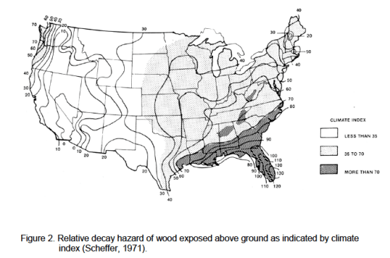

Rainwater provides the most significant source of excessive moisture to exterior woodwork. Gravity flow and capillarity of rainwater create the potential for increasing the moisture content to dangerous levels, possibly leading to decay. How much water from rain accumulates on exterior wood and wood products depends on the amount, frequency, and type of rainfall, as well as the amount of wind during rainfalls. Studying the interactions of these factors has led to the development of guidelines by which builders and designers of structures, particularly residential, can reduce the risk of deterioration to exterior woodwork.
In 1971, T.C. Scheffer developed a formula based on U. S. Weather Bureau summaries to determine an index of decay potential for above ground wooden structures depending on location within the United States.
This formula integrated experimentally obtained growth and decay rates for rot inducing organisms, monthly rainfall duration and quantity, and monthly temperature measurements into yearly indexes for three diverse climatic regions:
Climate Index Map
In general, the larger the index for a given location, the more potential there is for decay propagation and the more protection that is needed for exterior woodwork to remain unharmed. The map clearly suggests that the extent of protection needed in different climatic locations is extremely variable from coast to coast—the decay hazard index varies from 0 to 130.

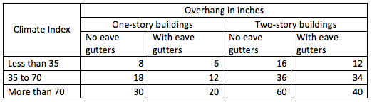

In addition to proper flashing around windows, doors, and openings, an effective method for avoiding the wetting of exterior woodwork is to provide adequate overhangs in order to keep rain from soaking into and splashing onto the wood. Here’s a table with recommendations for appropriate lengths of overhangs, based on three ranges of the Climate Index, eave gutters, and stories:
Climate Index matrix
Woeste and Loferski
When this table first was published in 1980, it only gave roof overhang widths for one-story buildings. We expanded the table to cover two-story buildings based on the assumption that the overhang width-to-wall-height ratio that adequately protects a one-story building will also protect a two-story building.
Since eave gutters provide additional protection against wetting from rainwater, using them makes it possible to reduce overhang lengths. Gutters should be incorporated into the roofs of wood buildings to help direct water away from the foundations as well as the building envelope. It is important to note that gutters must be maintained to provide the needed protection from rainwater—overflowing gutters could actually exacerbate the problem due to splash.

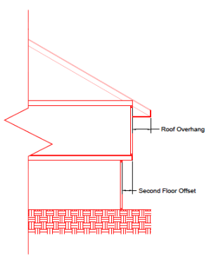

At first glance, the overhang (total) widths of 40 and 60 inches for two-story buildings might seem too long to be of practical use, especially in high-wind areas. For the case of an excessively wide overhang, designers and builders have an opportunity to exercise architectural creativity in employing these durability design recommendations. One option for two-story structures is to offset the second story, as shown below, in order to help meet the roof overhang width requirement needed for protection against water exposure. Here is an example from Dr. David Carradine, now at the Building Research Association of New Zealand, Inc. (BRANZ):
Drawing of a roof overhang and floor offset
Courtesy of David M. Carradine (BRANZ)
Roof overhang and floor offset used i combination to meet a recommended overhang width for a two-story building.
