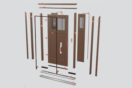

Anatomy of a complete door system
  1. Fiberglass door panel delivers years of low-maintenance durability. Unlike wood, fiberglass won’t warp or rot. Unlike steel, it will not dent or rust.
  2. Glass should balance the amount of privacy and natural light homeowners prefer. Options with triple-pane construction will provide thermal efficiency and an easy-to-clean surface.
  3. Multi-point locking system engages the door and frame at three points from top to bottom for enhanced sealing and security, even under wind pressure.
  4. Hinges position the door to properly compress the weatherstrip, helping form a tight, even seal against air and moisture infiltration when the door closes.
  5. Sills provide a solid stepping surface and form a tight seal at the bottom of the door system to help channel moisture away from the home.
  6. A sill pan gathers leak water and drains it away from the structure, adding an extra layer of protection to help keep water away from the floor system.
  7. Corner seal pads (inswing only) fit securely behind the weatherstrip to help block potential pathways where wind-driven water can infiltrate the bottom corner of the door system.
  8. Bottom sweeps (inswing only) feature a dual-bulb, dual-fin design to help maintain tight contact with adjustable sill caps and create added barriers against water and air.
  9. Weatherstrip helps deliver a precise seal between the door and frame. Look for a variety of profiles to provide the best possible fit with the door system.
  10. Composite door frame provides a rot-free solution that delivers extra protection from the damaging effects of moisture.
