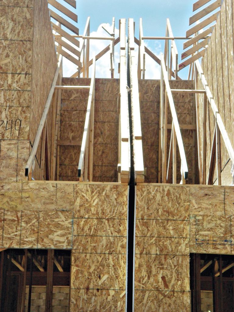

When there is separate ownership on separate lots, such as with a townhouse or a duplex, you will have to provide a two-hour fire barrier and a structural occupancy separation. The latter consists of two unconnected structural support walls along the common boundary, so that — theoretically — if one half of the building collapsed, the other half would remain intact. This wall assembly typically consists of two one-hour walls built side by side without plumbing or ductwork, with a 1-inch space in between. Furthermore, under certain circumstances, you are required to build a parapet or install fire-resistant roof sheathing extending 5 feet on either side of the property line. These requirements make townhouse construction inherently expensive.
