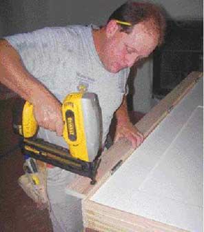

DeWalt DC618 16-Gauge Angled Finish Nailer
Weight: 8 1/2 pounds
Length and height: 13 1/2 inches and 12 1/2 inches, respectively
Nail capacity: 1 1/4 to 2 1/2 inches; 16-gauge
Magazine: Rear load; 120-nail capacity
Power source: 18-volt nicad battery (two included)
Case: Blow-molded plastic
Street price: $399 ($300 without batteries)
DeWalt • 800/433-9258 • www.dewalt.com
DeWalt’s depth adjustment is a little hard to see on the right side of the housing, but its numeric markings make it easy to reproduce a previous setting.
Testers’ Comments
DeWalt has only recently entered into the nail-gun arena, and this nailer is its first attempt at a compressor-free tool. We think the company’s done quite well. The balance and feel are good, and the 20-degree magazine is easy to load.
Rubberized panels on the handle improve grip. The gun also has twin headlights that illuminate the workpiece when the trigger is pulled. You shift from sequential to bump modes by flipping a switch; depth adjustment is handled with a six-position thumb-wheel on the right side of the housing.
Gripes
As much as we liked this nailer, it is one big, hefty gun: It will pull on your belt so hard you may have to cinch up another notch just to keep your pants on. It also has a wide housing, so we hit more than one door opening while wearing it on our waists.
In bump mode, we found we could move so fast that the gun would occasionally fail to set a nail, but slowing down a bit took care of the problem. This gun is certainly capable of nailing crown molding, but its weight makes this task more tiring.
