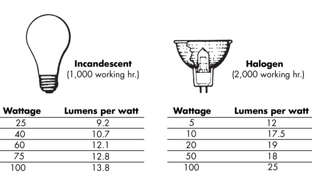

Halogen lamps. Halogen fixtures accept PAR “R” lamps, or the smaller MR16 lamps. Par lamps are a good choice in recessed kitchen fixtures. The MR16 are popular in pendant and track fixtures for task and accent lighting throughout the house. The many design options, and the crisp, white light of all halogen lamps allow for dramatic lighting effects that are unmatched by other lamps. Slightly smaller MR11 lamps that plug into undercabinet light strips are also available.
Typical tungsten halogen lamps are 50% brighter per watt than incandescent lamps, and they last about twice as long as incandescent bulbs (below).
Halogen lamps are more expensive to buy than incandescent bulbs, but the higher initial cost is balanced by lower wattage, stronger light, and longer life. Line-voltage PAR30 halogen lamps use power up to 30% more efficiently than standard incandescents and are well suited for use in track lighting and recessed cans.

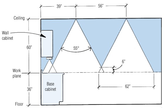

Task areas are best lit with bright, continuous, or overlapping zones of light. Incorrectly placed task lighting can cause glare, especially when light from the ceiling hits a reflective surface, such as shiny fixtures or glossy paper.
Locating Task Lighting
Place task lighting so the beam falls across the work area from one or both sides of a person’s gaze. Avoid aiming the light straight on: The closer the beam falls in line with the direction of a person’s gaze, the more likely it will create glare.
Spread out the light sources so the beams overlap at the level of the work plane (below). The more evenly the light is spread, the more it will diminish glare and minimize stark shadows.
In this kitchen scenario, the ceiling lights have a beam spread of 55 degrees, which provides 62 in. of coverage at countertop height. The fixtures are installed 56 in. apart, producing a 6-in. overlap on the countertop. The first fixture has been shifted to the right to eliminate “scallops” on the wall cabinets, placing it 39 in. from the wall. Undercabinet lighting is used in conjunction with the task lighting over the countertop and the backsplash.

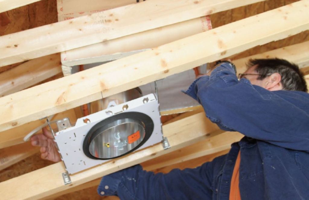

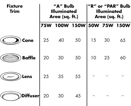

Recessed Fixtures
Some recessed fixtures, especially the high wattage ones, cannot be placed next to insulation. Unless the light is rated “IC” (insulated ceiling) or equivalent, all insulation must be removed from the area determined by the
requirements of that specific fixture.
Note: These coverage figures are based on providing 15 to 25 footcandles of light. Darker rooms require higher wattage, and spacing will vary with the distance from fixture to subject.

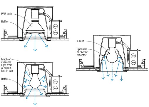

Match bulb to trim. Recessed fixtures typically accept PAR “R” lamps, as well as standard “A-lamp” incandescent bulbs. The trim, as well as the bulb, determines the light output of the fixture (above). Using the wrong bulb in a recessed fixture can result in ineffective, wasteful lighting. Advise clients about the correct bulbs to use with recessed fixtures (below).
Off-the-shelf recessed cans commonly come with a black or white baffle designed to be used with a PAR bulb (top left). A less expensive A-bulb will be ineffective with this trim (bottom left). For clients who plan to use A-bulbs, use a deep parabolic reflector (right), which directs most of the light out of the can.
Black step baffle trim absorbs about 50% of the light generated by the lamps, greatly reducing their efficiency. Black trim also contrasts with the typical white ceiling and draws the eye upward.
Instead, use white trim, mirrored Alzak, or clear specular reflectors. White trim still absorbs about 30% of the light, while Alzak allows virtually all the light to exit the can. Also, the mirrored surface reflects the color of the ceiling, causing it to “disappear” better than white trim.

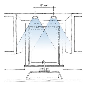

Sink Lighting
Undercabinet lighting will not work above a sink unless there is a shelf at upper cabinet height. Above a sink with a window above it, use a pair of adjustable ceiling fixtures, arranged so the beams cross the sink area to reduce glare (below).
To avoid glare, aim fixtures so the beams cross each other.

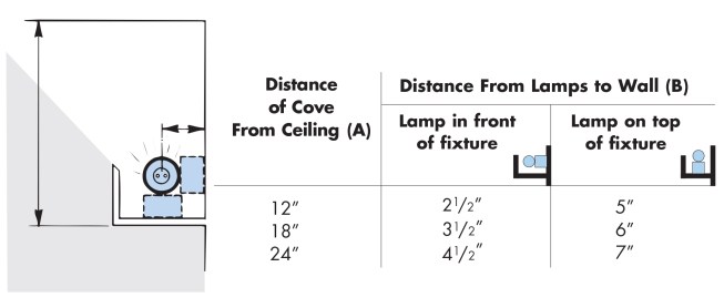

Cove Lighting
Cove lighting is installed near the ceiling, behind a cornice or ledge. Suitable fixtures include strip lights with miniature incandescent or xenon lamps, compact fluorescents, or standard-length fluorescent tubes.
For cove lighting, plan on using either xenon or fluorescent lamps, between 20 to 30 watts per foot for either type. Place the lamps behind the cove as shown in the figure below.
Cove lighting should be mounted above eye level but at least 12 in. below the ceiling. This chart shows the minimum recommended dimensions to achieve uniform brightness.
If a room has a 9-ft. ceiling, cove lighting can be installed between 12 and 24 in. down from the ceiling. In a room with an 8-ft. ceiling, cove lighting is typically installed 12 in. down. (Note: This may leave the center of some rooms rather dark; the solution here is to include an indirect pendant fixture in the center of the ceiling.)
