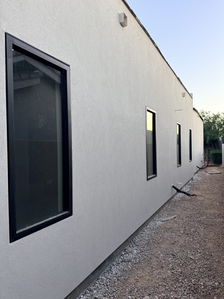

I recently learned about a new stucco substrate by HydroBlok (out of Draper, Utah) when Betsy Olson, a friend, neighbor, and owner of 3D Construction, LLC, here in Scottsdale, Ariz., used it when building her own home. Betsy noted that even the scratch coat—typically just a functional base layer—looked like a finished product. When exterior temps hit over 100°F, the interior remained at 72°F with no HVAC running, even with the garage door still open. The house became, in her words, “deafeningly quiet.” Having recently built my home in the same neighborhood using a drainable lath for the stucco assembly, I was immediately impressed by the speed of installation and by the incredibly flat, almost flawless execution of her stucco exterior.
Compared to conventional stucco systems, HydroBlok’s system affords faster installation and a smoother finish.

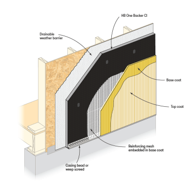

Hydroblok’s website (hydroblok.com) describes the new product as: “A water-resistance exterior backer board designed as a cement board and EIFS alternative for stucco applications.” The manufacturer took its existing tile substrate, HydroBlok Shower Systems, and evolved that product into a substrate for exterior stucco that they’ve named HydroBlok One Backer CI. As the name implies, it also functions as exterior continuous insulation (CI). As a substrate, the product eliminates the need for a chicken-wire or metal lath, so it can be installed super flat, and just as important, makes it easier to achieve a uniform thickness. The cementitious coating on the panels essentially serves as a scratch coat on which a polymer-modified base coat can be applied directly, followed by a top coat with an acrylic stucco finish. It will soon be approved for use with veneer manufactured stone.
Backer CI combines four components into a single board: secondary WRB, continuous insulation, lath, and scratch coat. Fewer layers is always an advantage. Anytime you can eliminate layers, you eliminate potential mistakes and increase overall building performance.
The panels are made with a very dense extruded polystyrene foam insulation (available for CI applications in 1-, 1 1/2-, and 2-inch thicknesses at R-5, R-7.5 and R-10, respectively) that resists impact (a big plus in our neighborhood, which faces a golf course) and avoids the use of water-absorbing EPS foam. The foam is faced on both sides with a fiberglass mesh embedded in a cementitious coating, which lends the board incredible strength and serves as the bonding coat. The panels are also light; a 1-inch-thick 4×8 sheet weighs 28 pounds.

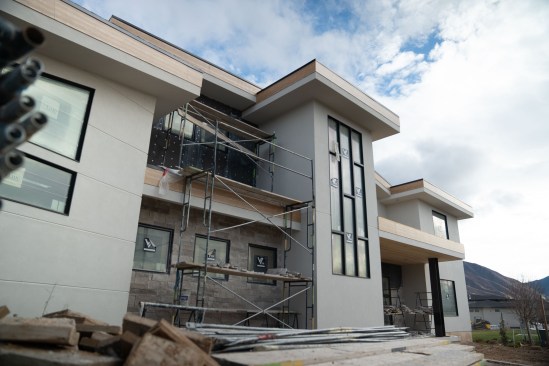

Nevertheless, interest in stucco has slowly grown in regions where it wasn’t common in the past, due in part to shifting interest in new architectural styles. Over the last decade, the popularity of modern and contemporary home styles, which favor monolithic and minimalist exteriors, has grown steadily in all regions.
The popularity of modern home styles, which favor monolithic and minimalist exteriors, has pushed the growth of stucco in all regions of the country over the last decade.

Backer CI is not a structural sheathing. According to the ICC Evaluation Services Report (ESR), it must be installed over a minimum 15⁄32-inch-thick Exposure-1-rated sheathing, or a minimum 5/8-inch exterior gypsum sheathing. Panels must be fastened through the sheathing into framing with #8 galvanized screws a minimum 1 5/8 inch long (and 0.164 inch diameter) and 1¼-inch-diameter galvanized washers every 16 inches on-center along panel edges and in the field. The ESR for stucco applications (see illustration above) also specifies installing the panels over a drainable housewrap and specifically references Tyvek StuccoWrap.
