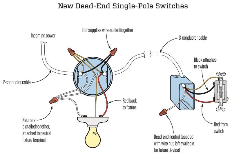

In the past, when a switch was placed after a device (such as a light) in a circuit, the white conductor was re-identified and used as the hot wire. But now, for a single-pole switch, a three-wire cable (with ground) is required between the light and the switch.
In the device box at the light, the black conductors from the supply and the three-wire are connected together so that the power skips the light and heads to the switch. The neutral (white) is pigtailed to the neutral terminal on the light and connected to the white conductor in the three-wire (see Single-Pole Switch).
At the switch box, the black and red conductors of the three-wire connect to the switch, and the red then sends the switched power back to the device box where it is attached to the other light terminal. The white neutral in the switch box is capped with a wire nut, leaving it available if needed.
The wiring arrangement for three-way (and four-way) switches is similar (see illustrations), but you will need a four-wire (or five-wire) cable in these cases to keep the neutral path continuous throughout the entire switching arrangement. Most often, this requirement is primarily “future-proofing” in case a motion detector or some switching device that we can’t even conceive of yet is added. When it’s not needed, the lonely neutral conductor is terminated with a wire nut and left waiting to be called on in the future. Someday someone will probably be very happy to find it there.
