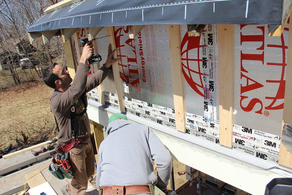

A look at the mostly furred-out wall shows the key durability details of the rain screen system: the foil drainage plane sealed with tape, the furring which creates an air space for drainage and ventilation, and the flashing and bug barrier at the bottom which will allow inflow of air into the cavity, equalizing air pressure across the siding and permitting incidental water to drain out of the assembly.
