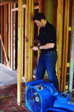

Drying the framing helps with a range of cosmetic issues—not only drywall pops, but also cracks in drywall around window heads, squeaks in floors and stairs, interior trim joints that open up, and caulking that pulls and cracks.
Fast construction schedules accelerate those problems, because the house framing barely has any time to dry on its own before the next stage of construction begins. Such “short cycle” houses are notorious for having a large number of drywall cracks and other cosmetic defects after a year of heating and cooling by the occupants.
The problems are commonly attributed to “settling,” but builder Matt Risinger, of Austin, Texas, says the more likely cause is wood movement produced by the frame drying. Before hanging drywall, he lowers the framing’s moisture content to 12% or so (checking with a moisture meter), using fans (see “Drying Wet Framing,” by Matt Risinger, Jun/13).

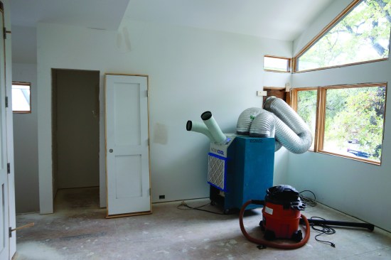

After the drywall is taped, Risinger employs a series of industrial dehumidifiers to absorb moisture from the curing mud (as well as from the slab and other materials used in the house) before installing woodwork (see “Conditioning Homes,” by Matt Risinger, Nov/15). On some projects, he has also taken to setting up a full-size space conditioning system outside the building and running duct indoors to condition the home during the final stages of construction.
Curing drywall mud and slab foundations can pump moisture into an enclosed interior. Risinger reduces this moisture by using industrial dehumidifiers.
He also has installed temporary HVAC systems during construction.

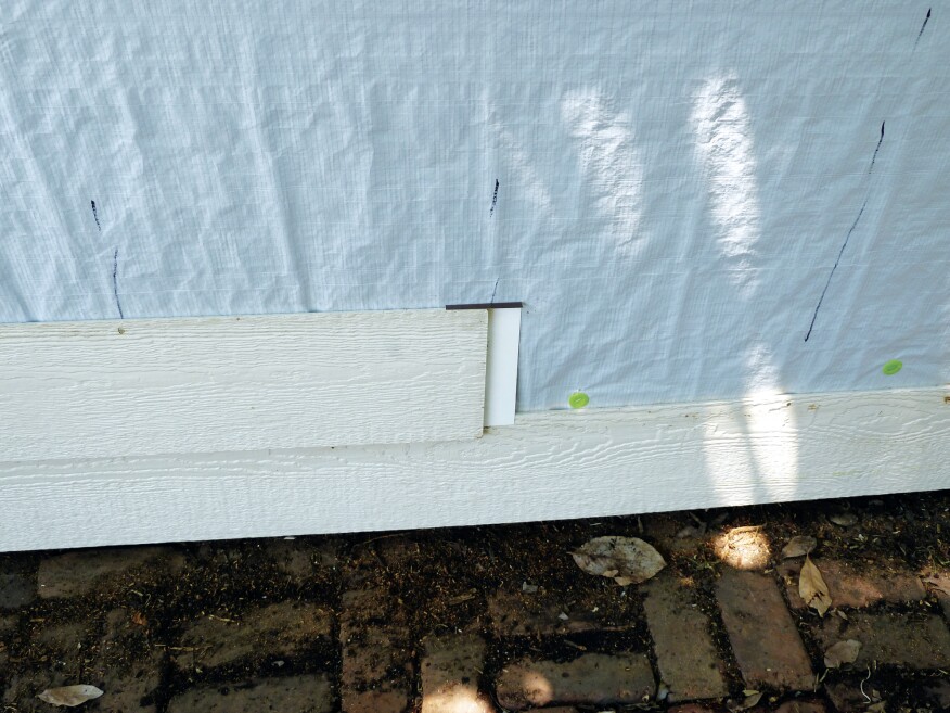

Wet sheathing may swell at the edges. When the sheathing dries, the edges may still not return to their original size and ridges telegraph through roofing. Photo: Steve Easley
Exterior sheathing can buckle when it dries. Plywood, OSB and fiber board are all affected, and the defect telegraphs to the siding. Photo: Steve Easley

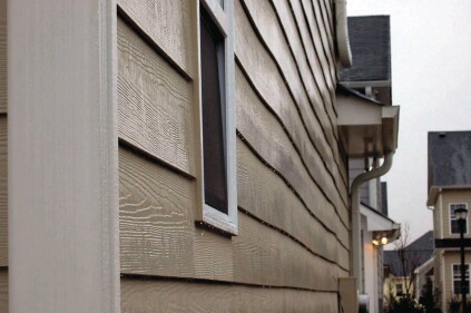

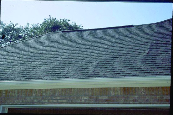

Roof and Sidewall Ripples
Another common problem is sheathing that swells and buckles, telegraphing waves through the cladding or roofing. The fix is simple: Leave a 1/8-inch gap between panels. The shank of a 10d common will make the proper space over rafters and studs, though you may want to use H-clips over rafter bays. But some framers seem unaware of this advice. “I hired two guys to help me frame an addition and neither one had heard of gapping sheathing panels,” notes Leavenworth, Kansas–based builder and remodeler Chip Kiper. He says he now inspects the sheathing before it’s covered: “If any sheets aren’t gapped, I use a saw to make a kerf between them.”
Fiber-cement and some engineered-wood sidings can swell at butt joints. Follow manufacturer instructions, as installation procedures vary by siding brand. Some may want butt joints caulked, while others may prefer use of joint flashing. Photo: Greg Burnet
Swelling can also be a problem with fiber-cement siding, where joints between horizontal runs may need to be gapped and filled with sealant. Be sure to check the manufacturer’s installation instructions, as the requirements vary. Those that require caulking at joints do so for good reason. “If you ignore this advice, the board will soak up water and swell at the edges,” says Bill Robinson of train2build.com.

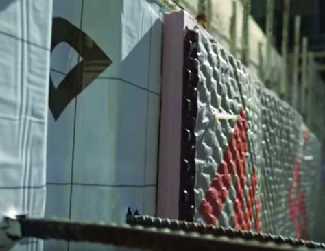

An effective way to keep basements dry is to provide a gap between the ground soil and the foundation wall. A dimple mat covered by a filter fabric is one good way to create this space. Photo: Risinger & Co.
This product requires a primer that helps bond the adhesive backing to the concrete. “Essentially you’re sticking an adhesive to an adhesive, which creates a very durable bond,” he says. Regardless of the waterproofing used, the most important ingredient is a gap between the foundation wall and the surrounding soil to relieve hydrostatic pressure. Without a gap, hydrostatic pressure can force an enormous amount of water through even the smallest penetrations in the wall. Risinger typically relies on a dimple mat covered by a geotechnical fabric to create this gap and allow free drainage to the footing perimeter drains.

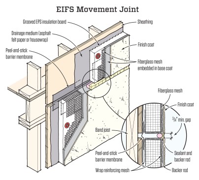

Missing joints. The ASTM standards that govern stucco specify control joints every 144 square feet. They often get left out, however, because of ambiguity in how some stucco systems implement these standards, and because some builders don’t like the look of control joints.
The EPS board in an EIFS system can buckle when floor framing shrinks, causing cracks in the surface, unless a movement joint is located at or above the midline of the band joist.
Tim Healey

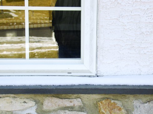

Some installers also forget to put a flexible sealant where the stucco meets another material, such as around a window. The result is the same in both cases: When the stucco expands or contracts, it cracks, letting water into the structure.

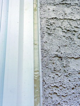

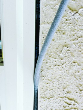

If stucco is brought tight to window and doors, it tends to crack over time as the window  and trim expands and contracts, opening an entry point for water. Photo: Dave Haines
The stucco bead should be installed to provide a gap that can be filled with backer rod.
The gap is then filled with caulk to create a lasting seal.  Photos: Dave Haines

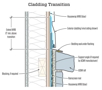

The solution? As a first step, builders need to take care when hiring siding subs. They also need to write tighter specs and make sure the job super or lead carpenter is on site. “We advise more site supervision on the days stucco is being installed,” Richard Baker says.
This illustration shows the correct way to detail the transition between dissimilar cladding types.  A flashing must be installed to kick the water out before the transition is made.
Tim Healey

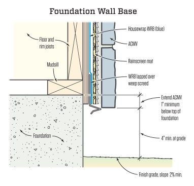

Both stucco and adhered concrete veneer (ACMV) must terminate with a weep screed to kick the water out at the base of walls.
Tim Healey

With exterior flashings, the most problematic spots are where brick or stone veneer meets another type of siding and where a roof dies into a sidewall.
“At least in my market, a lot of them don’t understand how their trade relates to the other trades,” Jim Schneider, a custom builder in Norfolk, Va., says. He has responded by providing scopes of work that detail exactly how the flashings have to be done and by making sure his job supervisor is on site to check the work.

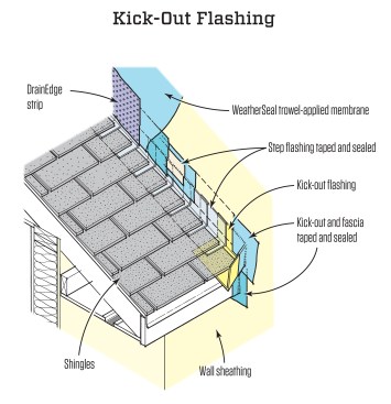

Where a roof meets a wall, the roofer will often neglect to install kick-out flashing. The kick out is a bent piece of metal at the base of a step-flashing run that directs water into the gutter. When it’s missing, water can run down the wall below the gutter, working its way behind the siding and rotting the sheathing.
If not detailed correctly, a roof-to-wall intersection can dump a lot of water into a wall. Step flashing should terminate at a kick out that’s large enough to direct water away from the wall.
Tim Healey
Some architects and homeowners don’t like the look of kick outs. An alternative (suggested by Bill Rose, author of “Water in Buildings: An Architect’s Guide to Moisture and Mold”) is to nail a pressure-treated 2×4 at the roof-wall intersection before installing roofing or siding. Then bend the step flashing over the 2-by and down onto the roof. This puts the flashing outboard from the cladding and directs water straight into the gutter.

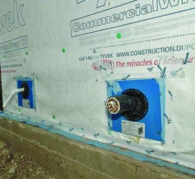

Penetration Detailing
Installers have gotten better in recent years when it comes to window flashing. The one exception is the sill pan. “All exterior doors and windows need a sill pan but contractors in general aren’t using them,” Robinson says. “That’s fine if everything else is perfect, but it rarely is.”
Barker says that aluminum windows especially need a pan because installers can rack them during installation, breaking the seal at the bottom corners. “The IRC doesn’t require pan flashing on windows unless the window manufacturer does, and window manufacturers often don’t,” he says. By the time the homeowner sees a stain on the wall, there is already rot in the structure.

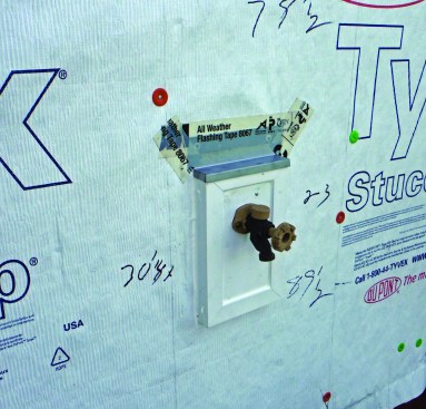

Detail through-wall penetrations with a standoff block. Ideally the block should be flashed and the cap flashing integrated into the weather barrier, as shown here.
An alternative is to use a flashing panel, such as those made by Quickflash. This type of flashing product still needs to integrated so the weather barrier drains over the flashing panel. Photos: Risinger & Co.
Leaky pipe and vent penetrations are also common. When installers cut a hole for a gas line or dryer vent, they need to flash it to the WRB. But they seldom do. “I see this done incorrectly all the time,” says Robinson. He says that the problem won’t be fixed until installers start taking wall penetrations as seriously as roof penetrations. He also recommends prefabricated boots like those made by QuickFlash.
He adds that the only caulks and sealants used around penetrations should be those with a high solid content. Silicone or polyurethane typically work best. As caulk cures, it shrinks down to its solid content, and if there’s not enough, you get gaps, Robinson explains.

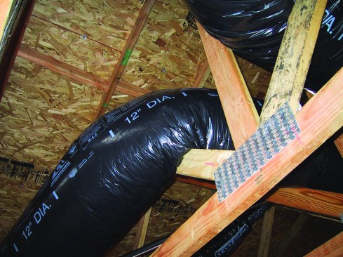

Comfort complaints are rampant according to our sources, and the fault often lies with the ductwork. “A lot of residential ducts have excessively high static pressures,” says Jose de la Portilla, a technical training manager with HVAC Learning Solutions, in the Dallas-Ft. Worth area. “The mechanical equipment has to run longer and has to start and stop more often, making it more prone to breakdown and premature failure.”
A pinched HVAC duct creates high static pressures that stress equipment and reduce airflow. Photo: Steve Easley
The causes behind excessive pressures range from undersized ducts, to excessive bends, to sagging flex duct. Some installers suggest using rigid fittings for elbows and other directional changes, then stretching runs of flex duct taut between them. Many homes also have inadequate return paths that rely on door undercuts, leaving some rooms too hot and others too cold. The best way to avoid these problems is consult with the mechanical contractor during the design phase.

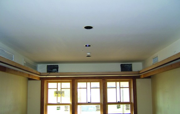

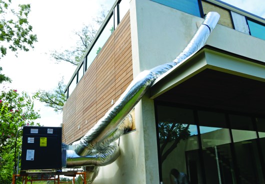

To reduce duct leakage to the outside, run ductwork inside conditioned space, through ceilings or (as shown here) through interior soffits. Photo: Clayton DeKorne
Another comfort killer is ducts that are run in unconditioned spaces without being properly insulated or sealed. An unsealed supply duct in an unconditioned space can waste as much as 500 cubic feet of air per minute, or more than a ton of heating or cooling capacity; leaky return ducts can pull hot or cold outside air into the system.

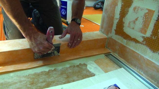

Custom Showers

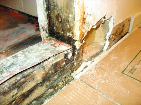

Upgraded master baths with custom showers that feature built-in seats and multiple showerheads are a hot option among well-heeled homeowners. They tend to be on the second floor above a living space, so leak-proofing is crucial. But if, as is often the case, the seat is built into a corner, or the shower has an L-shape, the waterproofing membrane can be hard to detail correctly.
Shower curbs are typically framed with wood, which shrinks and expands with changes in humidity, putting stress on grout lines and often causing them to crack.  Photo: Doug Horgan
Baker is seeing more such installations than ever with pinhole leaks that are hard to detect but that let mold and rot slowly build up in framing cavities. “Complex showers need a higher level of waterproofing,” he cautions. For instance, while the membranes beneath most showers aren’t sloped, it’s worth the effort to slope the underlayment in the shower toward the drain before applying the membrane.
Components from Schluter simplify getting the details right. Photo: Ted Cushman
