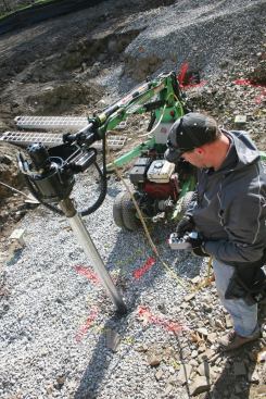

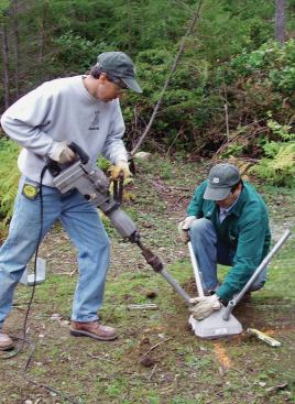

Engineered alternatives. For problem soils, steep slopes, or sites with difficult access, or where environmental or other conditions preclude excavation, several engineered alternatives to conventional concrete footings and piers are available:
Hydraulically driven helical piles
(photo above) are typically
installed by subcontractors who use torque readings to achieve the required
bearing capacity in a variety of soils. (For more information, see Working with
Helical Piles)
Hydraulically driven helical piles (photo above) are typically installed by subcontractors who use torque readings to achieve the required bearing capacity in a variety of soils. (For more information, see Working with Helical Piles)
Precast pin footings (photo, above) bear on steel pipes driven using
a hammer drill through sleeves in the piers to a depth determined by the
frostline. &nbsp;(For more information on pin
footings, see Slideshow: On Site with Diamond Pier)
Precast pin footings (photo, above) bear on steel pipes driven using a hammer drill through sleeves in the piers to a depth determined by the frostline.  (For more information on pin footings, see Slideshow: On Site with Diamond Pier)
Call 811 before you dig. Whether you plan to dig holes for footings or use an engineered pier system, take the precaution of calling ahead to determine the existence and location of any underground services in the project area. In most of the U.S., simply call 811 at least three days before digging (in Canada, each province has a separate phone number for information).

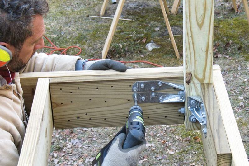

Post-to-Beam Connections
Mike Guertin

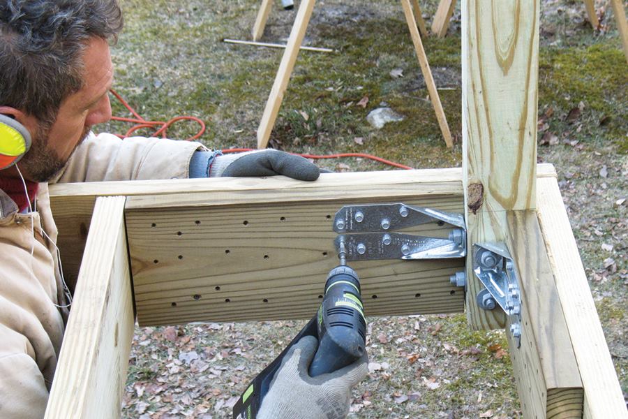

Horizontal deck beams should rest directly on top of posts. Avoid hanging beams from the sides of posts; over time, deck loads can overstress the bolts or lags.
Mike Guertin
Many types of metal brackets and connectors are available to reinforce beam-to-post connections against lateral and uplift forces. However, many builders prefer to notch post tops to let-in beams, then fasten them to the posts with structural screws or bolts. This method not only reinforces post-beam connections against lateral and uplift forces but also may be more visually appealing.

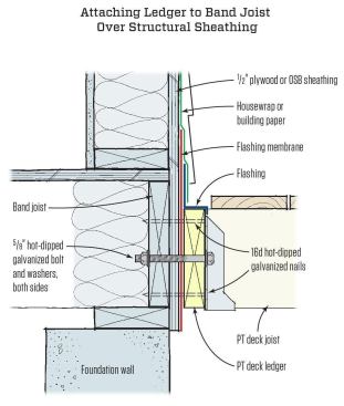

Deck Ledgers
When decks are connected to the building, as they typically are, improper sizing, fastening and bracing of a ledger board is the single biggest cause of deck failures.  The connection must support the vertical load (see Fastening Ledgers below) and well as the lateral load (see Bracing Ledgers below).
Ledger material. Solid-sawn two-by, preservative-treated southern pine or hem-fir is typical for ledger boards. The ledger should be minimum 2x8 PT #2 grade lumber or other approved material, and at least the same thickness as the deck joists.

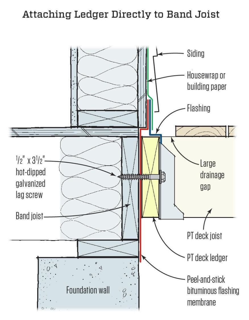

Fastening ledgers. Typically a ledger is fastened to the band joist directly or through sheathing, with either lag screws or bolts.
Notes: The tip of the lag screw should fully extend through the inside face of the band joist. The maximum gap between the face of the ledger and the face of the wall sheathing is 1/2 inch. Flash the ledger to prevent water from contacting the band joist. Stagger lags and bolts (see LOCATE illustration). Deck ledger should be minimum 2x8 PT #2 grade lumber or other approved material. When fastening solid-sawn PT ledgers to 1-inch-thick (min.) engineered rim joist, use an engineered attachment. Wood structural panels, gypsum boards, or rigid foam are permitted as sheathing; the maximum distance between the face of the ledger and the face of the band joist/rimboard is 1 inch.
Conventional connectors include minimum ½-inch lag screws (with washers) or through-bolts (washers on both sides of the connection). In addition, structural fasteners are available that meet or exceed the shear design values of 1/2-inch lags or bolts. These typically come either coated or in stainless steel, require no pre-drilling, and can be driven with an impact driver or a 1/2-inch drill at low speed. Manufacturers provide size and spacing charts that will meet code, depending on the materials used and the maximum joist span of the deck.
When fastening the ledger directly to the band
joist, the tip of the lag screw should fully extend through the inside face of
the band joist. Flash the ledger to prevent water from contacting the band
joist. Stagger lags and bolts.
When fastening the ledger directly to the band joist, the tip of the lag screw should fully extend through the inside face of the band joist. Flash the ledger to prevent water from contacting the band joist. Stagger lags and bolts.
Instead of lag screws, through-bolts can be used when fastening the
ledger directly to the rim joist as well.
Instead of lag screws, through-bolts can be used when fastening the ledger directly to the rim joist as well.

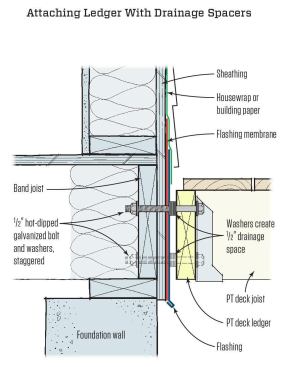

To promote drainage and reduce the risk of rot to the building and
deck structure, washers can be used to create a drainage space. A thicker
5/8-inch, hot-dipped galvanized or stainless steel bolt is need because of the
extra length. The maximum gap between the face
To promote drainage and reduce the risk of rot to the building and deck structure, washers can be used to create a drainage space. A thicker 5/8-inch, hot-dipped galvanized or stainless steel bolt is need because of the extra length. The maximum gap between the face of the ledger and the face of the wall sheathing is 1/2 inch.
The flashings shown in each of the section drawings above are critical to protect the structural members and fasteners from moisture. For more detail see Flashing Deck Ledgers.

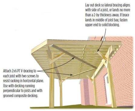

Bracing Ledgers. The details for fastening the ledger described above are designed to support the vertical loads – the weight of the deck and occupants on the deck bearing down on the ledger connection. In addition, the connection must also resist lateral loads to prevent the deck from pulling away from the building.
The 2012 IRC recommends using hold-down tension hardware in at least two locations to tie deck joists to floor joists of the primary structure. The illustrations below show suggested methods for bracing ledgers when the deck joists run either parallel to or perpendicular to solid-sawn or wood I-joist floor framing.
However, though-bolted hold-down hardware is not the only way to meet the requirements of the IRC. A variety of engineered and non-engineered lateral bracing solutions are also allowed. For more on alternative connections, see Lateral Bracing Alternatives.
Ledger Support. The ledger does not necessarily have to connect to the building’s frame. One alternative is to build a freestanding deck (below). For more on this option, see Building a Freestanding Deck.
Bracing Details: 2x6 V-bracing under the deck joists stiffens the deck in the horizontal plane.
With a freestanding deck, it is critical to anchor posts to piers to prevent uplift, and to brace all posts in both directions. To prevent racking of deck joists, use diagonal bracing fastened to the underside of the framing members.

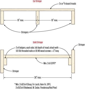

By code in most jurisdictions, a deck stairway must be at least 36 inches wide. This is also the maximum width of a stair built with closed stringers.
Regardless of the width, the stringer span is limited (see illustration below).
Figure: Stringer Span

At the bottom of the stair, stringers should rest on a footing (concrete pads or piers post footing) designed to resist a 40 psf live load and a 10 psf dead load.
Tread size. The new Southern Pine design values increase the minimum size for southern pine treads in solid stringers from 2x6 to 2x8 at a maximum of 36 inches wide. The maximum width of treads supported by a cut stringer is 36 inches.
