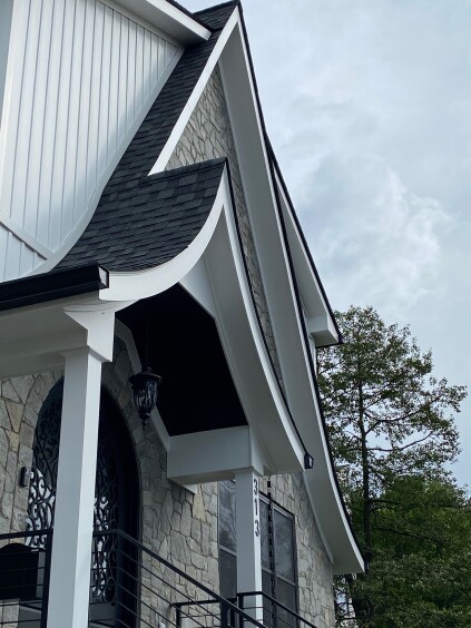

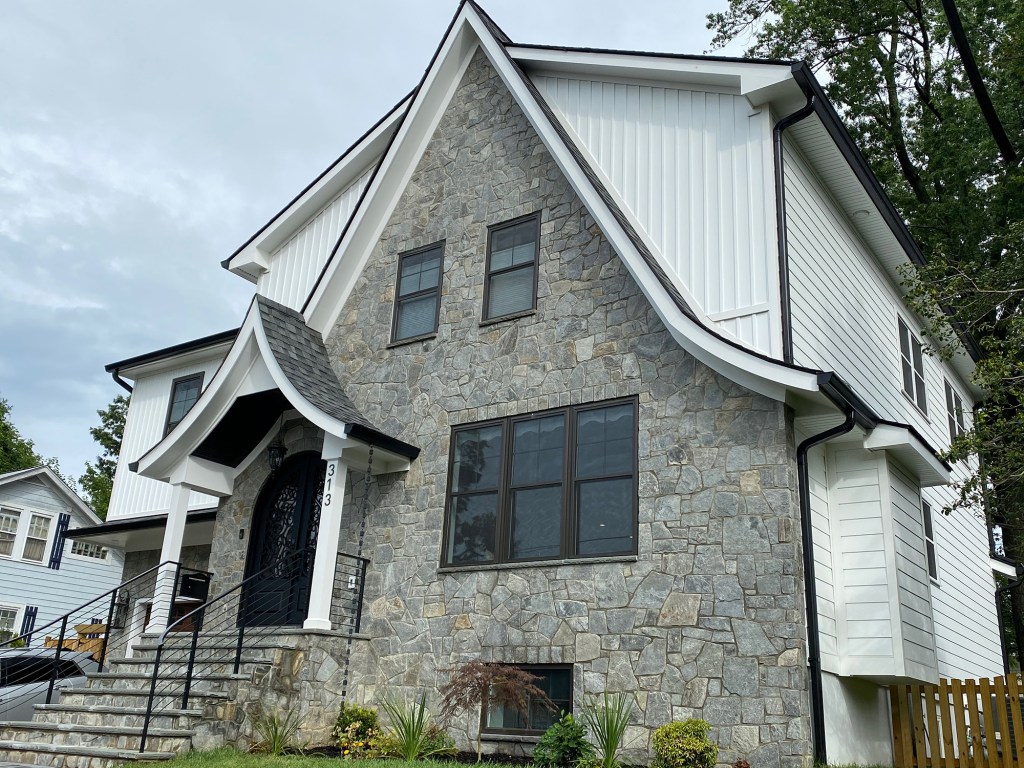

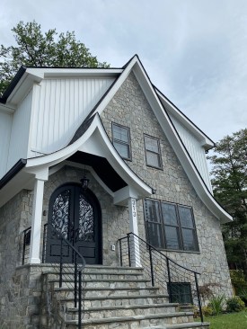

Take a tiny three-bedroom cottage he bought in partnership with another local remodeler, Ryan Rodger, owner, and CEO of Orion of Virginia, as a teardown. Nasr’s team built a new 3,830 SF, 5-bedroom/4.5-bathroom neighborhood showcase. The killer exterior feature is a pair of eye-catching, gently-curving trim applications.
“Ryan Rodger came up with the idea, a look he borrowed from his mom’s house. Our installer wanted to use sheet goods to piece the curve together,” Nasr recalls. “That would have left multiple seams. Thomas suggested a reduced seam heat-bending method using AZEK PVC trim.”
Thomas is Thomas Hartman, an area sales rep for AZEK, a leading trim and molding manufacturer. He suggested heat forming the trim in lengthy sections to minimize seams.

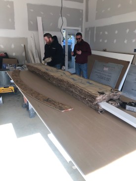

The team set-up “… on a very cold winter’s day in the home’s garage,” Hartman says. The key to the process is a heat forming kit:
  • 2 heat blankets (available in various widths and lengths)
  • 2 cement boards or rolled insulation (specifically during cold weather)
  • 1 infrared surface thermometer
  • 2 clamps
  • 1 form/jig that will shape the PVC
The process itself is straightforward, though an experienced trainer is recommended the first time:
  1. Create a wooden jig or template conforming exactly to the desired curve.
  2. Use the two heat blankets to soften a length of AZEK trim to about 300° F for seven to 10 minutes. The trim will have the consistency of cooked spaghetti.
  3. Gently place the softened trim in the wooden template.
  4. Clampdown. Let cool. The curved trim will hold its shape indefinitely.

“The curved trim helped me sell the home in a single day for $1.47 million. The owner and I will never have to worry about the trim,” Nasr explains. “We glued it and screwed it. A hurricane would blow the roof off before that trim would move. And, the owner absolutely loves the look.”
