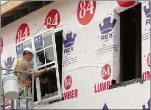

A carpenter installs a StormBreaker impact zone window on the New Jersey shore. While these windows are engineered to withstand the impact of flying debris without shattering, if not correctly installed, they can be blown out of the opening.
But how an IZ window performs depends as much on proper installation as on window construction, and installation details can vary by zone as well.
